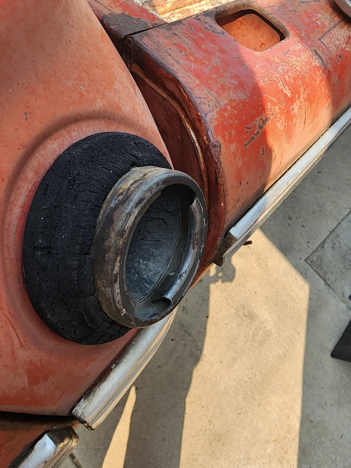

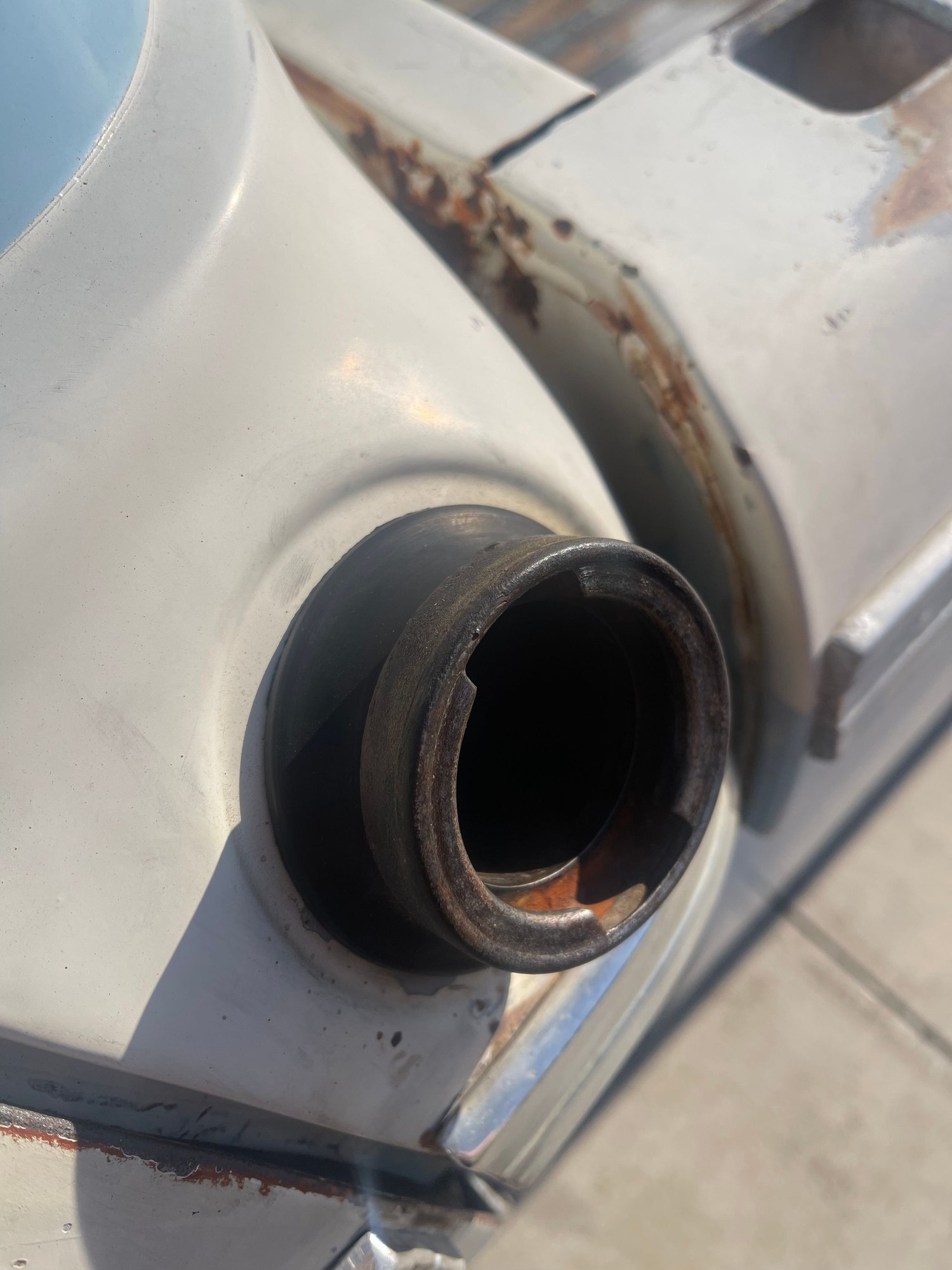

So, I bought one of the O'Reilly's parts that cpm_m4 listed and it didn't fit, either. I'm at a loss at to what frickin' gas cap will work for my rig. I'm attaching a couple of pictures of the fuel neck on my truck to see if anyone can perhaps identify what year this came off of. I'm tired of buying and buying these things.

That does not appear to be the correct filler neck. The PN for the originals was C1TZ-9034-A fits 61-66 F100/850. I do not believe these are repoped the 67-70"s are but there is something different about them. There are some used ones on E-bay.
On the original filler neck there is no step below where the cap goes on.

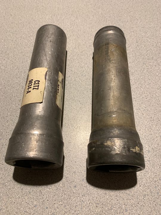

Here are some pics of mine which I believe to be original and fits the cap you purchased.

I have some NOS ones but they are slightly different than the stocks ones from a couple of my trucks. Still, the same cap fits these as the originals.

Here's a picture of an NOS one on the left and one from my 1966 F250 on the right. The taper is slightly different between them with the NOS one having a longer more gradual taper - and the one on the right has a flare at the bottom to help hold the hose and clamp.

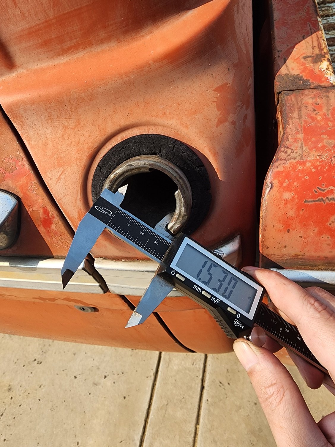

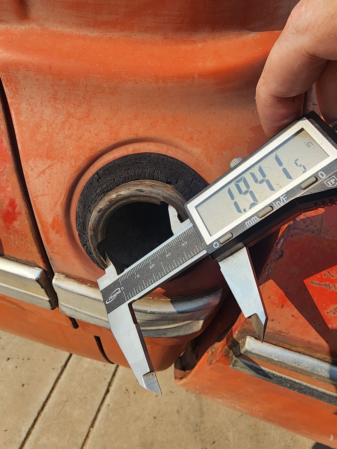

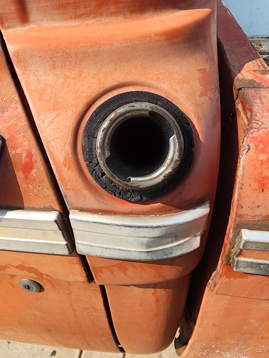

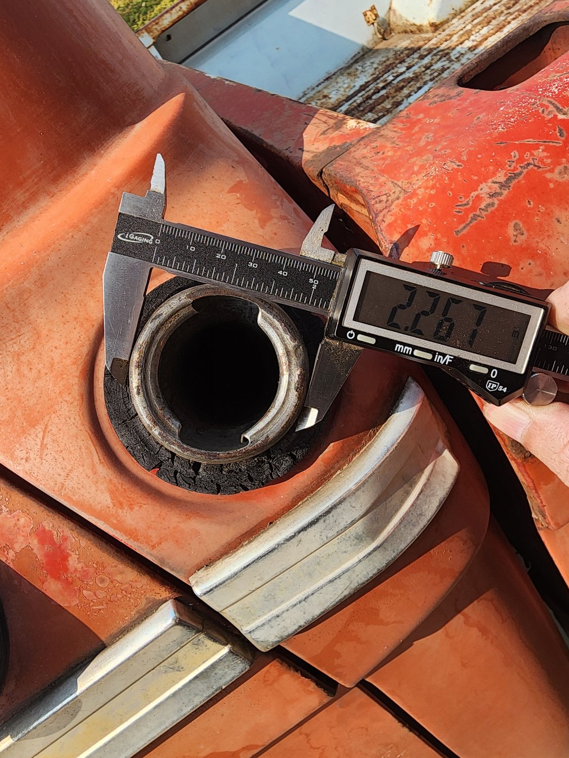

That's strange. When I first installed my cap is was a little tight. Almost too tight. You could try giving a bit of gusto. Not too much. Now it feels perfect. Here are some pics of the dimensions of my filler neck.

your filler neck looks different than the others we are seeing in this thread...maybe its from an equivalent chevy or other model and thats why the cap doesnt fit?

Well, unless TA455HO is in the mood to maybe sell me one of his NOS filler necks (I cannot yet PM you, sir), it looks as though I may need to look into getting one for a 67-70 truck to switch in for the one I have. I have no idea how to even go about figuring out which one I have, especially if it's from a GM or whatever. I'm at a bit of a loss on this one.
