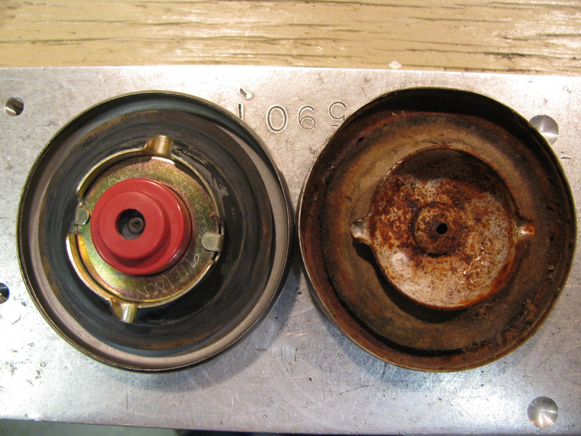

could someone show where to drill a hole if needed?
Old Sep 11, 2024 | 01:30 PM
Crop Duster's Avatar
Crop Duster
Joined: May 2015
Posts: 4,469
Likes: 965
From: Tri Cities, TN
Gas caps
The one on the right is an old, vented cap. The on the left is only vented into the tank not out. If your cap has machinery in it, then drill a 1/16 hole in the middle of the check valve.

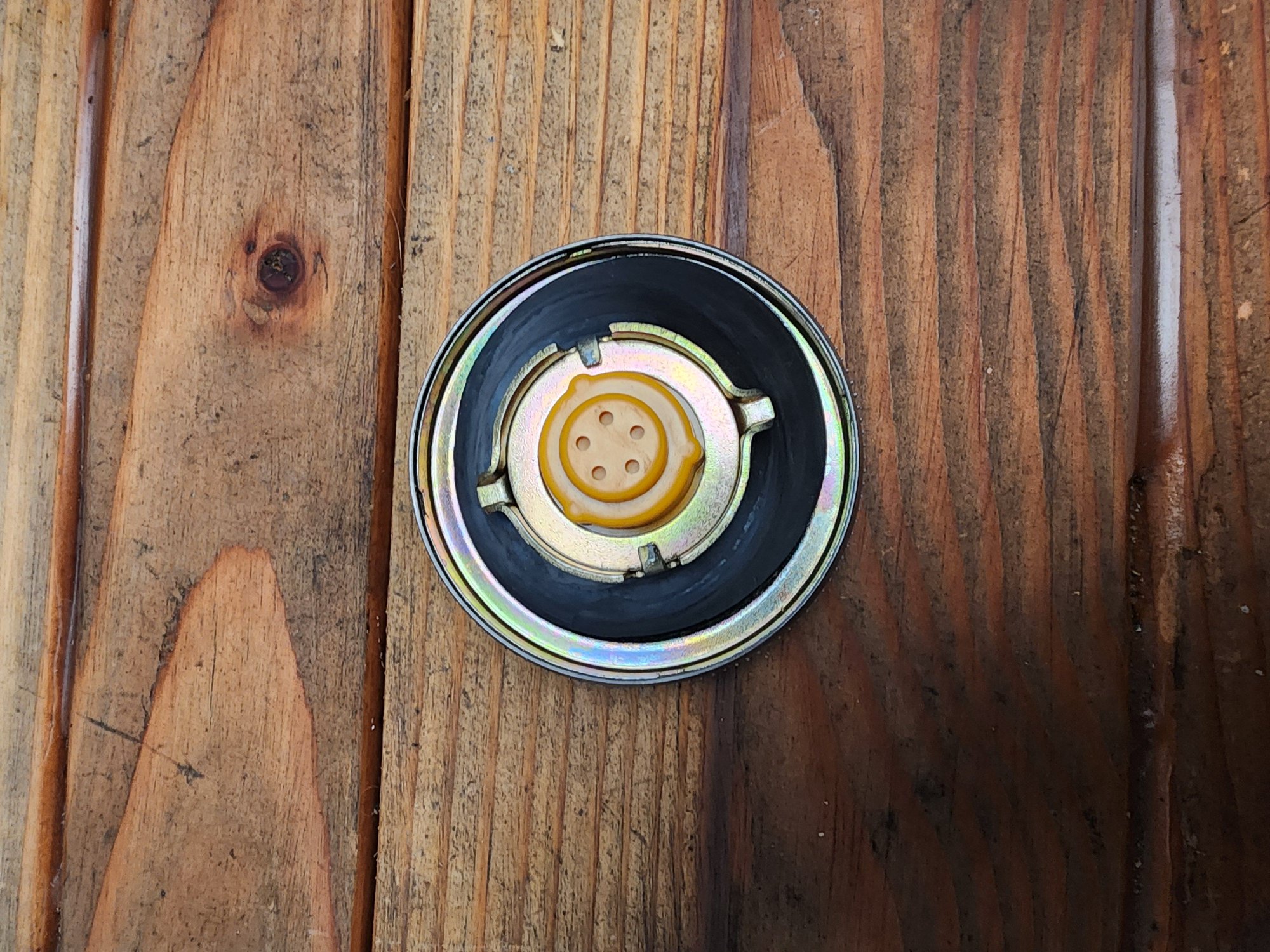

I confirmed the stant I got from orielly vents inward(sucked on it) and not outward. I'll leave it as it is unless I get fumes. I am not the OP. the check valve is some where in that yellow plastic thing. If I needed to drill it I would just throw holes straight down into the existing holes until it seamed like it was venting both ways. Man that gasket looks oblong.
