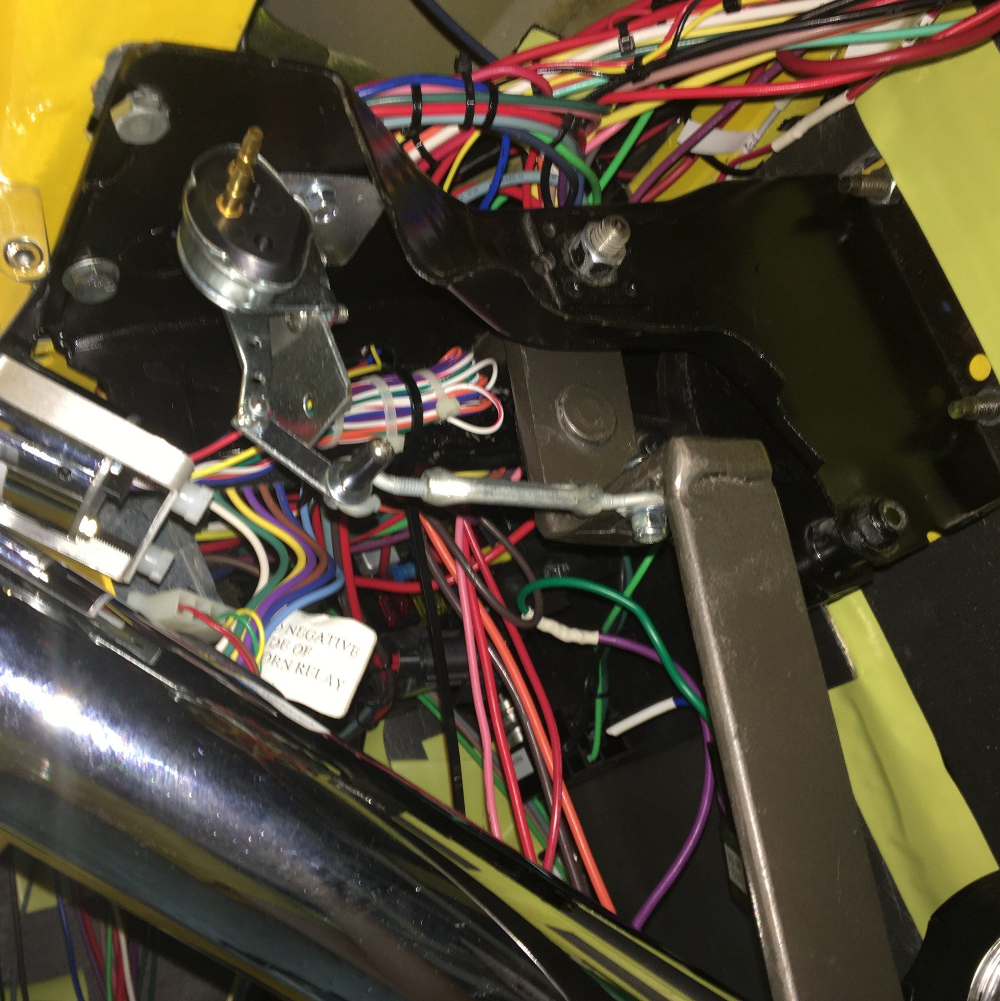

When I did my truck I tried three separate switches from three suppliers...they all leaked... I went with electric under the dash used turnbuckle too adjust the 'turn on' point on the switch

Was looking at that kind of switch but my concern is it's size..... what are the ballpark dimensions John?

I had one of those fluid low pressure switches. Leaked and did not work. Went with a mechanical one from Summit. would have to look it up to which one.

https://www.johnnylawmotors.com/cata...e-light-switch

^^^^^^^^^^that is the same one I have^^^^^^

Was thinking that switch was to big but specs shows it's fairly compact & will work with my current brake peddle setup. I see where Summit Racing offers 3 brake switches of that style, (one is the same switch as johnnylawmotors). I'll order one to replace the motorcycle switch I have now. Thanks for every one's input.
