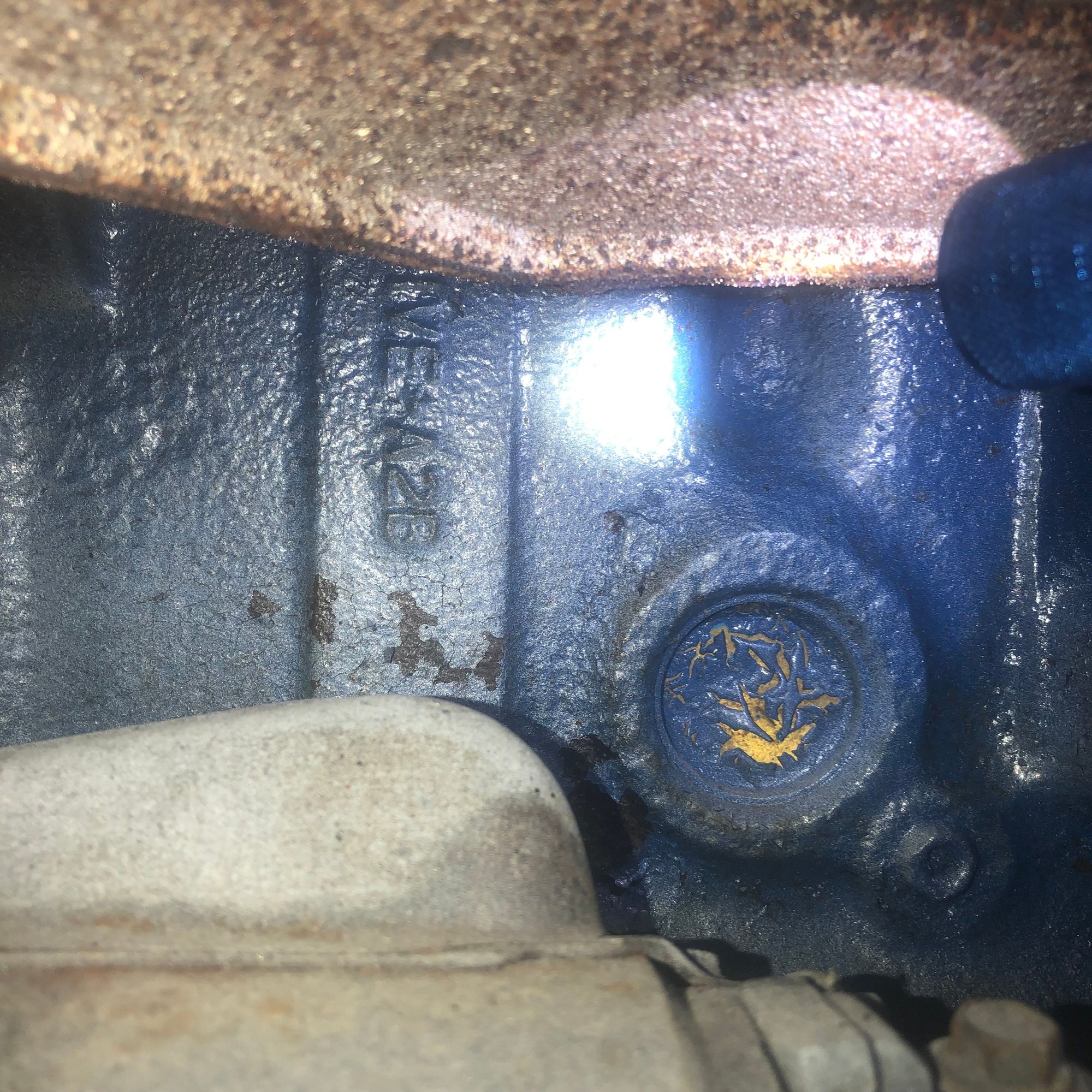

Pass freeze plug area behind starter going vertical:
D1VE A2B
there is a “101” on block by fuel pump.

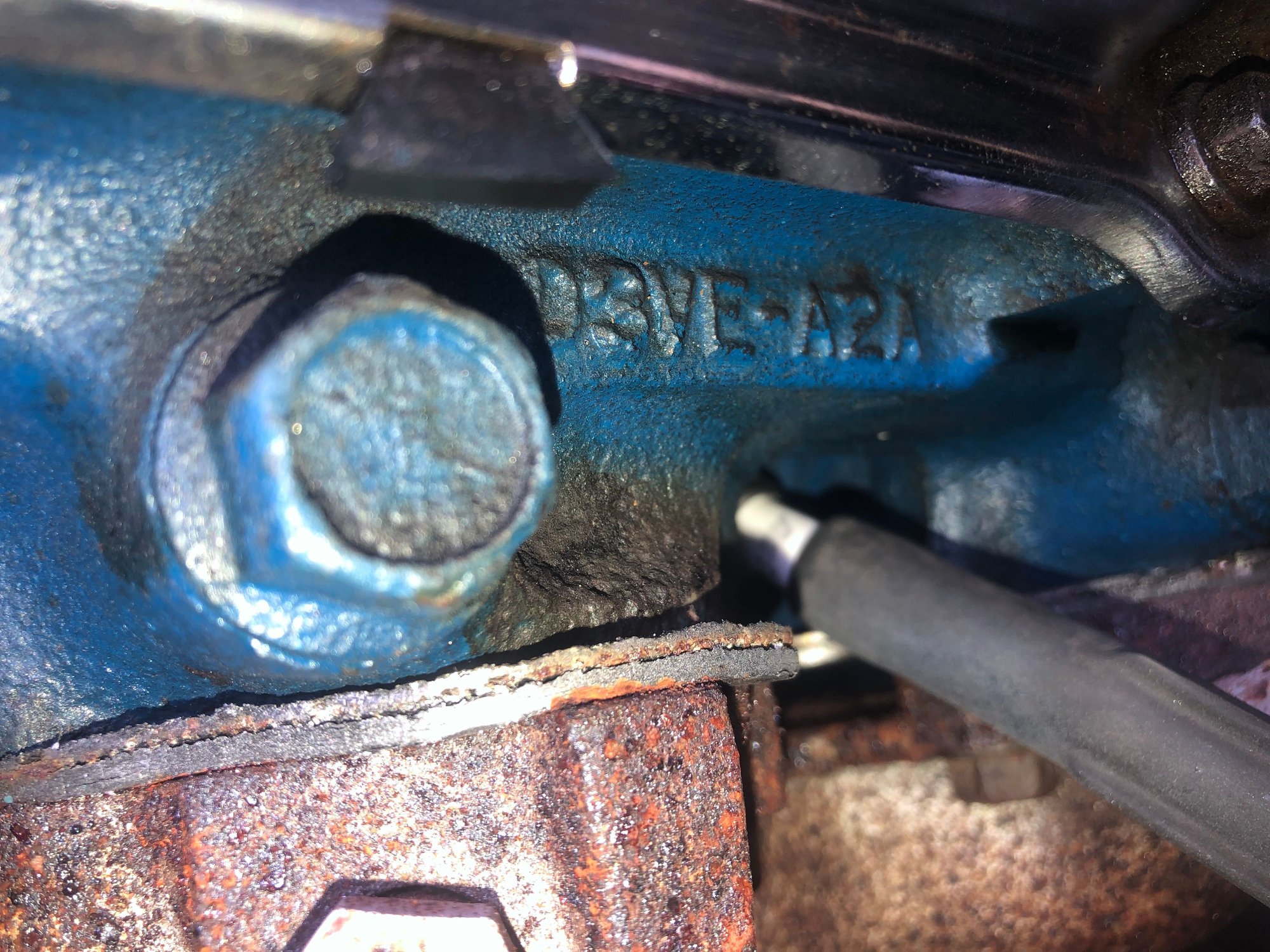

Heads are DV3E A2A
if I’m right and this engine hasn’t had its heads swapped, do I have a smog era 71-78 460?

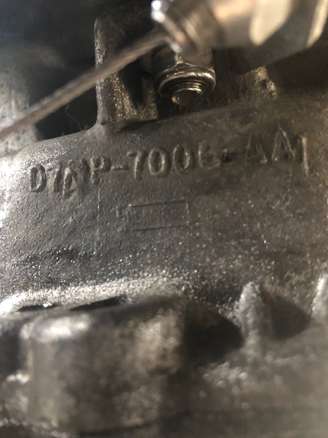

Trans has casting # D7AP-7000-AA. I’m aware that prob doesn’t mean much. It shifts good and the fluid is nice and red. The metal tag I’ve heard about is not present on the trans

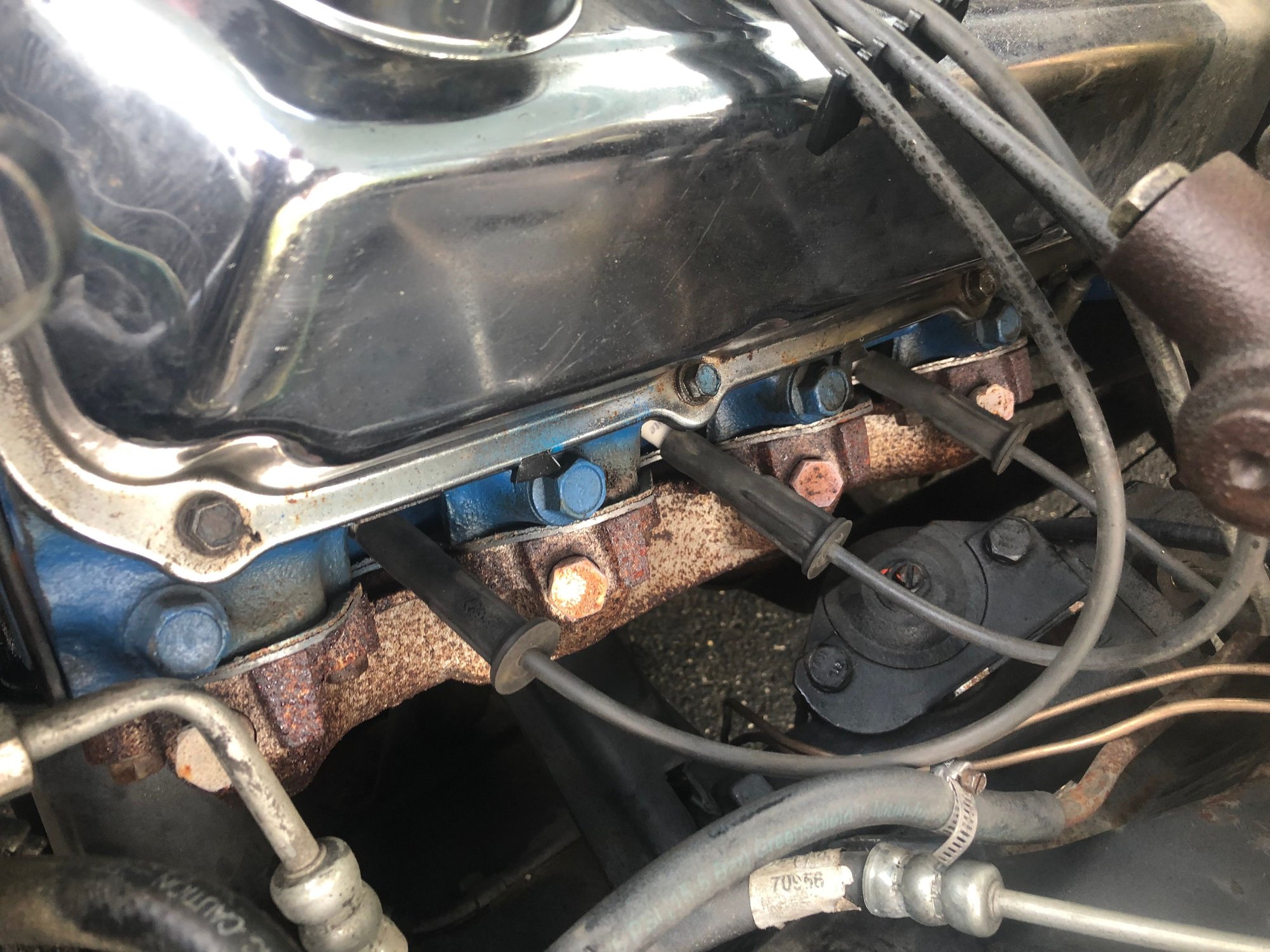

Plugged er in manifolds

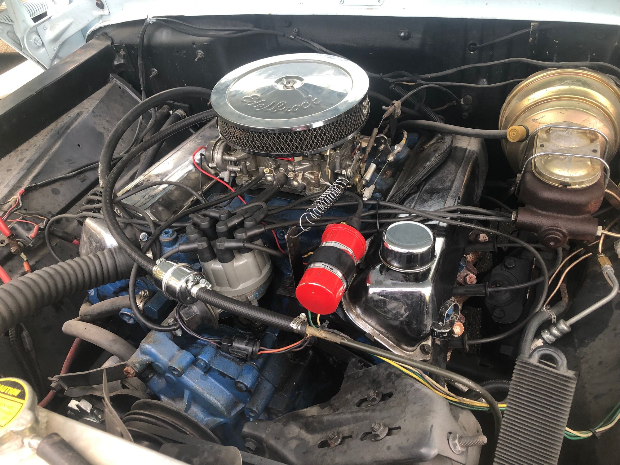

It has a durapark already and a 600 cfm Edelbrock. I believe I have the “bad” timing set and since everything up front is leaking oil, I’ll change that out and reseal/ detail things. Other than that, he plan is a tuneup.

D3VE-A2A are '73-'74 429/460 heads.
Some discussion:
https://www.ford-trucks.com/forums/7...460-heads.html
That thread also talks about the block casting number of D1VE being a common 429/460 block.
I think your transmission casting number should be "D7AP-7006-AA"
https://www.ebay.com/itm/166499924775
Just a garden variety C6 for the 429/460,
However, the 429 for cars was discontinued '74, so IF this engine transmission combo was brought over together, that would put it at '77 or so and make it a 460.
(The truck 429 came later, and you do not have one of those)
The plugs in your manifolds were for air injection via smog pump, not EGR.
So if it runs good, run it.

yes I mis-typed the trans number. You can see the right # in the pic. Sort of what I figured on the rest. Yes it runs good. May need some carb tuning and maybe I’ll swap the timing set.

I have a PO installed 385 series in mine as well. Don’t judge it by the exhaust manifolds since fitting headers would be difficult. NTL, sounds like you’re on track with your current assumptions. I would measure the stroke to be sure.
Your plan to just drive it is a great one. However, if you're going to dig into it a little, I suggest posting on the FTE 385 forum. Specifically, Dave McClain is a real 460 guru. You might consider looking for advice on timing set, and cam to go with the existing heads.
BTW, your distributor is currently hooked up to ported vacuum. I'd move it to manifold vac when you get to your tune up. Ported was an early smog device designed to increase chamber temps during idle to burn exhausted chemicals. It should idle better and cooler on manifold vac.
For your upper radiator hose, if you want to replace that universal unit, I scoured catalogs and found gates p/n 21026 fits pretty well. Another member used 22692, and I believe he had to cut it. Looks like you have an aftermarket radiator, so unsure if it will be the same. Here's pics to compare the geometry to yours.

Looking at the block casting number it shows "D?"1VE
Therefore according to the page linked below, the "V" is for Lincoln. I think you have a Lincoln 460, unless a 429 by chance.
I have a 429 with the D9TE casting, and my engine builder said it was a 429 when he disassembled, it's from a '78 E250 Van.
Kelly hotrod - Ford Engines Page 4 (raceabilene.com)
Like mentioned above, measure the stroke to know for sure.
