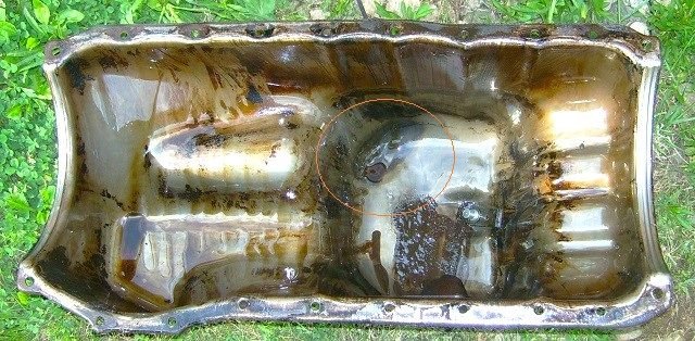

I think it far more likely that a 2x4 front sump pan will hit the front axle, or trac bar on a 4x4 as there is no cross member under the pan. My '77 351M 4x4's pan has been welded (maybe 3" long) after some damage long ago, looks like it was maybe bumped on a lift? Looking close, looks like lightly hammered back to shape. Nice weld job too. I didn't chose to replace it last year as this welded one has no leaks (though I do have another on a 400 stored on a stand).
I took the first picture before cleaning in the pan, the second pic is just to show about where the weld is. I did the safety wire after drilling a hole in a drain plug. I also put the magnet on, I pull it off as I start to drain the pan.

tbear853, yes, mine has the plug centered, though indented a bit, like the one in your photo. I've seen other pans with the drain plug on a low corner. Thanks for the pix.
dlburch, thanks for the part number and especially for the rear vs. front sump info. That was another variable I didn't know what to do with. Much appreciated, both of you.

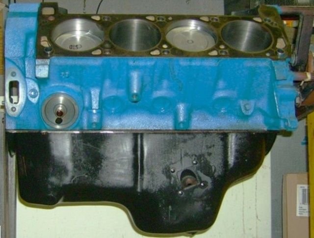

Mine is not dented in, it has a dip in it where the drain is .... just looks dented in the picture. This below is a 4wd pan from the side.
I added the yellow and orange for a different thread awhile back, but it does help.
In the case of a 2wd pan, the oil pickup is more or less under the oil pump so that pan is deeper at the front, and shallower at the rear.
2wd also has the dip stick going through the engine block to measure oil depth there at the sump where it is the deepest.
Note how the very bottom of the sump is not flat, but very slightly rounded to create a lowest spot under the pickup inside, and even then the lower lip of the drain where the drain bolt is ... is slightly deeper. I measured from oil pan lip flat portion where bolts pass through, not the raised lip. It would be easy to think it was jacked ... even if not. On the 4wd set up like pict6ured, the oil pickup is on a tube that has a support that is captured under the head of #3 main cap bolt too.
It would have to be bent and busted pretty bad to be unfixable I think. If all wrong is a leak, if the engine is moving oil then it's picking up oil, I'd for sure just fix the leak (after removing the pan of course). Do inspect the long tube and pickup while the pan is off. If any question, just use a stiff wire to insert through the drain hole and feel to see if pickup is just close to the pan bottom.
I don't have a 2wd pan.

I will leave you with a picture of the correct 4x4 pan on a 351M/400 block from both sides minus the writing. In both pictures, the rear of the block is bolted to the engine stand. In my first post at top you can see the bolt pattern and lip shape, the front is to the left, the rear is to the right. "F250 warhorse" has you covered it seems.
stand front
front stand
