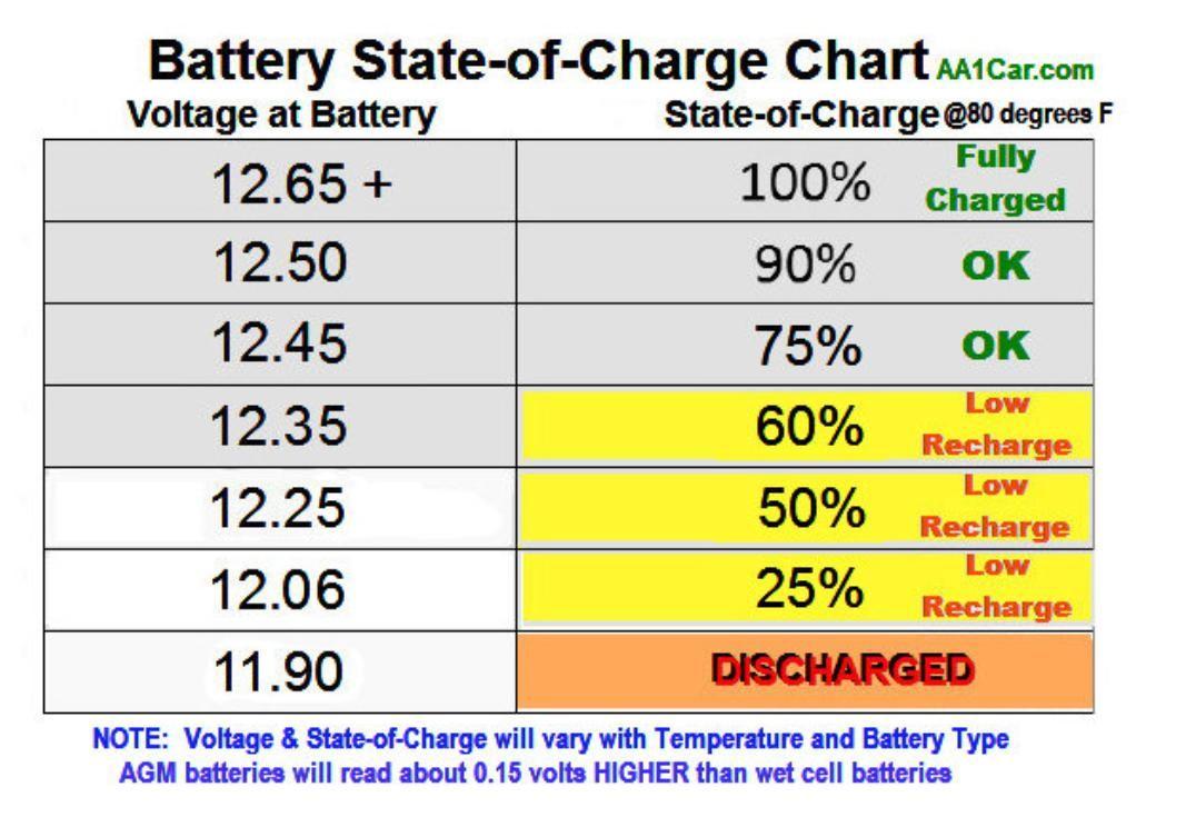

the batteries will NOT be equalized properly unless they are pushed to 14.8+ volts, look at this chart under Flooded.
Note at the bottom of this chart, it takes 2 hours to fully Equalize the battery cells.... the reason the Alternator regulates at 14.8 volts, is because most urban trips are 20 minutes to work and back, if you don't push them hard, they will not be charged enough to last more than 3 years.
Resting battery voltage, not being charged, engine OFF
another chart to peruse.
