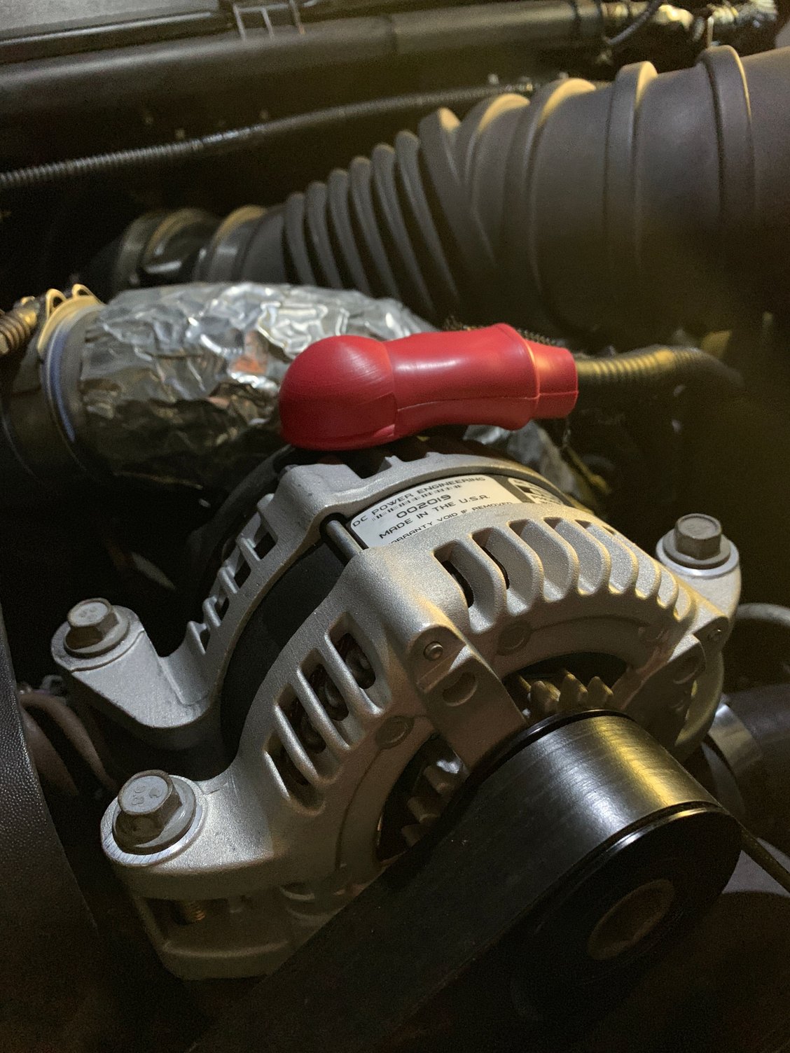

I've been running the 8307-180-HP by DC Power since Jan 2019. The Nations Starter & Alternator crapped out just outside of the warranty, and they really didn't want to help.

The DC is my current one since Jan 2019, the Nations starter & alternator I felt was crap.

I did not, I am still on factory cables which I replaced new in 2016 from Ford.
Although I am not consuming 180 amps, I did add a crossover cable from the alternator to the pass battery for more even and distributed charging.

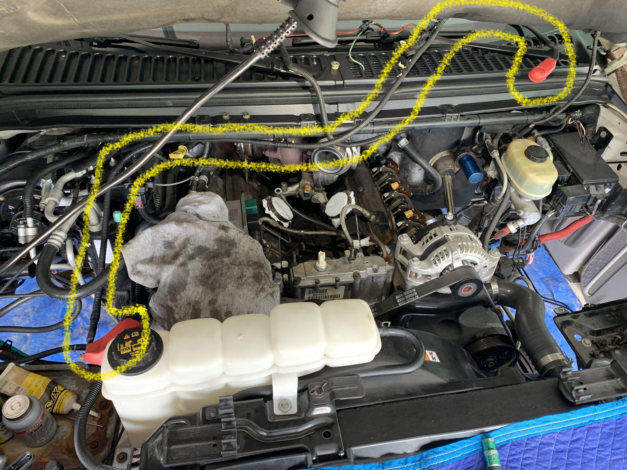

The new Mechman 240 amp alternator arrived yesterday and I'm now waiting for Amazon to deliver battery cable, lugs, hydraulic crimper, 300 amp fuse, heat shrink tubing, cable loom, and a 1/2" breaker bar (for the belt tensioner).
The only concern I have is if there's clearance under the hood for the fuse that will be located on the alternator output stud that is oriented straight up. It's about 1-5/8" tall. It should be fine, hopefully.

[QUOTE=01__Excursion;21320582]I did not, I am still on factory cables which I replaced new in 2016 from Ford.
I like the idea of running a ground from the alternator body to the passenger battery for a more balanced power supply. I'm curious if that theory has been proofed. I'm about ready to install my new alternator and have pos and neg going to the drivers side planned, but after seeing this makes me re think this.

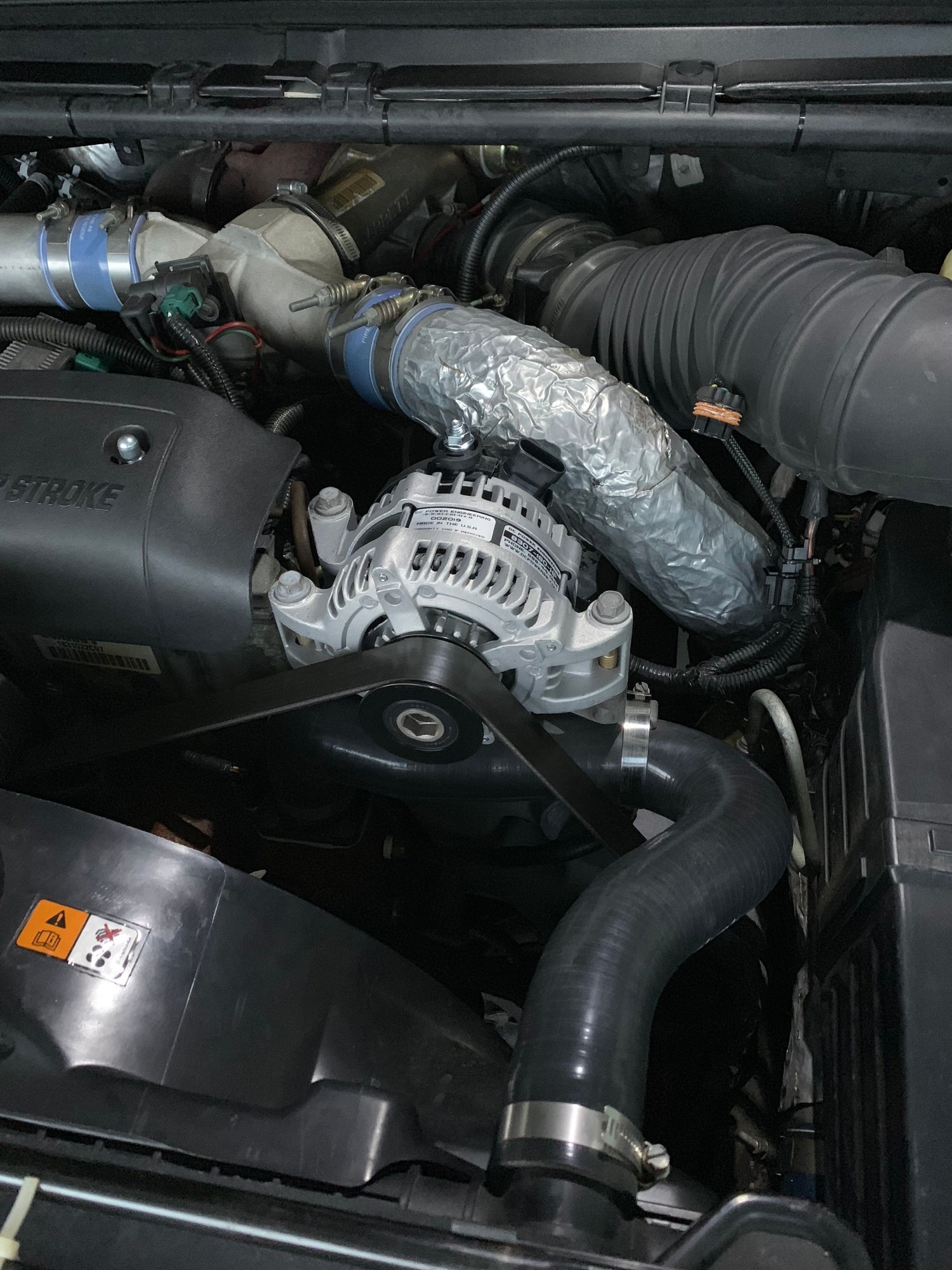

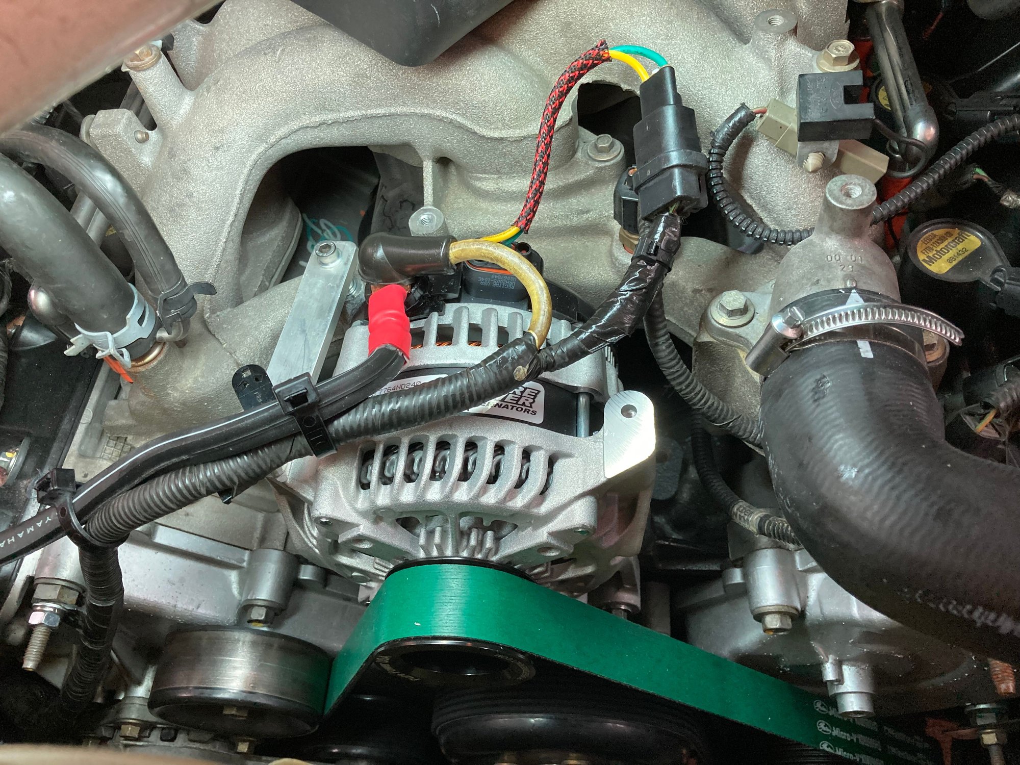

We have a Tucson 250. Installed it about two (2) years ago. Had to cut a small/straight piece of aluminum for the top anchor and grind a little bit of intake manifold, but other than that, it fits.
We also did the big three (3). In our case, it was the big four (4). I’ve read that you can never have too many ground wires. My father-in-law, who passed away, left me with a bunch of thick copper cable, so I loaded up.
We also had to calculate which Gates belt to use since the pulley is smaller than OEM. We got the green one for daily use and a cheaper model for our back-up.
It’s a brand new alternator. No need to send your old one back.
So far, so good.
