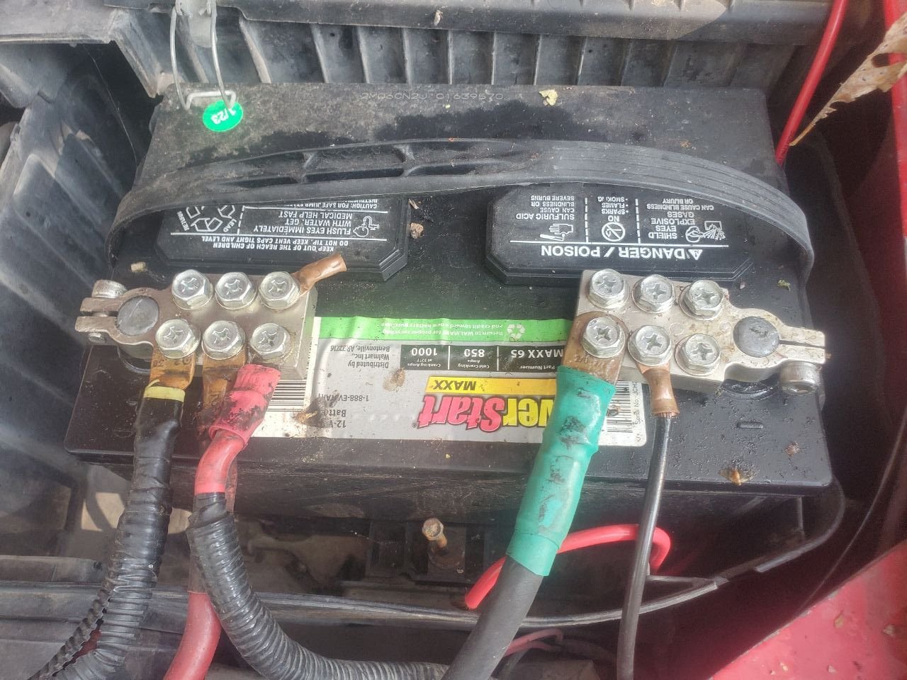

No, no grease, just a bright clean wire strands, no corrosion on the wires allowed.
Once Crimped, you can add solder to the crimp if you wish, I usually don't.
I like to use Heat Shrink instead, which you saw in the pictures on my batteries.

if the batteries had a Parasitic Draw on them while in the shop, they were probably fairly low, requiring a lot of amps to get them back up to 14.6ish area.
the alternator was trying to recharge them, and that is why the Alternator wire got so hot... and pushing a lot of current, revealed the power connector/corrosion situation.
any auto parts store will have lugs big enough to put on the charging cable, and the old fashioned Hammer Vise type crimp tool will do the job.
you will be very happy with the MechMan once it arrives, but make sure to add extra charging cable(s) from the Alternator to the batteries...
while you are at it, inspect all of the battery cables to be sure the connections are clean, and tight.... I spray all of mine with FLUID FILM, that way they stay corrosion free for years....

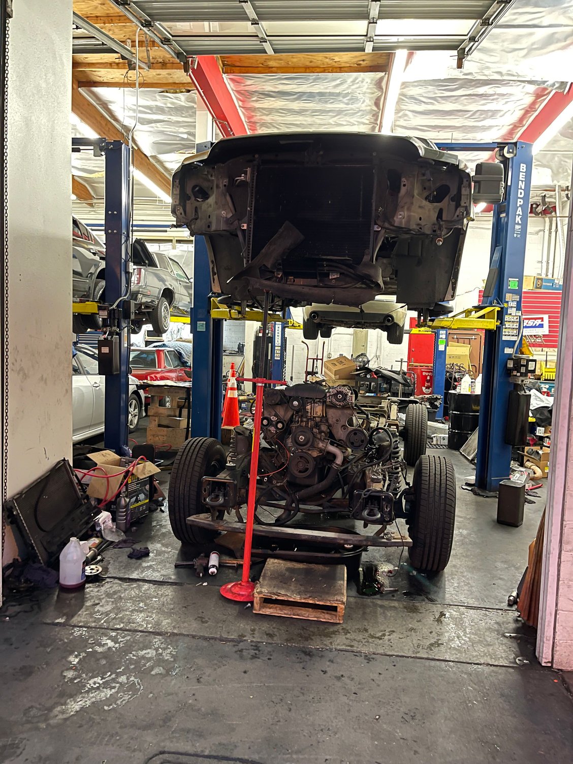

Here’s what it looked like in January 2023…

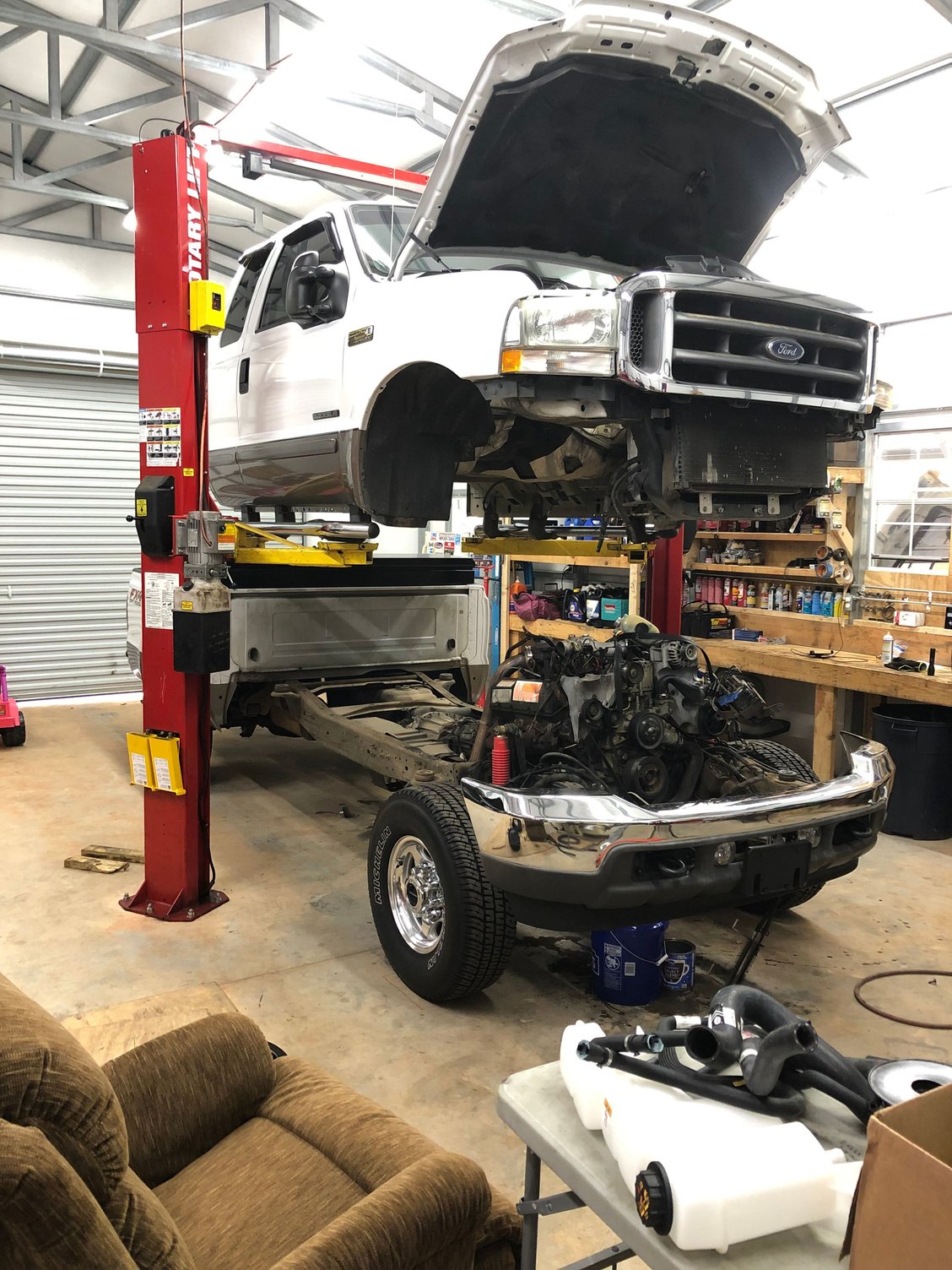

@KubotaOrange76 does a cab off to change glow plugs. No biggie. He doesn't like to get the front of his shirt dirty leaning over the fenders. Up it goes.

Yeah the shop tells me it's a 20 hour job. At the going labor rate here of $175/hr . . YIKES! Good thing it's under warranty. I brought it back at 7:30 this morning. They're taking acre of the little things first, the alternator wire lug, and both batteries are on the bench charging. They said both batteries were low on charge. Then the back-up camera which is probably just a ground wire since it's wireless. What concerns me is the transmission. When I drove it into their parking area and shifted into reverse, the engine died. Could this be a condition of low battery voltage? The volt meter did show 14.1 to 14.2 volts telling me that the batteries did have a low charge. I wonder if there's much extra draw on the electrical system when in reverse starving the electrical system, cpu, etc of much needed nourishment of voltage. All interior and exterior lights are LED with the exception of th front turn signal bulbs. Just haven't gotten to them out of laziness. If low voltage is the culprit, the new Mechman alternator will surely provide plenty of power with lots of reserve.

Interesting they pulled the Radiator, bumper, grill headlights etc

This was the photo that KBO76 dropped on the forum several years ago, in ho hum nonchalant fashion, citing that he was simply doing routine maintenance.
Not many have the equipment to do this at home. I don't think SSJ even has a twin post lift with a tall enough ceiling in a shop to make this happen.
From posted photos, most DIY guys show their cabs dangling from the buckets of front end loaders.
So I will probably continue teasing KBO76 about this until some more of you guys "level up" and get your shops built and lifts installed.
