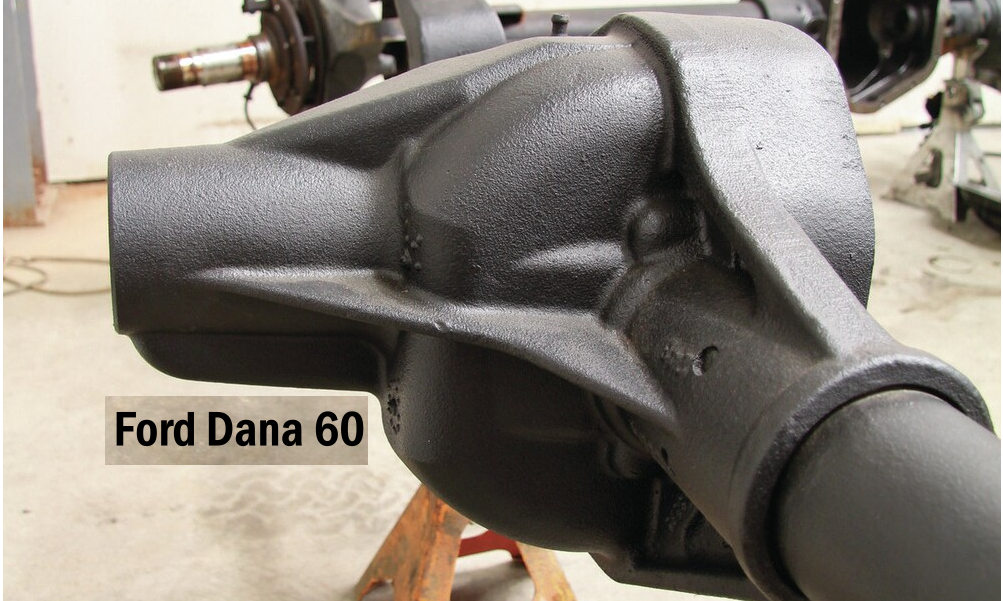

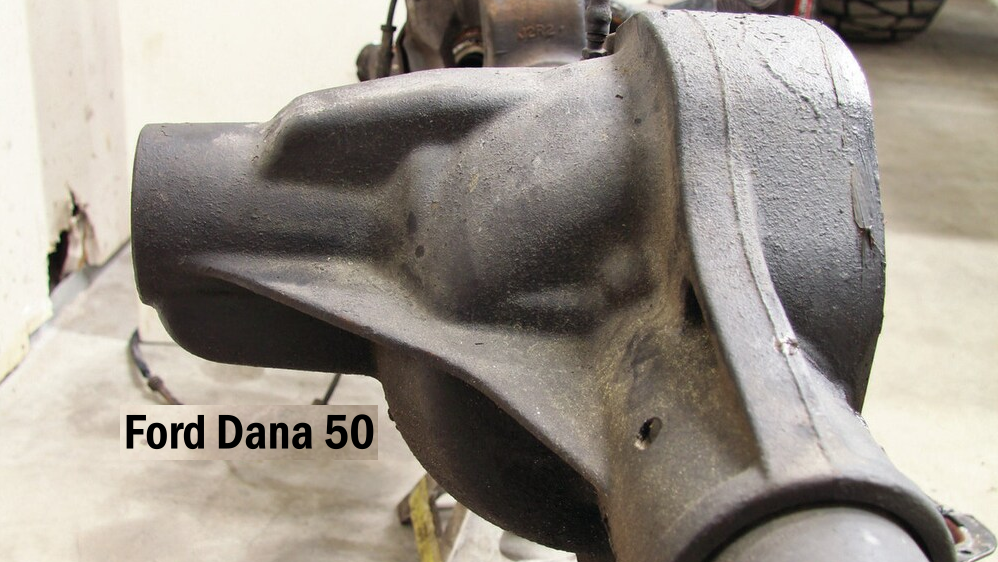

Well, I thought I had a complete set of 4.10's. Looks like now I have 4.10's for the rear 10.25 only.
I'm starting the regear in one of my crawlers. It has the D50. Or so I thought, based on the pronounced hump on the top. But it looks like it has D60 carrier and shafts............
I'll start another thread on that.

Old Aug 8, 2024 | 09:21 AM
nydiver's Avatar
nydiver
Joined: Jun 2009
Posts: 661
Likes: 186
From: Lakeland, MN
Old Aug 8, 2024 | 10:39 AM
