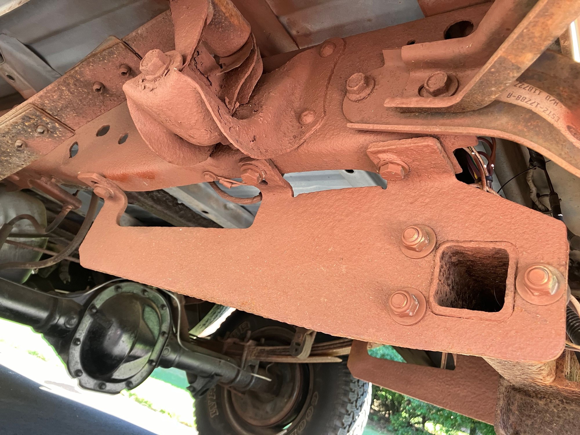

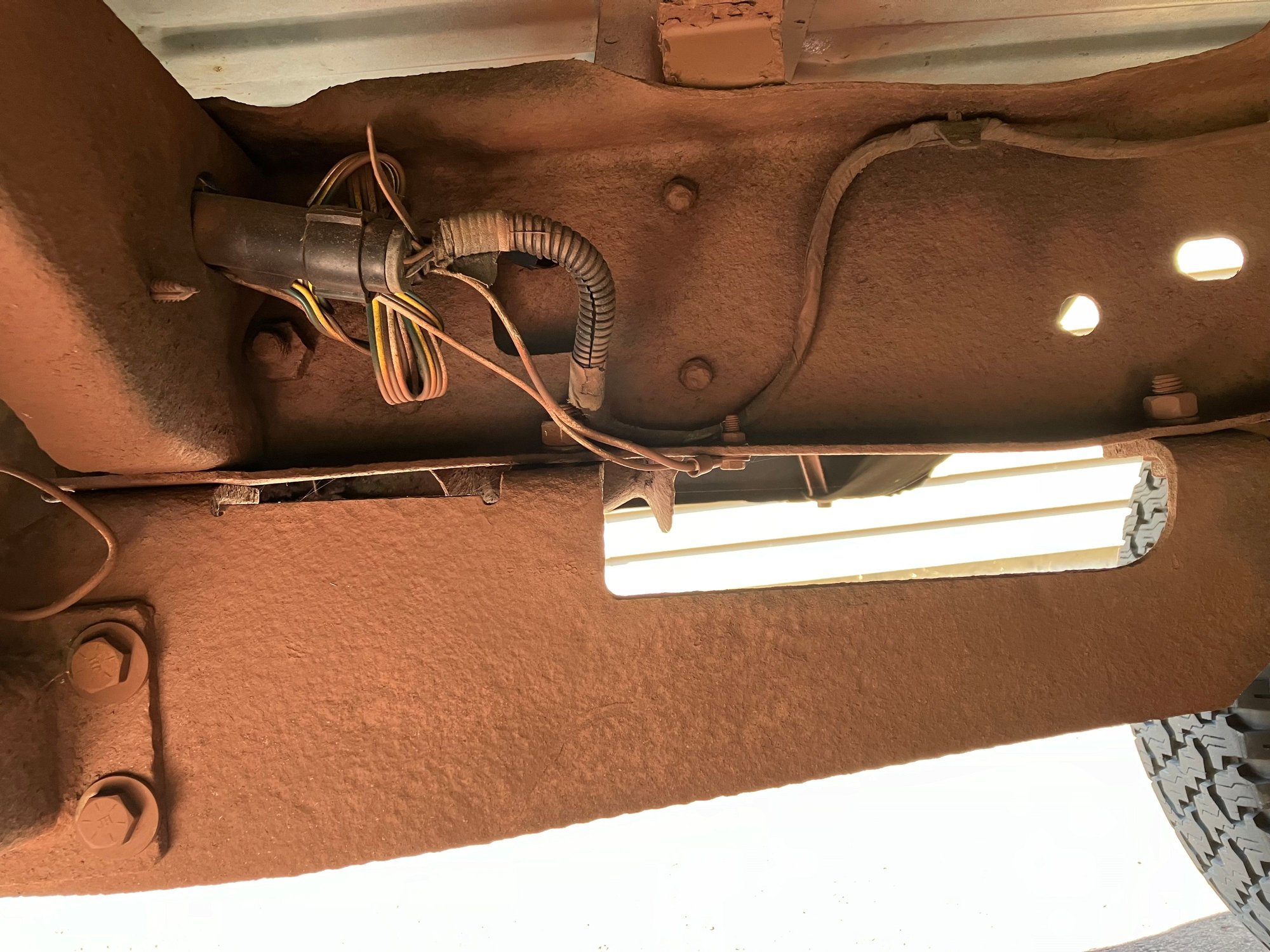

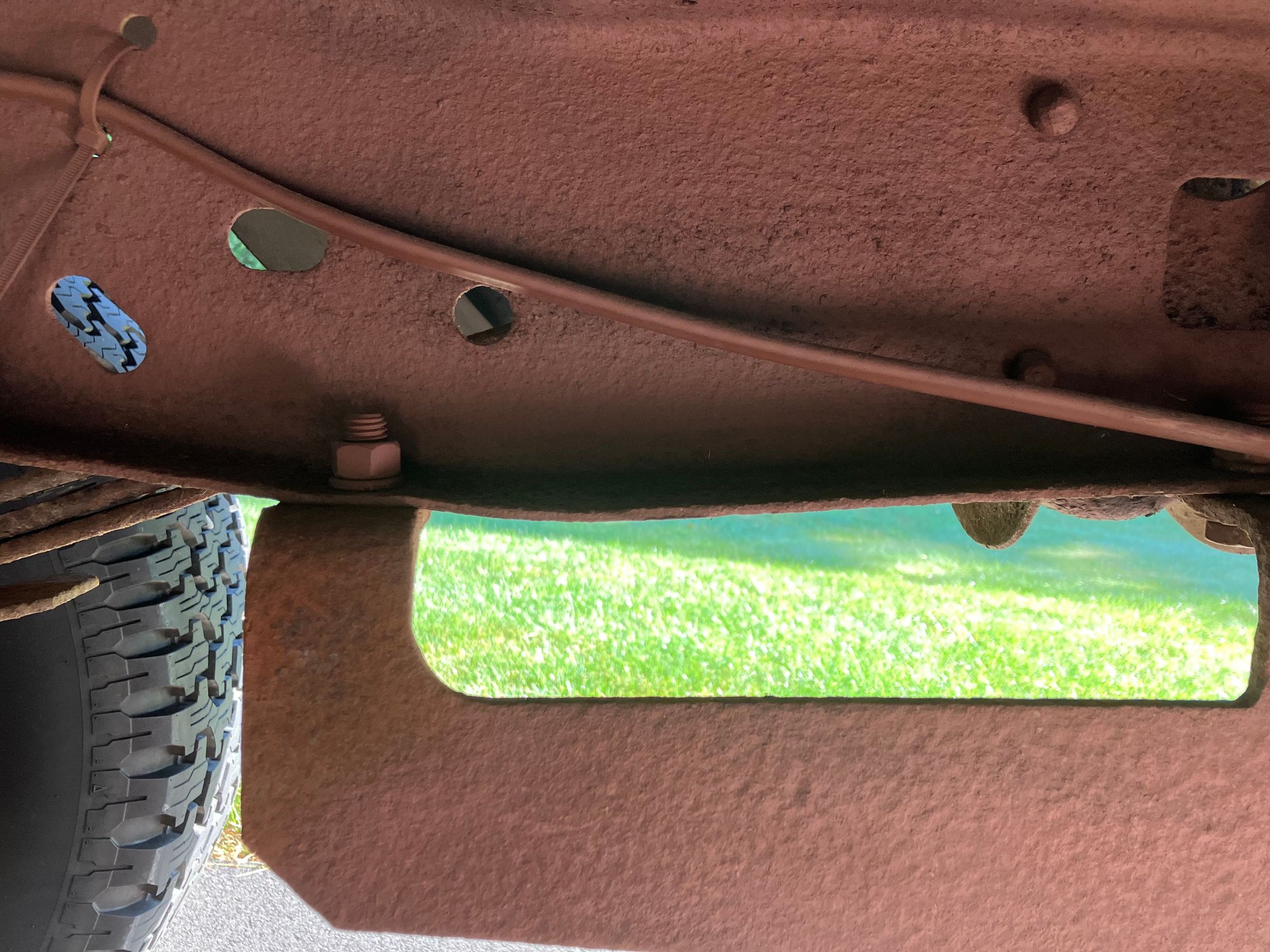

Only one belt for ALT. Smog pump removed.
I'll go out in a few and take pictures of how my hitch is mounted. Surprised I didn't have them already.

Maybe your truck is different from mine, I don't see any blocks. This was from a junkyard too about 12 years ago.

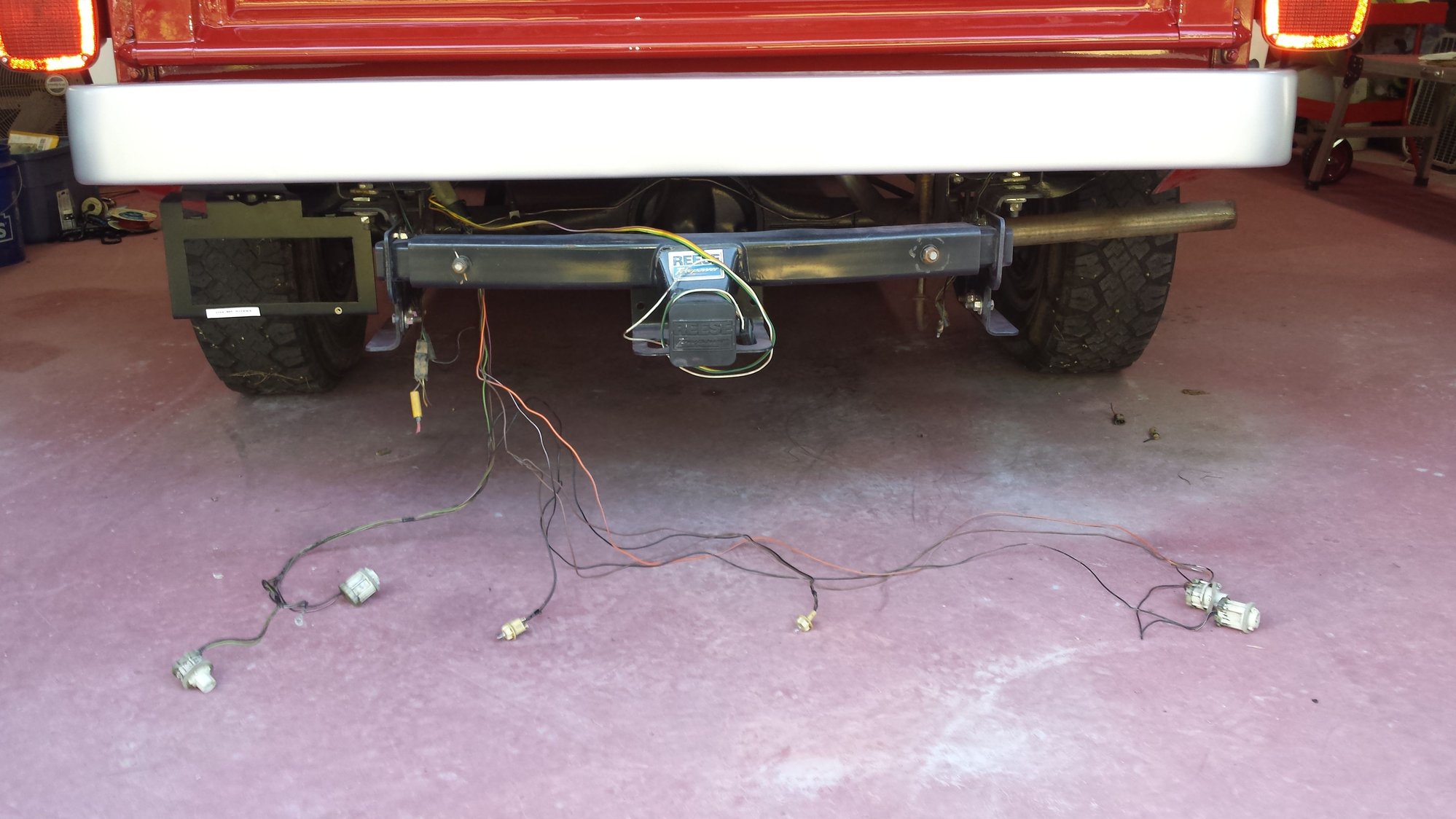

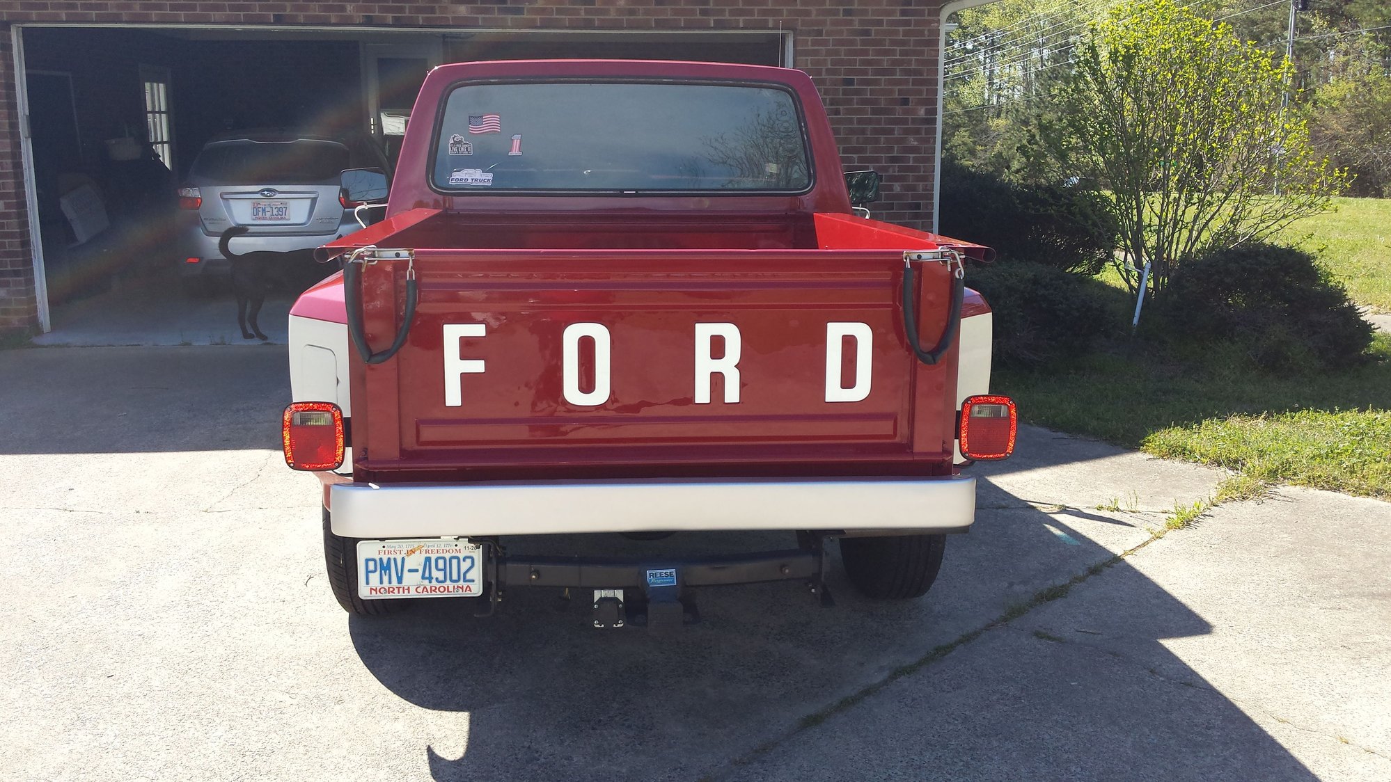

Mine is a "fit all trucks" hitch and IIRC used a washer between the hitch and frame on each side to level it out.
I was making a flare side tail light harness from a style side harness. Style side is laid out on the floor.
You can see the trailer light harness / pigtail wrapped around the hitch.
It Tee's in between the frame rail & tail light harness, no need to cut & splice wires, and I wired it into a 7 flat blade trailer plug.
Truck is also set up with trailer brakes and to charge a battery on the trailer if the trailer is wired to do so.
I carry a 7 flat blade to flat 4 adapter if I have to pull something like a U-haul trailer.

You can see how thin the frame is. If something happened I guess they figured that bolt with just a small washer and nut could possibly pull through the frame. If you do not have any, you could simply make some large rectangle washers out of 1/4 stock by cutting it and drilling the proper size hole.

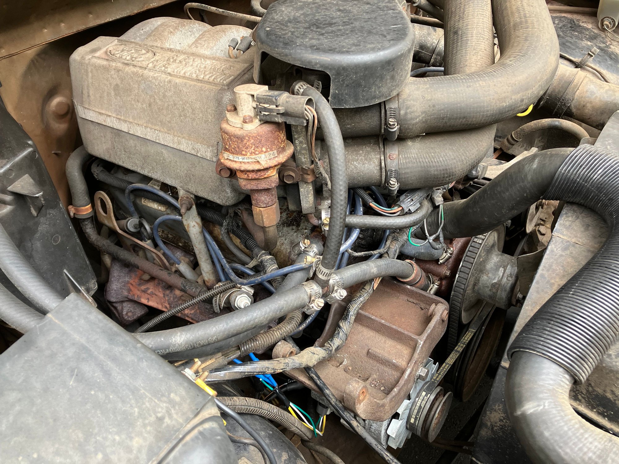

Question for Max capacity. So was that a smog pump you deleted there? Why would the heater core water lines be attached to that? Is it necessary to remove the pump and join the tubes like you did? Should I just leave it alone or is there any benefit to deleting it? Thank you.

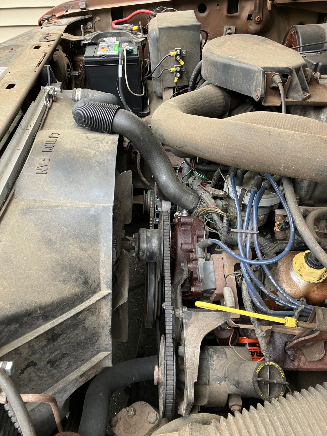

My belt setup
This is my config.
There seams to be no reason how the belts are run between years. At first I thought it was with AC or with out AC but I dont see anything for AC on MAX truck so
But if the air pump is driven by 1 belt and that belt dose not drive anything else I dont see why it cant be removed?
On the hose and the Tee that is how the throttle body gets heated.
On carb motors hot exh passes under the intake manifold from 1 side to the other by a valve on 1 side of the exh manifold / Y pipe.
On the 300 six motors the exh manifold is bolted to the bottom of the intake and a valve directs hot air to the manifold till up to temp like the v8 carb motors.
I run EFI exh manifolds on my 300 six so to get heat to the intake I pipe hot water to it like the EFI v8 motors do.
Heated intakes keeps the air / fuel mix in a vapor other wise the fuel condenses and drops out of the air and the motor runs like crap / flooded.
Dave ----

My heater hoses are in the stock location, that T goes up to the throttle body. There's another line out the bottom of TB.
The unused pulley on my ALT, drove the smog pump. If I remember right, its been a while.
Notice the pulleys from this side.
