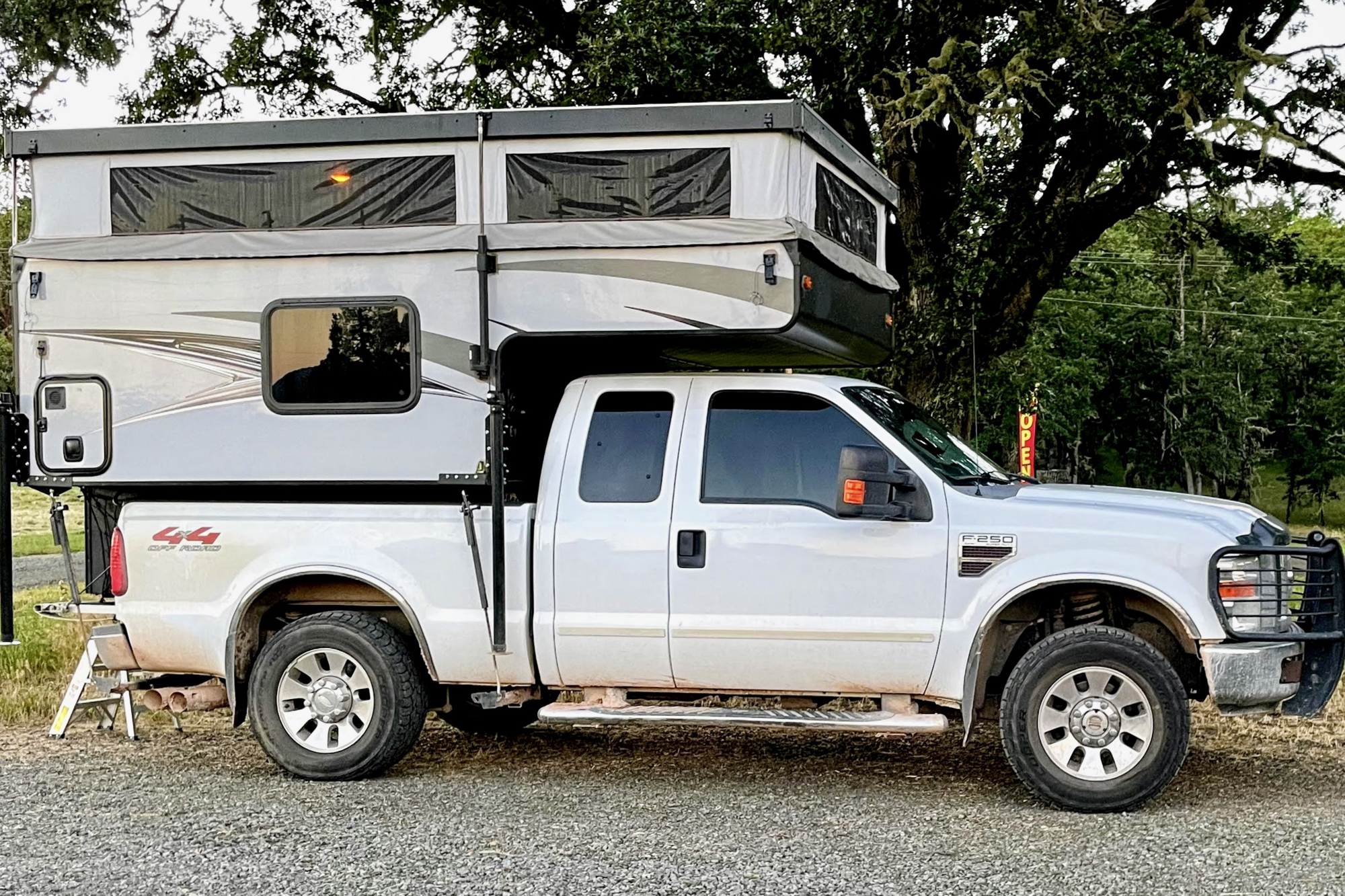

Originally Posted by crazytestpilot
I'm wondering am I asking to much of a 1/2 ton to do a camper and trailer?...
Yes, unless you get a VERY light camper.
My truck is the F250HD 8600 GVW version. With the camper on the back, loaded with gear, it comes to 8599.5 pounds total. Not a lot of excess capacity to spare. The truck is a factory Camper Special with sway bars front and rear. Empty it rides like a dump truck but smooths out considerably with weight in back. Tires are load range E and set me back like $1800 for a set of four. If you put that kind of weight on a half-ton, you'd be seriously overloaded and it would sway like crazy, too. Even if you beef up the suspension, the brakes are still going to be a limiting factor.
This is a fairly light camper, too. It's not some monster with pull-outs and its own zip code.
You might be able to get away with something like a Palomino pop-up:
I used to have a similar model with my truck. Much less wind resistance on the road, and a lower center of gravity for better handling. However, even though it was easy to raise and lower, it got to be a pain after a while, especially if you just wanted to hop in back at a rest stop, for example. I also didn't like having the soft sides and always worried about critters clawing their way through in search of food.

The other thing after seeing what Karl posted is rear overhang.
With a full size slide in and large over hang how will the trailer hitch work out?
Even with the pop up the tail gate is down because of the over hang. Again hitch and will the gate clear the trailer?
2500 lb trailer needs a frame mounted hitch.
Why is that pop up not all the way forward?
Then it looks like you could maybe close the gate or take it off and use the hitch if need be?
