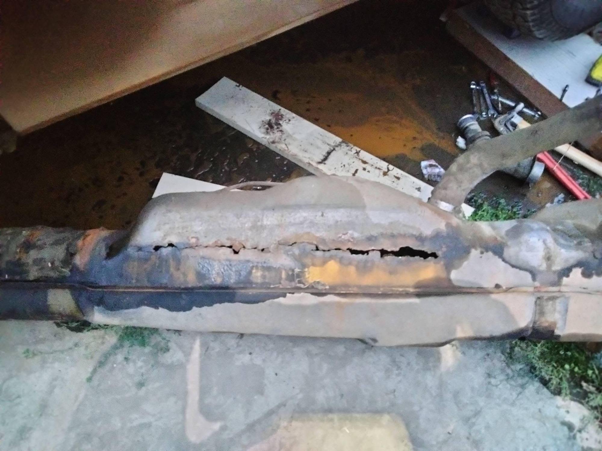

Well I pulled the tank. The pic says
it all.

I'm just online looking at a new tank and it seems like they've got every little part sold separately. I know I need a Tank, sender unit, vent and fuel line. Do I need to order the gaskets and misc. all separately ? What other parts should I be ordering. Thank you.

If the filler hose in not dry and cracked you can re-use it and DO NOT forget the vent that is inside the filler hose or you will not be able to fill the tank.
Other wise look to Fillerhose.com or Fillerneck.com for a new one. Any you get at the local stores are too short.
I would get a new tank, new sender check it before install, new roll over vent & rubber gasket.
Fuel hose for the roll over vent and fuel supply you can get from the local stores.
On the supply also replace the hose at the tank switching valve if you have one and at the fuel pump.
Old hose may look good but be bad on the inside and cause issues.
I am guessing the straps and bolts are OK so would not need to replace them.
You should have found something between the straps and the tank and maybe on the top.
You want to use something that will not hold water. A bike tube cut to fit would work.
Me I used in door / out door fake grass carpet (plastic)and put the black back side facing out so cant see it.
Now on checking the sender you can use a ohm meter to see if it will work before install.
My tanks were bone dry so I turned on the key and checked where the needle sat, below the empty line for each tank.
I then poured in 5 gallons in each tank and with the key on the needle sat on the empty line. So I have 5 gallons when needle is on the line.
When the tanks are full the needle is above the full line and that is OK with me as long as the gauge reads right close to empty.
Nothing worst than running out of gas with the needle at 1/4 or 1/8 tank.
