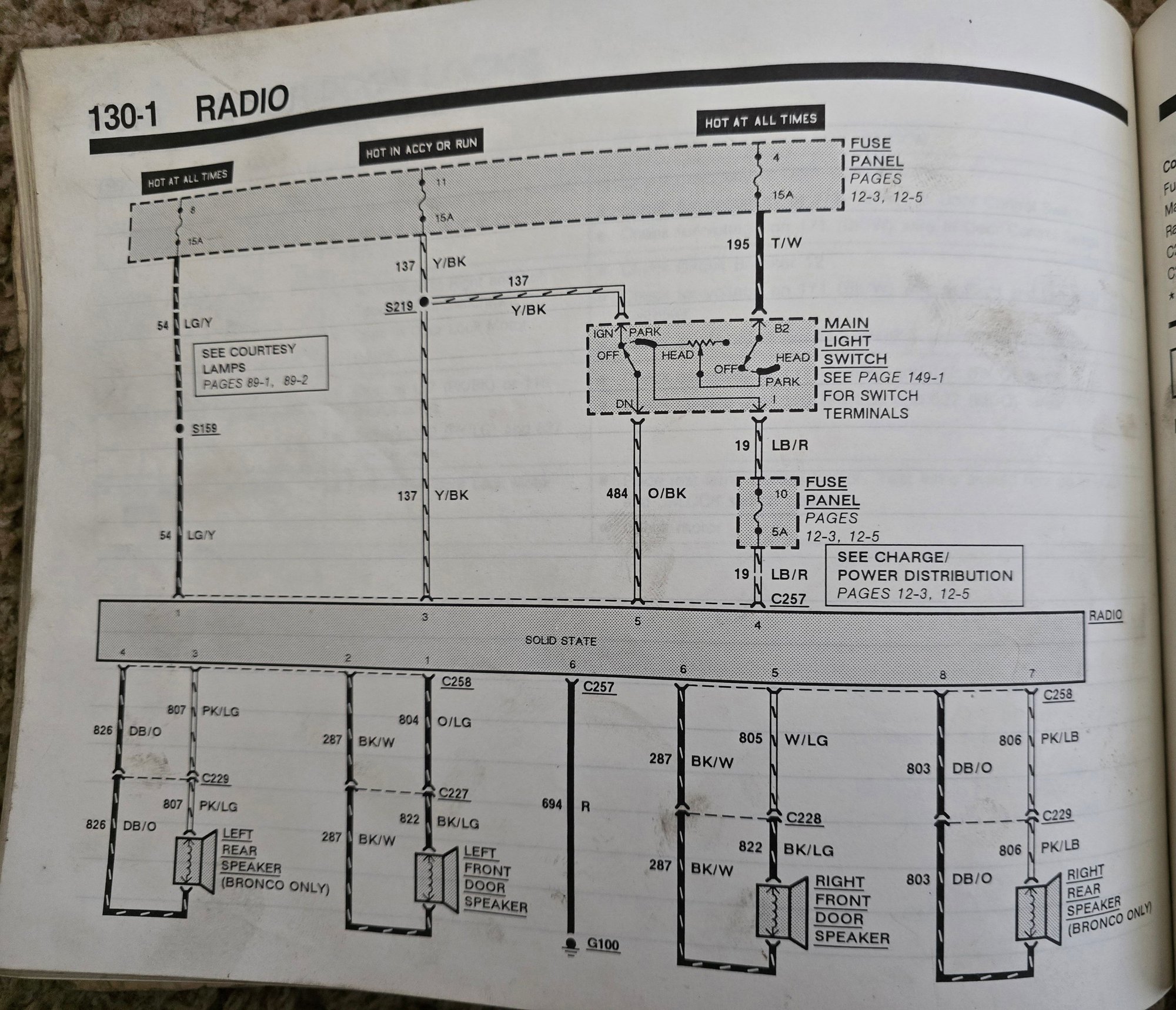

You need a 1991 truck EVTM to explain the radio circuit schematic for you
I have a 1990
it will be close or the same maybe
That radio power should come from the ignition switch with another constant power feed for the memory

Old Jul 5, 2024 | 11:19 PM
hoffieman's Avatar
hoffieman
4wd Low
Joined: Jun 2024
Posts: 14
Was a fuse issue. Thank you all for help. Got lucky!
