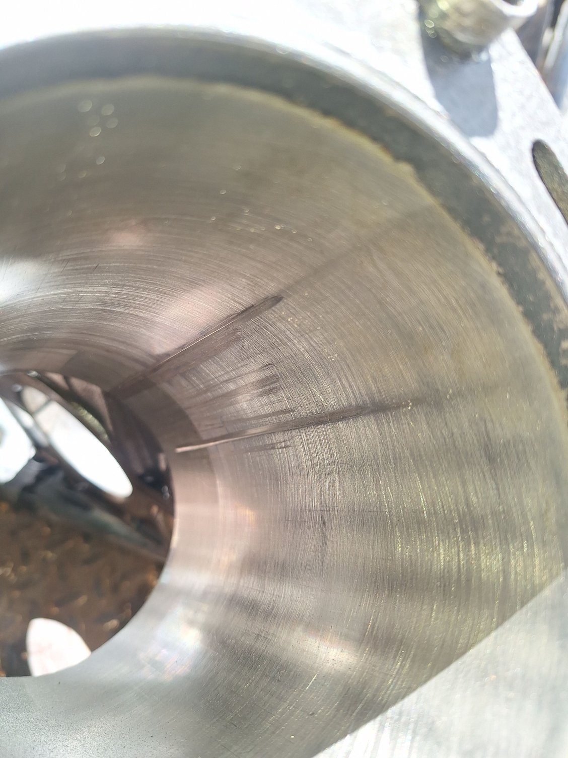

I like my 160/0's more than enough power to be "reliable" and I have those quotations due to the mill in my obs taking a dump. 100k of pure abuse towing heavy on a hot tune will do that I guess. Wrist pin bushings gave out my guess is cylinder pressure was just too much for the pistons and bushings to handle
Overall if you dont abuse your truck like I did you will be happy. But stock sticks with a decent tune are great as well, thats the reason when I had my injectors rebuild on my 00 I went with stock rebuild as I never plan on running a tune on it or abuse it like I did on my 95.
Just for reference here's the carnage of the cylinder walls on my mill,
Cylinders 1and 3
As bad as it looks the truck ran great, no excesive blow by, and only took the engine out due to a timing cover leak that turned into a worst case scenario once I saw the wrist pin clips laying inside the oil pan.
Cylinders 1and 3
Oh, I could imagine what was going through your head when you found those clips.
What!? That should'a buffed right out... Ok, maybe knock down the highs with a little emery cloth first. Then it'll buff right out.
It was like getting kicked in the nuts for sure.
Sorry, this is where my mind went.
