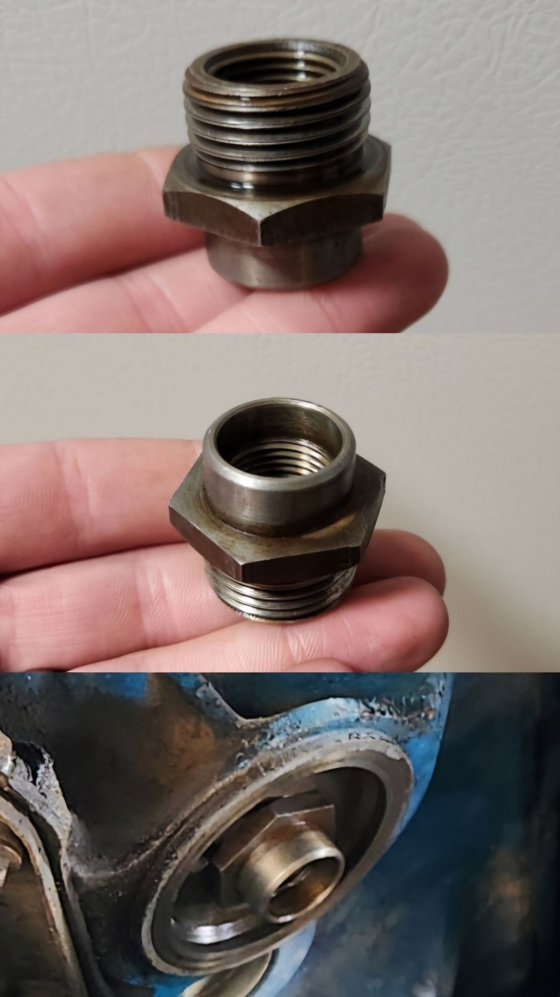

I've got a '95 F350 with a 460, that I'm deleting the oil cooler/heat exchanger on and attempting to mount a new Ford Performance 90° filter Adapter bracket on. Problem is, the new adapter needs a MALE 3/4-16 thread to screw onto, but the block has a 3/4-16 FEMALE thread fitting in the side of it... when removed from the block, it's evident that the top side of said fitting is threaded...
Does anyone know the MALE thread pattern of this fitting that goes into the side of the block? I need to find a new male/male adapter fitting that screws into the block in this fitting's place, with a male 3/4-16 on the other, exposed end, but can't seem to find the thread pattern into the block anywhere.

https://www.ford-trucks.com/forums/1...k-adapter.html
This looks like the information you're looking for.

Summit Racing adapter P/N ALL92003 worked for me, using the M6880-B50 kit, don't know the thread diameter/pitch.
