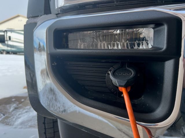

I mounted a NOCO brand battery trickle charger under the hood and then used their AC plug port NOCO remote plug under the passenger fog light. Makes it easy to plug in without opening the hood. I also have a "Y" adapter so I can also plug in the block heater when winter comes around.
NOCO plug

I've done the same thing with a different brand, but I wish I would've bought a better quality receptacle (as the weather cap keeps popping open due to vibration). Mine was hooked up to a Victron battery charger, which has since been repurposed.
But, yeah, it's very handy. The hardest part was running the 110V extension up to the battery area. The drilling and mounting of the receptacle was straightforward, as it was just plastic to drill through.
NOCO plug
good solutions. Thanks for information and additional confirmation of a good way to go. Especially like the NOCO link!

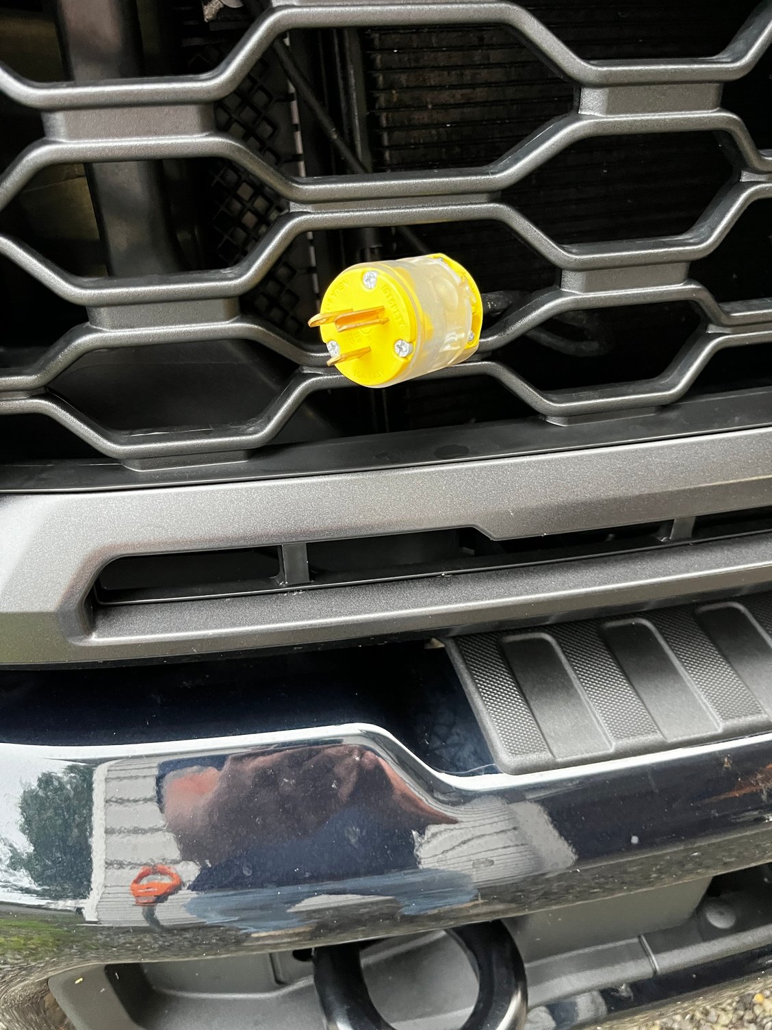

I found that the honeycomb openings in my grill are large enough to stick my fingers through to fish out the end of the plug. I tuck it back inside when not in use.
I probably should have some sort of cap on it. But the truck spends most of it's time in the garage when not in use. One of these days when time allows I'll investigate putting a plug in the plastic panel on one side or the other of the tow hooks. As sneil posted above, I don't have the option to do it where the fogs are on this 23 Tremor.
