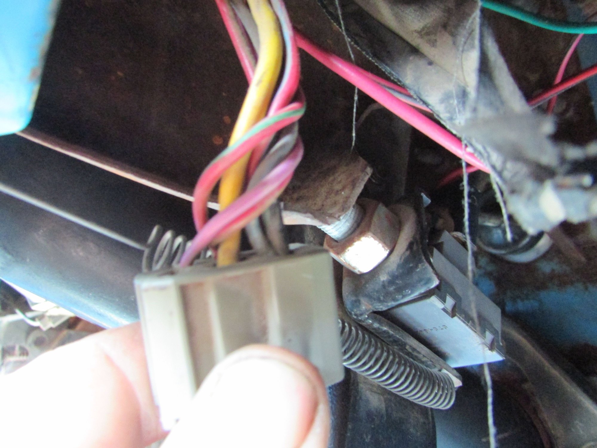

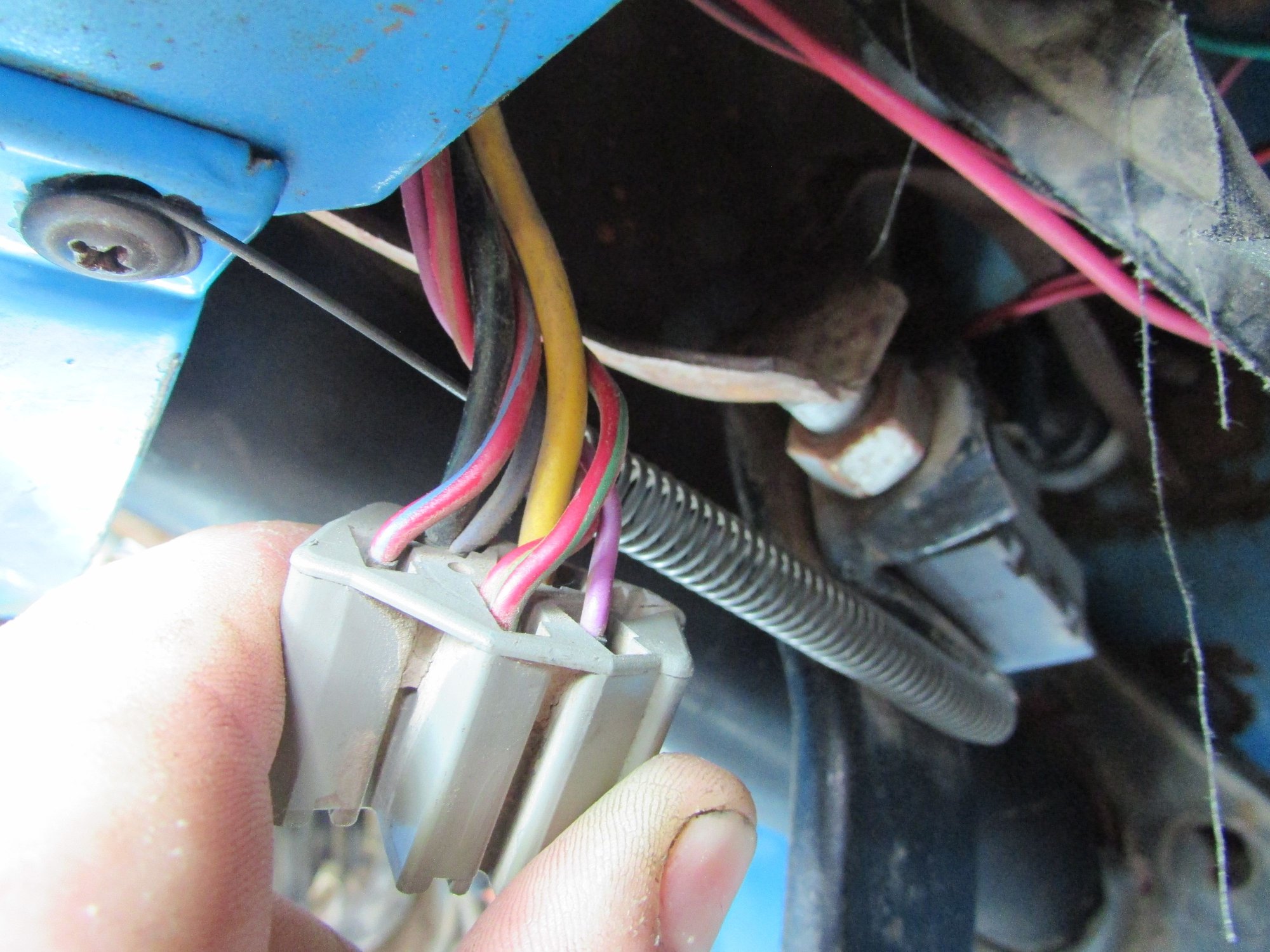

Here's a couple photos, best I can do

Perfect! Standard color configuration.
1. The Yellow wire is power in from the harness. Should be hot at all times, with full battery voltage.
This is the one you can test right off the bat.
2. The Red with blue stripe goes out to the starter relay’s “S“ post. cranks up the starter when you turn the key to the “START“ position.
3. The larger Black with green stripe wire (and probably the black wire next to it?) should be accessory power to everything on the truck except for ignition and voltage regulator.
Generally, anything in the fuse box that is switched, is powered by that black with green stripe wire. Perhaps the smaller one goes straight to the instrument cluster voltage regulator. I’d have to have a diagram to see what they do.
4. The Red with green stripe and (presumably?) Green with red stripe wires, coming off of the same terminal, are for the ignition coil and the voltage regulator respectively.
They are hot when the key is in the ON position only. This is what allows you to run the radio in the accessory position and not melt your coil or drain the battery because the charging system is energized.
on my phone, I can’t see the pictures and type at the same time. So I’m really not sure that the other wire is the green with red. But it should be.
5. The light purple/pink wire should be a “prove out“ or “proof out“ circuit. Used to test the switch and other things by sending a signal to ground when the key is turned to START. On some Fords this is used to temporally illuminate a warning lamp in the dash.
Not sure what it’s used for on all of our full-size trucks to be honest. I think some had the warning lamp, while others did not. And here again, since I can’t read the whole thread while I’m on my phone, I don’t remember what year your truck was. if it’s a 73, it’s very likely for a lamp.
sorry if I missed anything. I’ll go back and look at the pictures again.

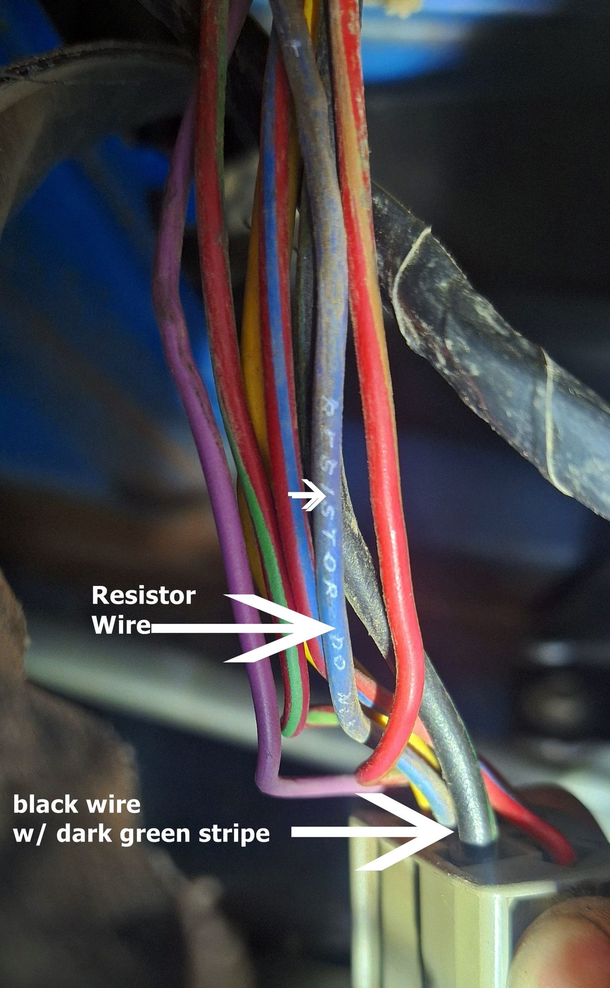

I saw a wire marked "resistor wire" that went into same terminal as the large black/ green stripe wire

I’d have to look at the diagrams to see what another resistor wire is doing on the accessory circuit. Normally, it’s attached to the red with green wire to the coil.
