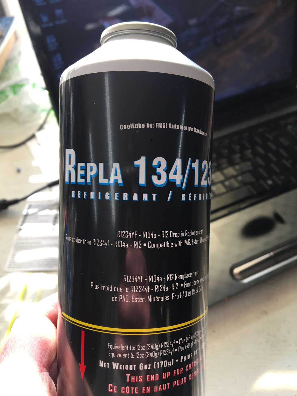

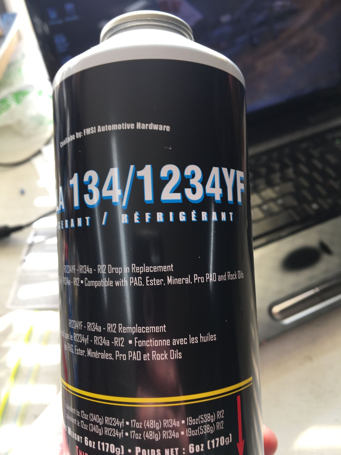

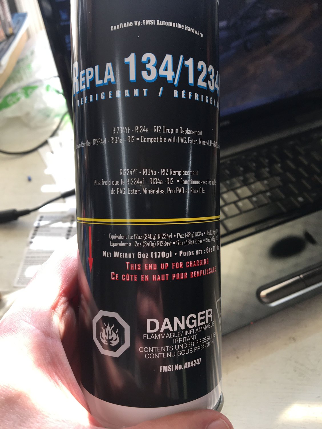

If you’re using the universal replacement refrigerant for sale here now, the weight on the can IS NOT the weight of the refrigerant. That is the weight of the universal refrigerant. Read the fine print on the can and it will tell you the equivalent.
Ie: If for r134a, a 12 oz can may be the equivalent of 17oz of 134… and different for other types of refrigerant.
I can only imagine how many systems are over charged… with flammable refrigerant.

Last time I did a full charge, I used a digital scale and measured the before and after weight of the cans. The 12oz by volume can was only 6 or 7 grams over 12oz by weight.

I've already purchased the red tek coolant stuff and the ac recharge manifold thing plus the vacuum pump so I'm going to try fixing it myself as I'm tired of paying shop prices and I have to do my ram 1500 as well which I have all brand new parts for aside from the functioning compressor so see how I do I guess and go from there lol.
If the R134a equivalent red tek stuff doesn't work then I'll order the good stuff from down south and try again.

Yeah already noticed that on the can. I'm no genius, but not a dumb dumb either lol 😉🤣

Yea, definitely need a small scale. I measure the weight of each can full, then empty just to be sure. Or as I need on the last can to top off.
This ‘replicant’ refrigerant is terrible stuff, imho. I’ve tried it, and the pressures won’t match up either..
There are various brand names of it.

There's tons of posts online of guys doing their ac systems with this stuff successfully so I'm going to give it the old college try at least. Already spent the cash on everything, but it's always 3rd times the charm on these trucks lol so just cross my fingers and see what happens 😑
