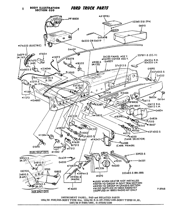

Seems to me that they removed/replaced one reinforcement that would have been on all 1961-1966 trucks. In this drawing look for number 04551 near the lower right.
C1TB-8104551-A - REINFORCEMENT - INSTRUMENT PANEL TO DASH

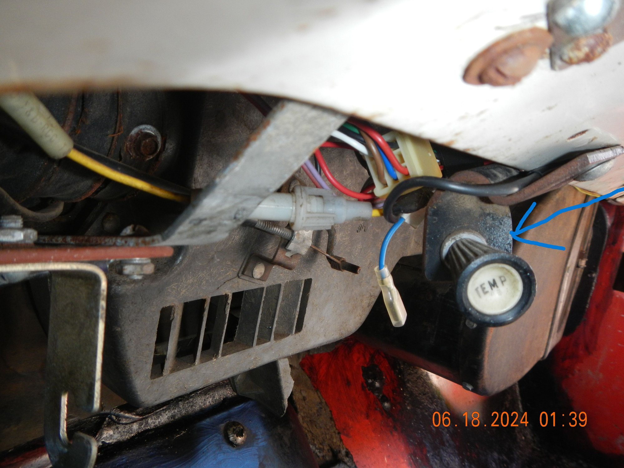

One other thing I noticed is the TEMP ****/cable is in the little bracket. Originally that would have been a bigger bracket that held two *****/cables next to each other for TEMP and HEAT. Here's what the complete bracket looks like. I bought a truck with A/C added by the previous owner and he hacked this same bracket to make space for the A/C blower under the dash in the same area.
This one with the blue arrow? Yes, I was wondering why it is cocked at an angle like it is. Is this the location this **** is supposed to be at?
Or is it supposed to be in one of the other two holes that dont have a **** in them?
There is an empty hole right above the trailer brake unit that obviously had something in there at one time,, is this where that **** was originally do you think?

I believe someone drilled the extra hole to the left of the steering column on your truck. And an extra one to the right as well I'm thinking.

Oh Ok. Compared to yours it looks like someone must have drilled and extra hole, one on each side my trucks steer column.
That bracket that you have a picture of by itself, is that the one that is now in your truck or an extra bracket?

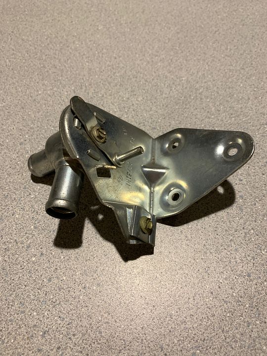

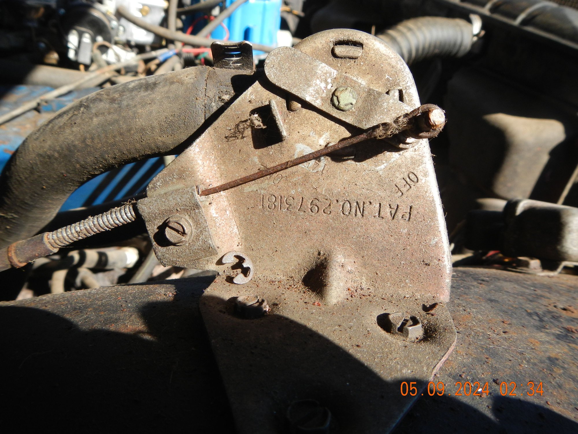

One of the two heater hoses that goes from the engine to the heater core would have this valve in the middle of it attached to the inner passenger's fender. The Bowden cable loop went to the stud on the valve pivot lever. If this valve was never installed then the inner fender has 3 dimples where the holes would go for it so it was easily added.
You can maybe see the 3 dimples in this picture on the top of that inner fender to the right of the horn relay - which is another place to look for the horn relay besides the core support, by the way. In this picture the truck has the manual valve on top of the intake manifold where the hose attaches to it. So, to turn on or off the heat (flow of water through the heater core) you had to open the hood and open or close that valve by hand. Not so fun when the engine is already hot as you can imagine. Especially compared to doing it while seated in the cab.

The truck most definitely has this valve. *Which **** controls this valve?
The last pic, is the blue arrow pointing to the Horn Relay? (if so, Thank You for letting me know!!)
