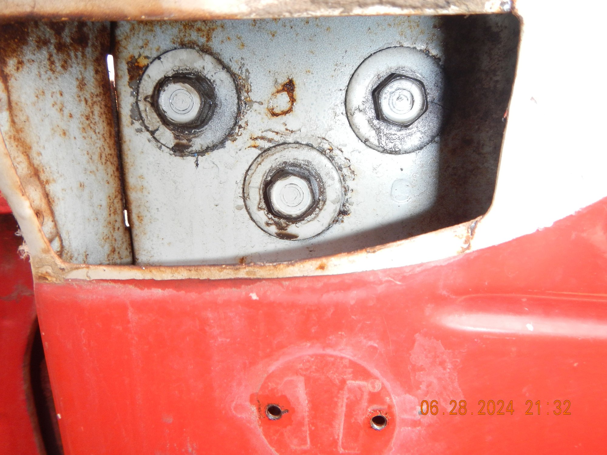

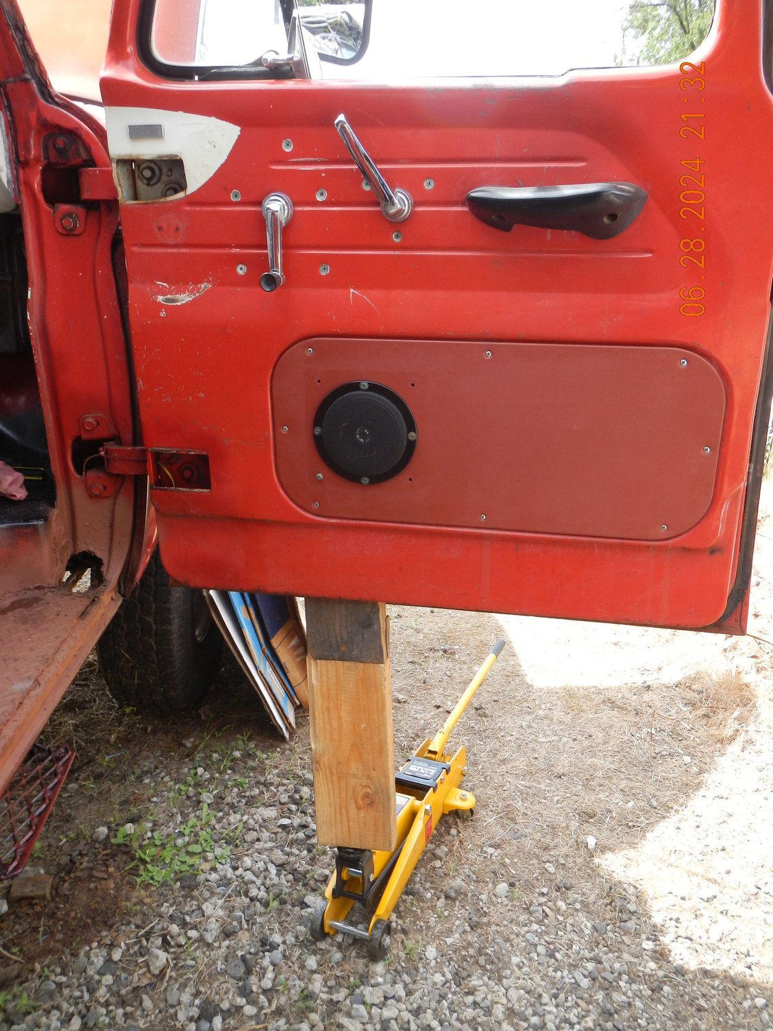

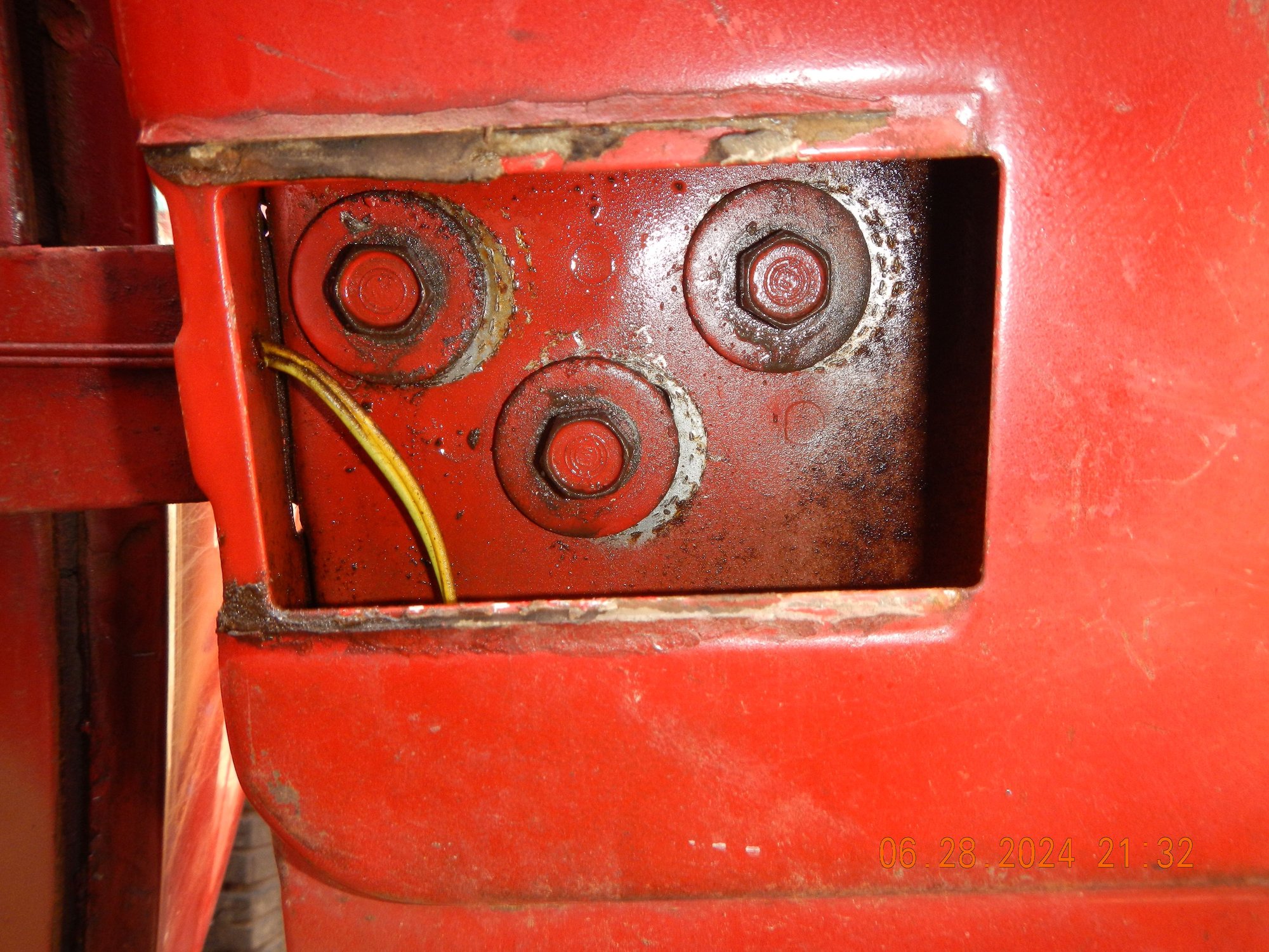

Just got back from working o the truck today. More undercarriage Corroseal application, Adjusted the passenger door and now the door shuts easily. First I put the jack under the door and lifted it about and inch or so, the whole truck seemed to move with the door which is a good thing telling me the door hinges/mounts are solid and no rust in there. I went straight to the 6 in-door hinge bolts, loosened them and I thought i could see the door ever so slightly move upwards, wasn't sure but tightened down the bolts, lowered the jack and the door shut very well so I think that door slid upwards just a very little bit but enough to make the difference and the door shuts easily now. I will add pics to todays thread here when I get the pics onto my computer.
Before loosening the 6 door hinge bolts
After loosening the 6 door hinge bolts, hard to see if the door moved up in the second group of door hinge bolt pics but it must have because the door shuts much better now
