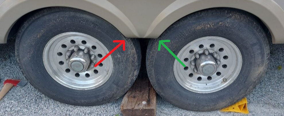

Stopped by my local go to mechanic/tire shop today for something unrelated and ended up talking to the owner about my TT and right off the hop he said trailer tires should be swapped every 5-8 years dependant on wear of course and when I mentioned that my TT has 13 year old tires on it his eyes bugged out lol, but when he heard that they were radial LT A/T tires and NOT actual trailer tires he said that's a whole other ball game. Showed him the pictures of the tires and he said every shop in the world would of course recommend fresh rubber to make a sale, but if it was his trailer and he had to do a 2500km trip he wouldn't think twice about using these tires and If I want to be overly cautious just buy 2 fresh China bomb tires on rims from Princess Auto/Harbour Freight and If they end up not being used just return them afterwards and don't drive faster than 105kph/65mph.
Was also told because tires are rated for 3042lbs each and TT is 8500lbs tire pressure of 70-75psi would be fine instead of the max 80 and AT tires have much better side walls compared to trailer tires and truck tires on travel trailers have WAY less blowouts compared to TT tires.
Thoughts fellas?

Decent LT tires probably age better than cheap trailer tires. Having spares would be good. If you keep an eye on them, I could see it going okay. I wouldn't trust 13 year old tires for normal use on a car or trailer, but if you keep watch and be careful with them, they might hold up fine. I would avoid all tight turns as that stresses the tread and sidewalls, and maybe go 55MPH/88.5139km/h to keep them low stress. What I see of them in your pictures doesn't have any obvious signs of impending doom. What I don't know is if they've got any trauma in their extended history. Either way, you should probably pick up that hatchet before you start driving:
