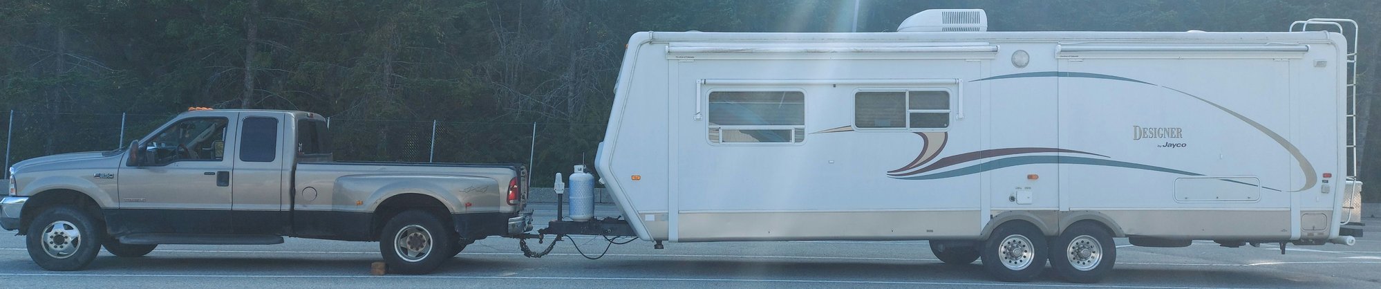

Camper currently has 235/85r16 HT tires on it from PO and I'm looking to replace and just wondering what sizes would be ok use? Dry weight is roughly 8500lbs and just curious what sizes will work so I'll have more options to choose from. Thanks

Those tires are so close together that I would not go bigger. With centrifugal force involved, they might even rub some at speed.

Those tires look a little big for the trailer. What size does the Mfr suggest?. If what you have on there is what the Mfr specifies I would not go any larger because I would be very concerned with potential clearance problems. Make sure that the load index for the replacement tires are high enough to support the weight of the loaded trailer, probably at least 110.

The gap between tires is roughly 2 inches and PO towed the unit to from BC to Arizona every year without issues, but I have no problem stepping down in size.

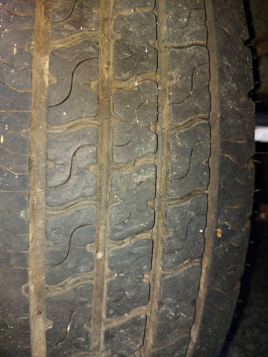

What are the brand, model, age, weight rating, etc. from the existing tires. They may be more up to the task than a cheap new tire?

They're 13 years old unfortunately. Dean Wildcat H/T radial(LT)load range E/10 ply is what they are and even though I see no cracking or dry rot due to high humidity of BC they're still OLD lol. There's a chance they make the 2400km trip with no issues and there's a chance one or more explodes en route and from what I read there's a chance a China tire will blow up as well, but probably a good idea to go with brand new tires.
