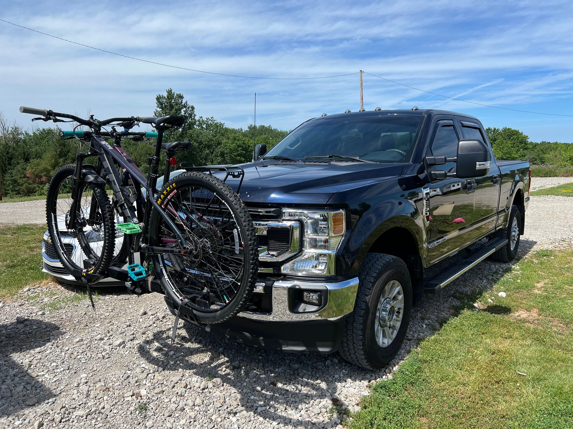

I chose the hitch where the receiver is behind license plate. With it that high, I did not like looking thru the bikes on rack. I had a local welder make a drop section (its orange in picture). That moves the receiver down to where the other hitch would be, but I don't have a cutout in my airscoop and don't worry about low curbs
. As you can see, the bikes crosstube is a hair below my hood line so I look thru the seat of one and handlebars of the other. Its not ideal but I really got used to it. What do I like ? I have my bikes. They are very simple to remove from rack as this rack is lower. What do I not like ? Endless "stuff" in the air gets deep into gears/chain/shifters. Pulling into parking spaces you must account for extended nose. We always removed the bikes before parking but the hitch still adds length up front. I wanted to get a cover for them, but was too concerned about blocking airflow into grill. Also the cover would likely block my view let alone be a constant flapping distraction. Would I do it again ? Yes, in a heartbeat.
My bikes are around 55 lbs each. My rack is a "Kuat Transfer v2". I installed the hitch myself and did remove the bumper to install. Its a "EchoHitch", etrailer part #: 306-x7904.
