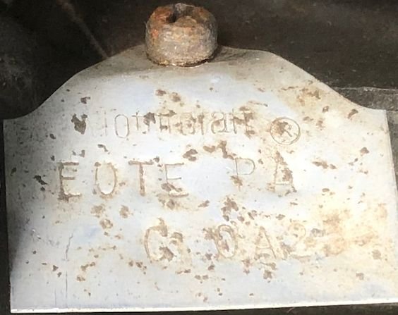

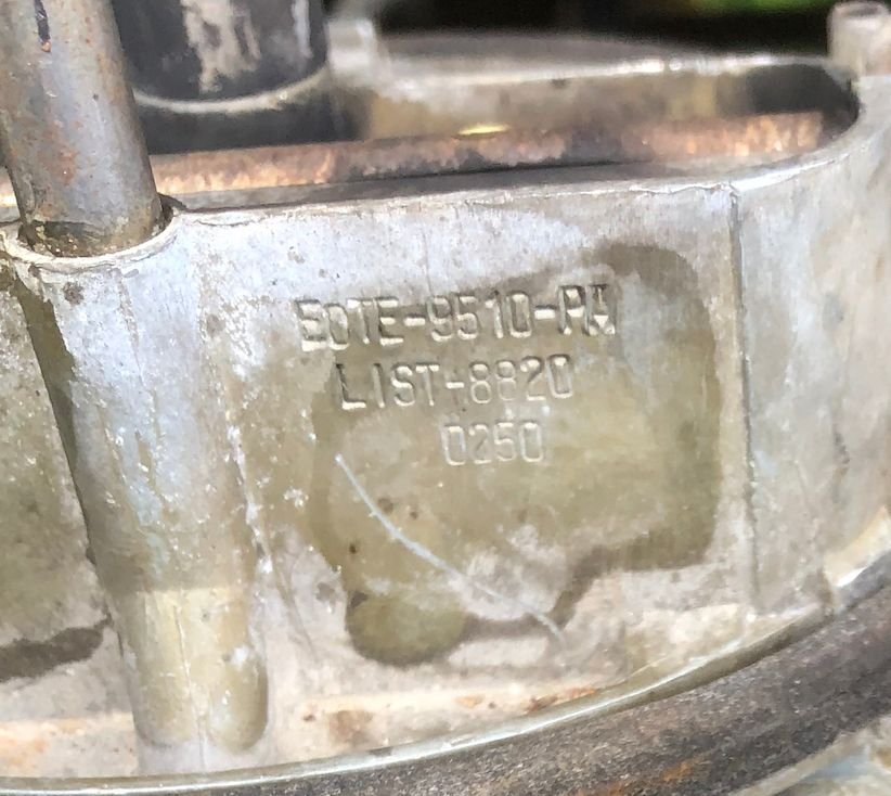

Carb ID as you can see in the pictures. E0TE-9510-PA LIST 8820 and then whatever the tag says C 0A25 ??
I found a similar question in the forum and the person was told the part number for a rebuild kit would be FOPZ9A586D, is that correct?
So I understand that it's a Holley made for Motorcraft? How come when I search for a List 8820 on the Holley page I can't find anything? And what does the C 0A25 mean?
Would you guys know where I can find a parts diagram for that carburator?
Thanks.
Engine is a 370 2V.

Were you looking at this?
https://www.ford-trucks.com/forums/7...1988-f700.html
I think the kit you list is correct.
You can call these folks for more support:
https://www.carburetion.com/CarbNumber.asp?Number=R8820

Yes I saw these, the post you mentioned helped out a lot. =)
