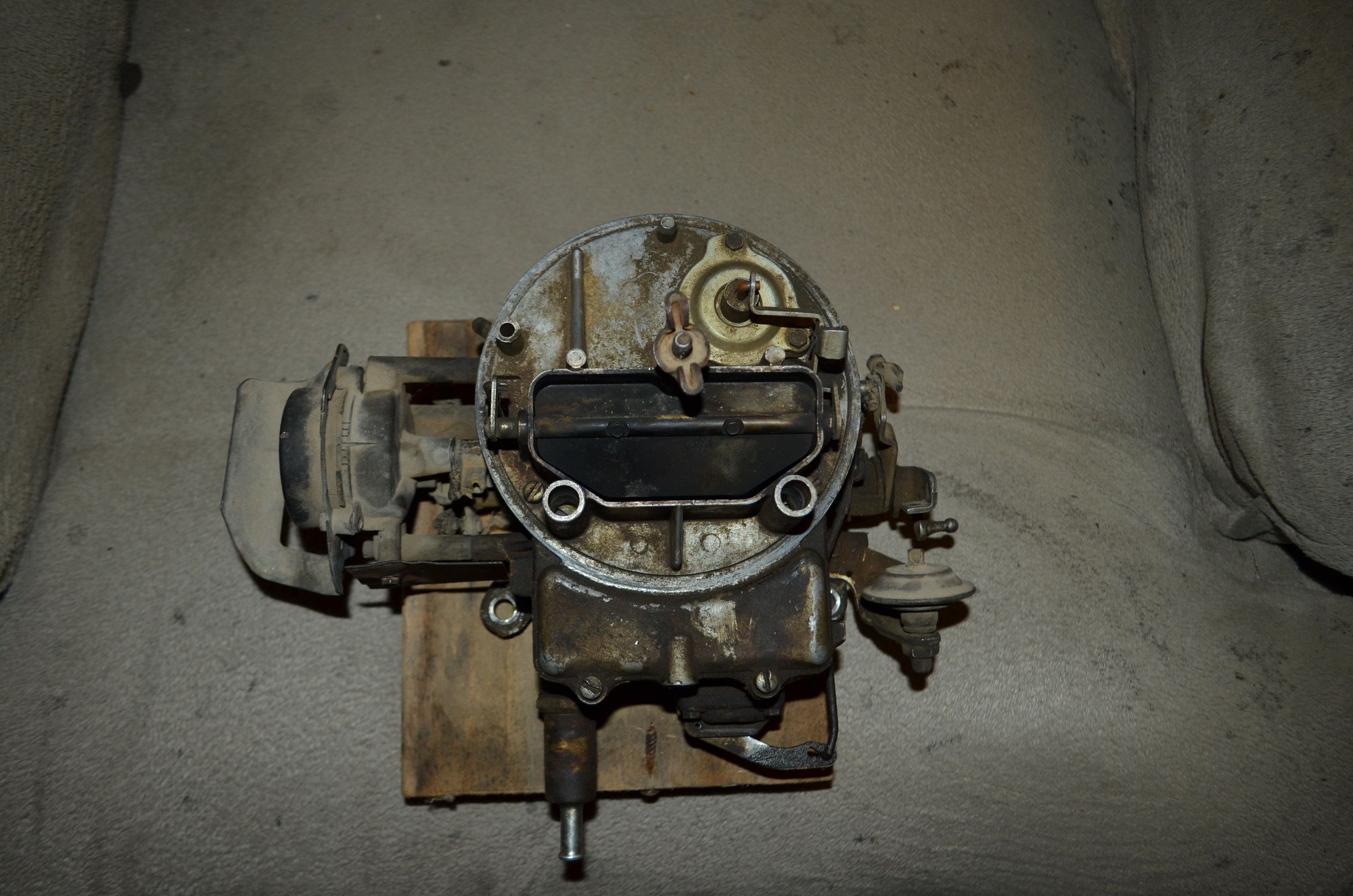

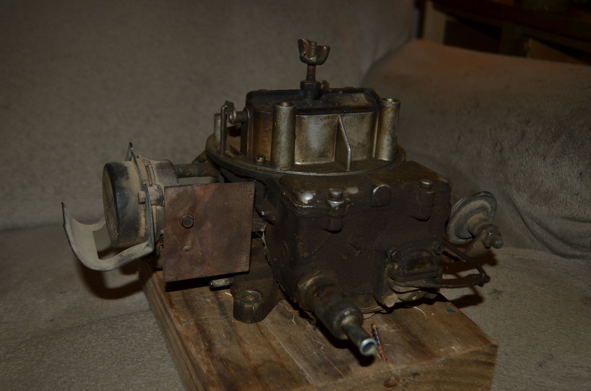

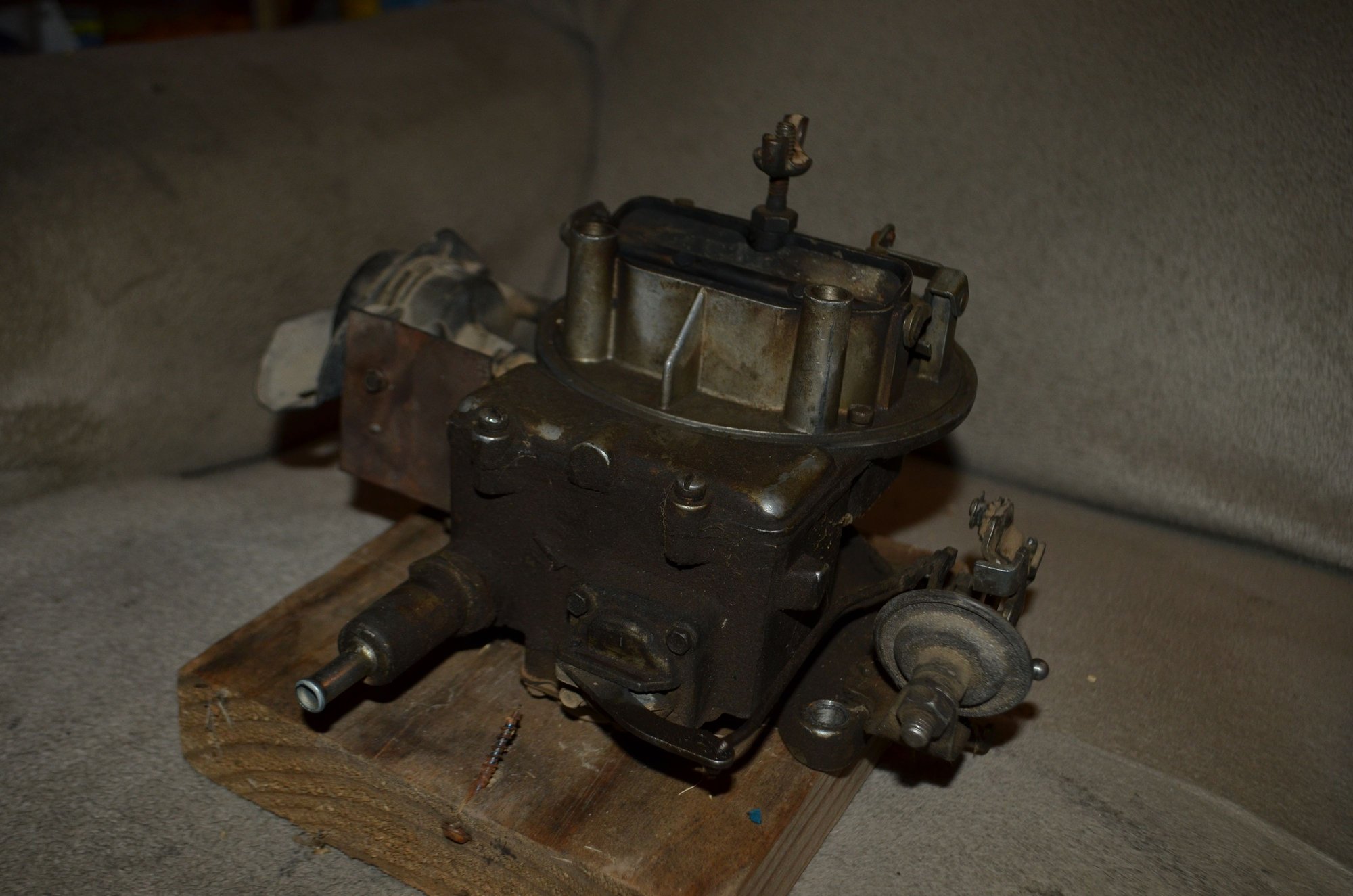

I took the carburetor off the 360 in my 1973 F100, to clean and slap a kit in it. But the ID tag is gone, all I know it's a 2150, only markings are "Autolite" on the choke cap.My question is how can I buy a kit with out the carb number off that tag? Are there any markings elsewhere on it? Attaching photos of the carb off my engine

Of it's the oem carb just search for a kit by model and year.
Most kits cover several variations of the carb.

Just an example ... but you can see a few kits here, and pictures, and if you click on the blue part number, you'll see a kit has wide spread application.
1973 FORD F-100 5.9L 360cid V8 Carburetor Repair Kit | RockAuto
There's a good chance your local auto parts stores have some in stock.

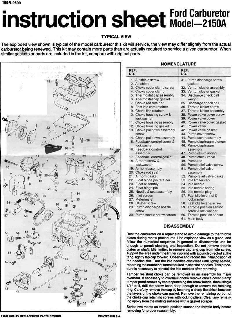

And once you find the kit maybe this will help.

  • I've used Walker Products carb kits for decades. They always have everything I need and have never let me down. They are available through RockAuto and many local auto parts stores. Based on the parts that come in the kit and looking at the exploded diagrams, I suspect the same kit is used for both the 2100D and 2150 carb families.

  • The rebuild kit will come with a detailed exploded diagram, but it's a little small and a little generic, so I recommend snapping plenty of detail photos of the carb as you disassemble it. Makes reassembly much easier.
