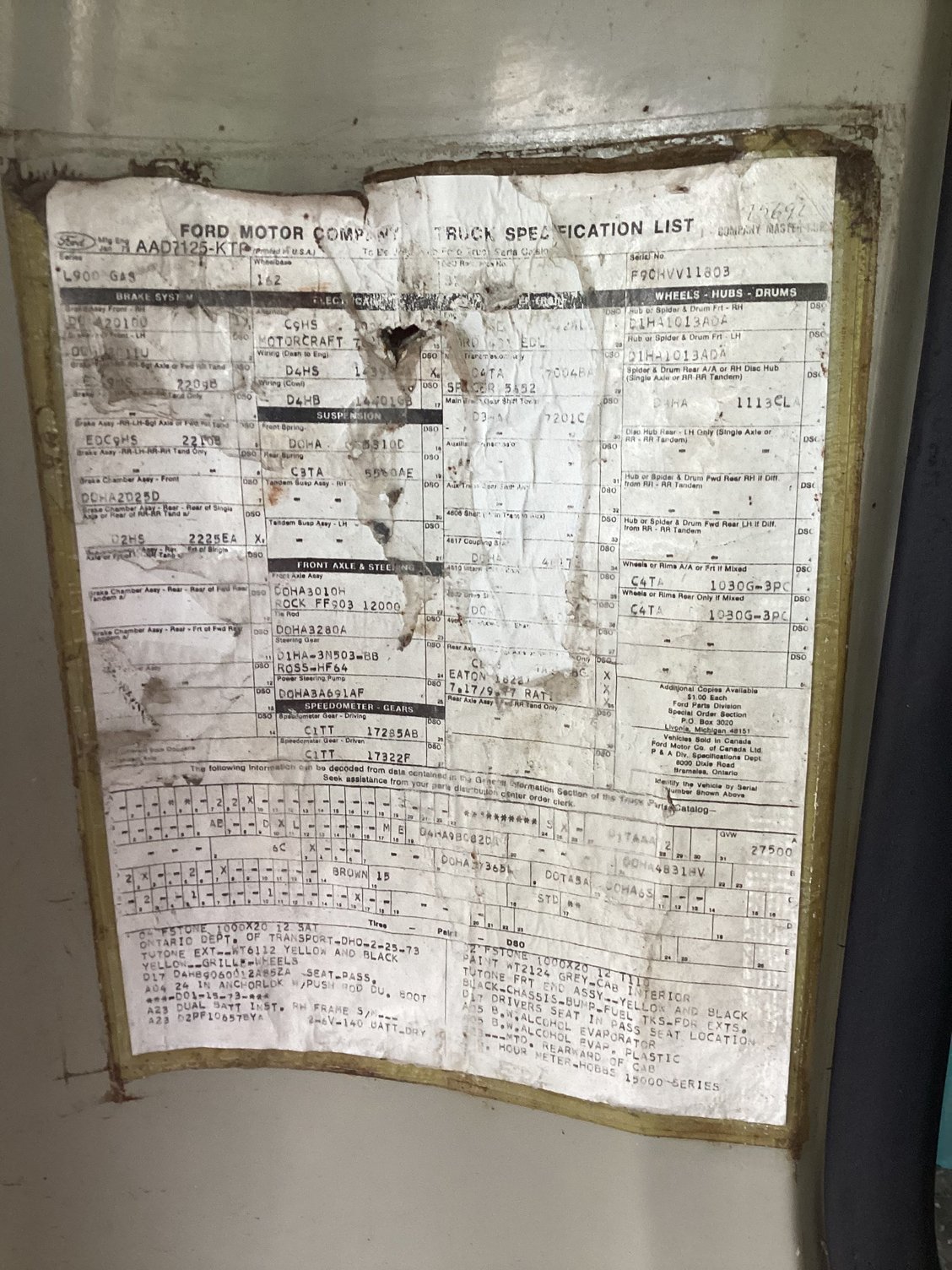

EDIT: Build sheet (see post 7) shows yellow and black.

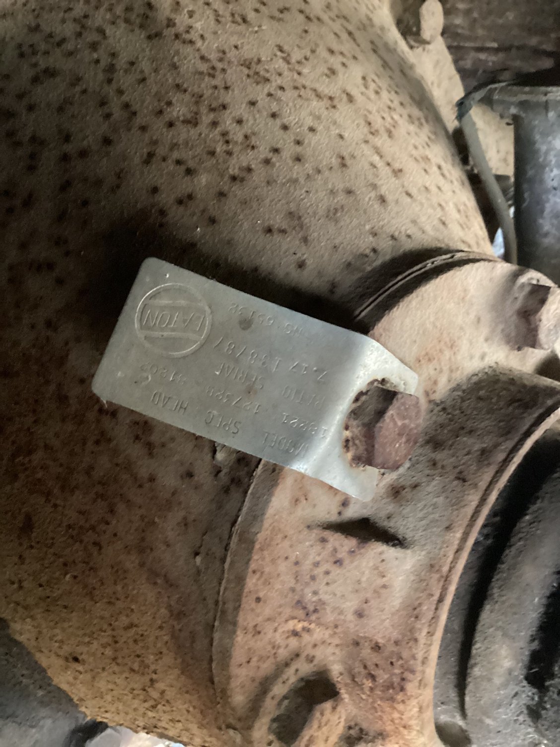

EDIT: From the build sheet & tag in post 7:
Eaton model 18221 two speed rear axle, 7.17 / 9.77 ratios.
Even though it appears to be a special order item, that model axle was listed in the MPC for this year truck with a capacity of 22,000 lbs.
(note correction of axle info)

EDIT: Build sheet shows "alcohol evaporators), which are air brake components.

Here is more info,
I am not a big truck guy, is this enough info to tell me how much load this can haul?

I updated the decode based on the extra info.
As best I can tell, you have 34,000lbs of axle capacity with a 27,500lb GVWR. Either we're missing info or something is "wrong" with that combination. It would be unusual for a manufacturer to make an error like that as it's so obvious and dangerous.
Note correction.
To determine capacity, we need to know the tare weight. We'll again pretend it's 12,000lbs. You will have to take it to a scale to determine the weight.
So, 12,000 lbs of gravel is 3 to 5 yards, depending on wet or dry etc.
Your 12 foot dump is good for 4 to 9 yards, so you could overload it pretty easy.

Just curious, where does the 24000 come from? I see the 12000 front, is the other 12 from the axle tag? I see the 27500.

Sorry I need to edit my posts as I failed 1st grade arithmetic.
You have 34,000 lbs axle capacity........

Sorry, This stuff always confused me. Looked at trucks like this online and could never figure out what a trucks capacity was. Where do you see the 22000 rear?

The Eaton model 18221 is listed as a regular production option for trucks in the '73-'79 Master Parts Catalog and in the '75 shop manual. The ratios vary, but all are listed at 22,000 lbs capacity.
Your warranty card doesn't show the axle code. Usually that means the axle is special order item. Hard to say why it was done that way.
