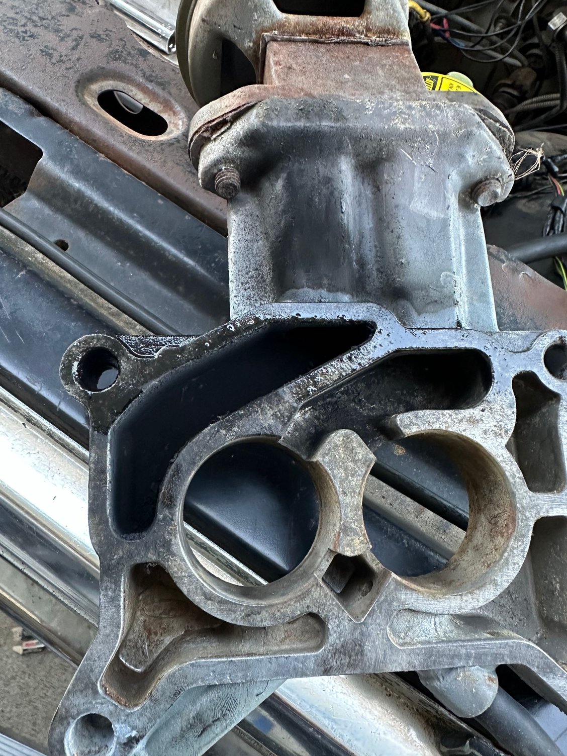

Does anyone know if I need this? And if I do, is the carbon buildup in one port normal?
Its an hei system

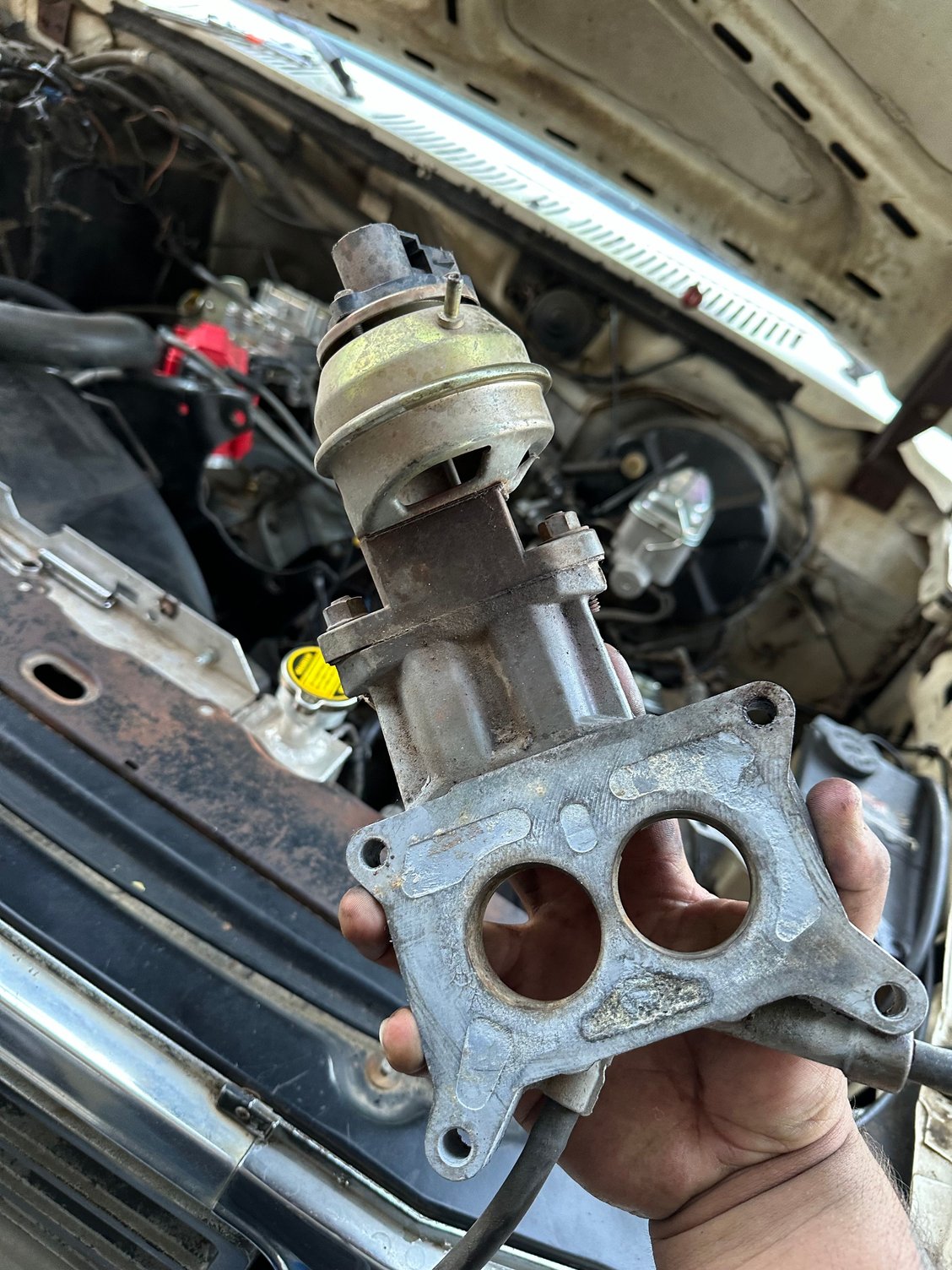

That's an EGR device. Does one of the rubber lines run to the PCV? If so it's dual purpose.
It can be "removed", but you'll need the PCV part and you will have some fiddling to do to make it run right without it.

it’s got 2 hoses in the front. Ones plugged the other is going to the hei distributor

The EGR spacer plate you have there uses the vacuum to pull open the EGR valve, which allows exhaust gasses to flow from that 'carboned' side to the other one that feeds both carburetor bores under certain engine operation conditions. Note that those exhaust gasses are hot, so a special high-temperature gasket is used on the manifold side. A thick-ish (~1/4" thick) 'regular' gasket is used on the carburetor side.

Keep the part your hand is holding, the actual spacer. See the two bolts holding the gold thing at the top? Take those two bolts loose, take the gold thing off (the EGR valve itself) and make a metal plate to block the holes where the EGR bolted on, you can use the original EGR bolts to hold your block-off plate.

take the gold thing off (the EGR valve itself) and make a metal plate to block the holes where the EGR bolted on…
I blocked off my truck’s EGR system in a slightly different way. I left the valve, but next to the gasket I fitted a thin sheet metal plate.
As a bonus, it retains the stock appearance in case of a visual inspection at the emissions station.
