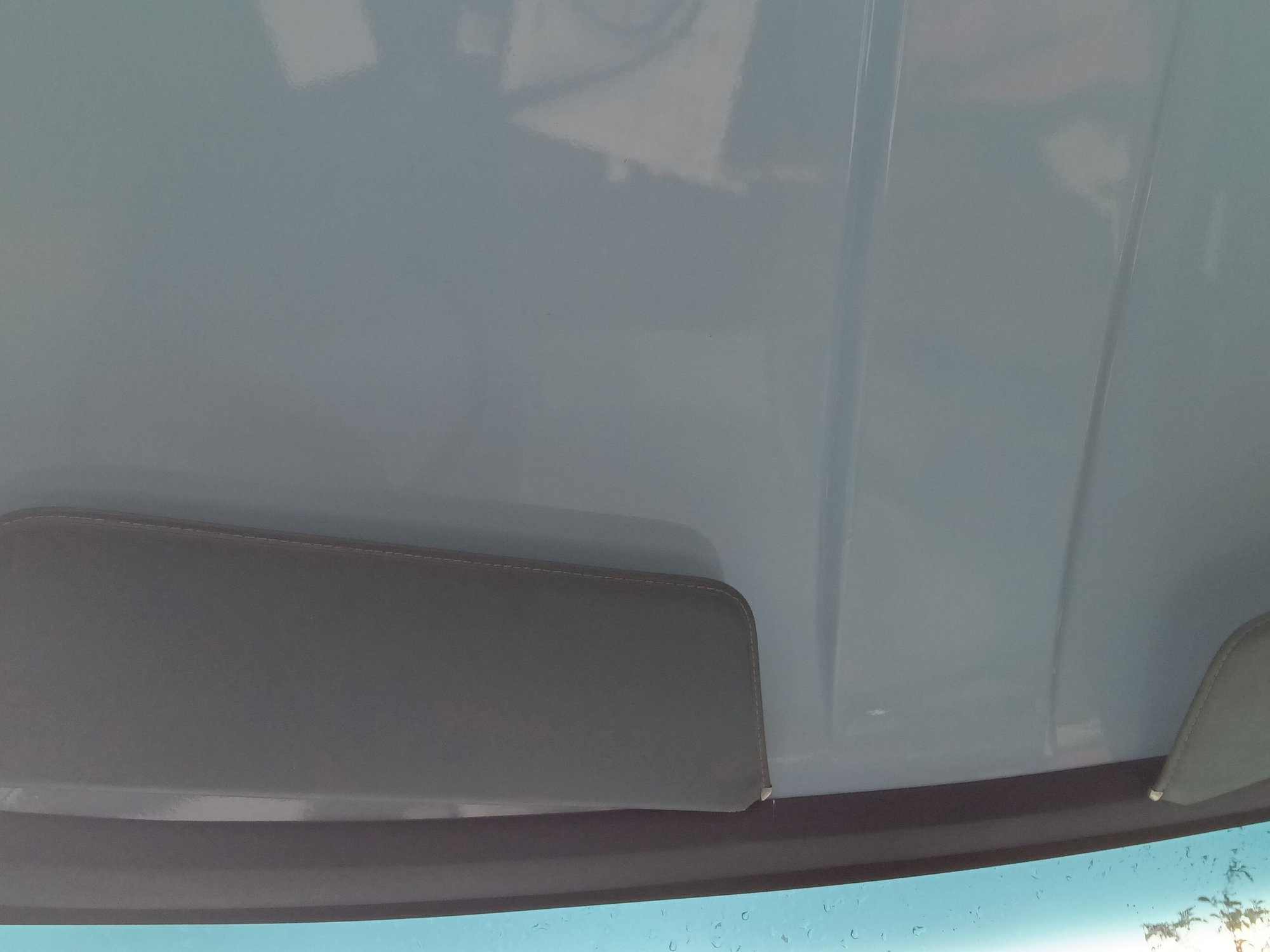

Roof
Picture of cab roof without headliner.

As the others mentioned, if you install the radio on the roof make sure you use short self-tapping screws where the roof has a double skin.
Either run the antenna cable along the top of the roof to exit out the back of the cab. Or, exit the cab under one of the doors.
BTW, where did you want to mount the antenna? Center of the roof is the ideal location.
