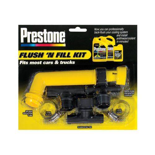

Off the top of my head:
First step: Backflush the system. I use the Prestone "T-kit", and flush, both available at places like O'Reillys, NAPA, etc
Second step: Check the radiator cap. You can rent a tester at the same places I mention above. (In fact, take the cap with you when you're shopping for the backflush goods.)
Third step: If neither of the above helps, have the radiator boiled-out. Just because it looks good doesn't mean it's not plugged internally.
Fourth step: While the radiator is out, that would be a REAL good time to replace the water pump.
Those are the initial things that come to mind.
Oh! And all are assuming you have no leaks anywhere, such as the thermostat housing, intake manifold, etc.
Good luck!

When you use the Prestone kit, is it necessary to pull the thermostat? And before you flush the system do you run any of the additives to help the cleaning process?

It all depends, sorry. I would leave the stat in-place for the flush, and replace it afterwards, if you feel it's questionable. Why? The system will need to be drained post-flush anyway.
(Heck! I'd probably replace the stat anyway, just as a matter of course, as the system is already drained...)
As for the flush cleaner, I think (but don't quote me on this!) that most flush chemicals recommend that you drain the system, and then fill with clean water, so the chemical(s) has/have a better chance of doing its thing.
So two items at NAPA/O'Reillys/Autozone: Flush "T" kit, and flush solvent. (Oh, and maybe a t'stat and gasket.)

Also, I've been using this same flush kit for 40+ years now, and it's never failed me yet! Hopefully they keep making it for another 25 (I'll be 85 then, so....).

I can also confirm the Preston kit posted above does wonders. My dad got one for his 4L Jeep Cherokee decades ago and we still use it to this day. Other things to consider, the coolant most likely is no longer working as it should due to degradation. Another thing that could cause it to run hot would be the timing is advanced too far.
