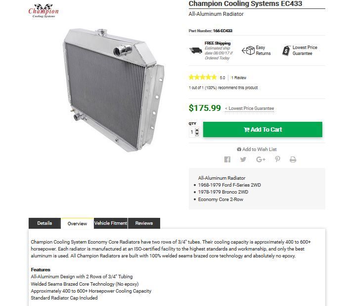

Obviously I'm replacing my radiator soon (running a tad hot in stop and go). Is anyone running this one? Suggestions?

I have a similar one in my '63 f350. I don't really have any miles on it yet but I was impressed with the fit and finish and the price was unbeatable.

Note that it's only a 2 row. Champion makes 3 and 4 row units also.
My next one will be a 4 core, with a high-flow Pump and thermostat. Things get hot down here in the cactus patch. My 3 row radiator can't quite keep up when it's 115 or more.

I have the three row Champion in my truck. The install was easy. I got the rad and the two 12" electric fans with wiring cheaper than I could get my original rad re-cored up here. I will say that their electric fans do not move enough air to keep the truck cool if your stuck in traffic. I would definitely recommend the rad.

I forget what engine you have, but the FEs will run hot is stop n go traffic. Your answer is dual electric fans. IMO

imho get a 3 row minimum if you are running a little hot now .

I run the Champion 3 row for my 351w, no electric fans. Works great, temp good and install was straight forward. I've had the radiator about a year now.

The truck has a 360, and the rad looks original.... its old. Thanks for all the info!!!!
looks like i will go 3 row and see how it does.
