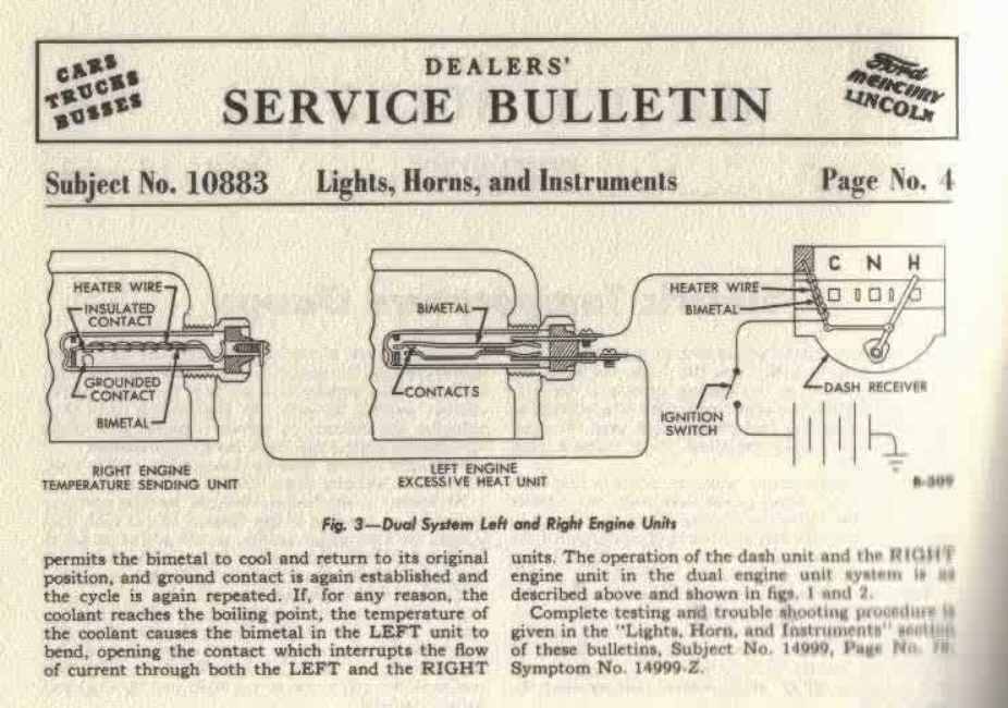

The thermostat sending units are not ohms/resistance based. The two terminal sending unit is strictly an overheat open circuit type. The single terminal is what actually measures the temperature for display on the gauge via the King-Sealy Distometer communication style.
Being that you have a heat differential between the sides, I'll agree with the others that you should check the thermostat on the problematic side.
