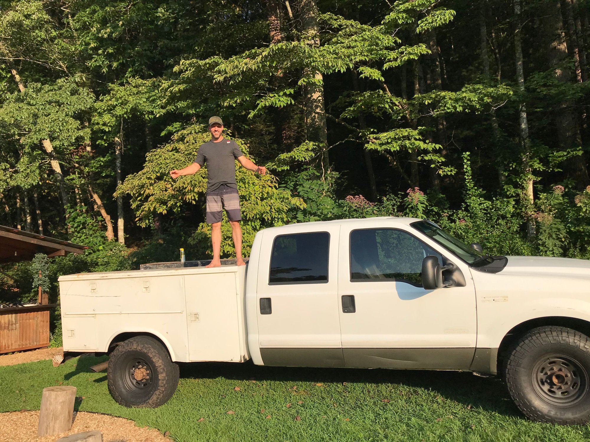

I’ve done a bunch of these swaps. 5.4, 6.0 and 6.8 to 7.3.
The only way to do it ‘right’ is a 100% wiring swap. I do not cut or splice or improvise ANYTHING. When I’m done, you can use the factory service manual for the donor vehicle to diagnose any issue with your 2007 7.3 PSD truck or Excursion.
This is the latest one. It was a (cheap!) E99 with a clapped out 5.4 that now has a 2000 7.3 heart.
