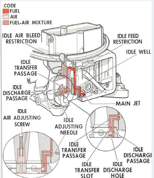

This is what I presume the air bleeds are. I also don't believe gas should be pouring out of these after shut down.
Not heat soak.
I can start the engine and immediately shut it off causing some kinda siphon effect to fill bowl, and into engine through the above marked ports

That looks like a Holley 2300 v2 carb that comes in a 350 & 500 cfm models.
I have run s few of them in the past, over 10 years ago now, with out any issues.
I got one on a 304 AMC v8 and my son on a 258 Jeep motor.
It is half of a Holley v4 carb and take the same parts.
It is strange it is coming out of there. I dont know what bleeds they are without pulling out my Holley books if I could even find them.
https://www.google.com/search?q=holl...client=gws-wiz
The only thing I can think of ATM is to make sure the bowl vent is open to vent any psi that may build up in there.
The bowl vent should be the hole to the right of the choke plate / shaft.
You will need to pull bowl off to make sure it is open or maybe try blowing down into that hole?
Thing is the psi would not have anywhere to go as the float should be closed if the bowl is full.
I like to pull the bowl off and stick something down the hole and see if I can see it in the bowl area.
I dont think the carb would have a vent whistle from the factory unless it was a Holley HP carb and even then I cant remember if mine had one or not or I added it?
If the vent is open fuel should not come out them other holes, only out the vent up higher.
Maybe the wrong gasket(s) were used?
How old it the carb? Has always done this but just now looking into the cause?
So beside this you also have the fuel level going higher when motor is hot and just shut down and the high level why the holes are spilling fuel that should not be.

Still dose not answer why fuel comes out the idle air bleeds as per the link above?
As a WAG a wrong gasket was used or not sealing that is letting fuel, when the level is high in the bowl to flow out the air bleeds.
The carb would need to come off, apart and looked over closely to see where the bleeds come out on the carb base, the metering plate and float bowl to see if you can tell why it is happening.
I dont know if I have any Holley's I can pull apart to see if I can tell on my end as that part should be the same on all Holleys

I found this on line at FEPOWER.NET https://fepower.net/simplemachinesfo...?topic=10270.0
If I am seeing this right it looks like a combo of bad gasket and no bowl vent?
The heat makes the fuel boil and the psi go up.
No place for the psi to go as the bowl vent is not working so the psi pushes out at the weakest point, a gasket.
I dont see any other way with out the carb in hand.
Dave ----
