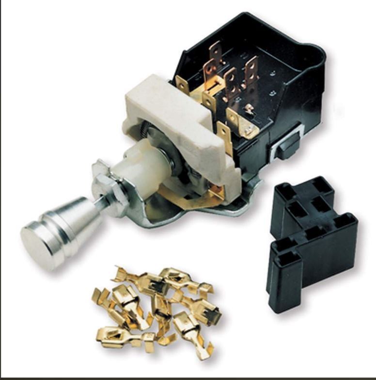

I've got a Ron Francis headlight switch that is internally bad... will not give me power for tail lights. I can bypass the switch and I have lights
Their replacement is 50 bucks & ship-.. Anyone have an alternate option with a good switch.
Had it since 2017 and I bet it hasn't been used 15 times... I just don't drive much at night
here's what I have

That looks a lot like this Camaro switch. I think Ron uses a lot of GM stuff for his stuff, so it might just be. It's likely available locally, or from Year One for a bit less than RF's. After reading the description, this may not be your exact application as it says it's for RS hidden headlights, but it might get you in the ballpark of what will work for you.

To me that has the look of a GM switch. Most switches are the same (internally). The big differences are in the length of the ****, and corresponding mounting bracketry. I would think most any GM switch from the mid 60's though early 80's would probably work.
