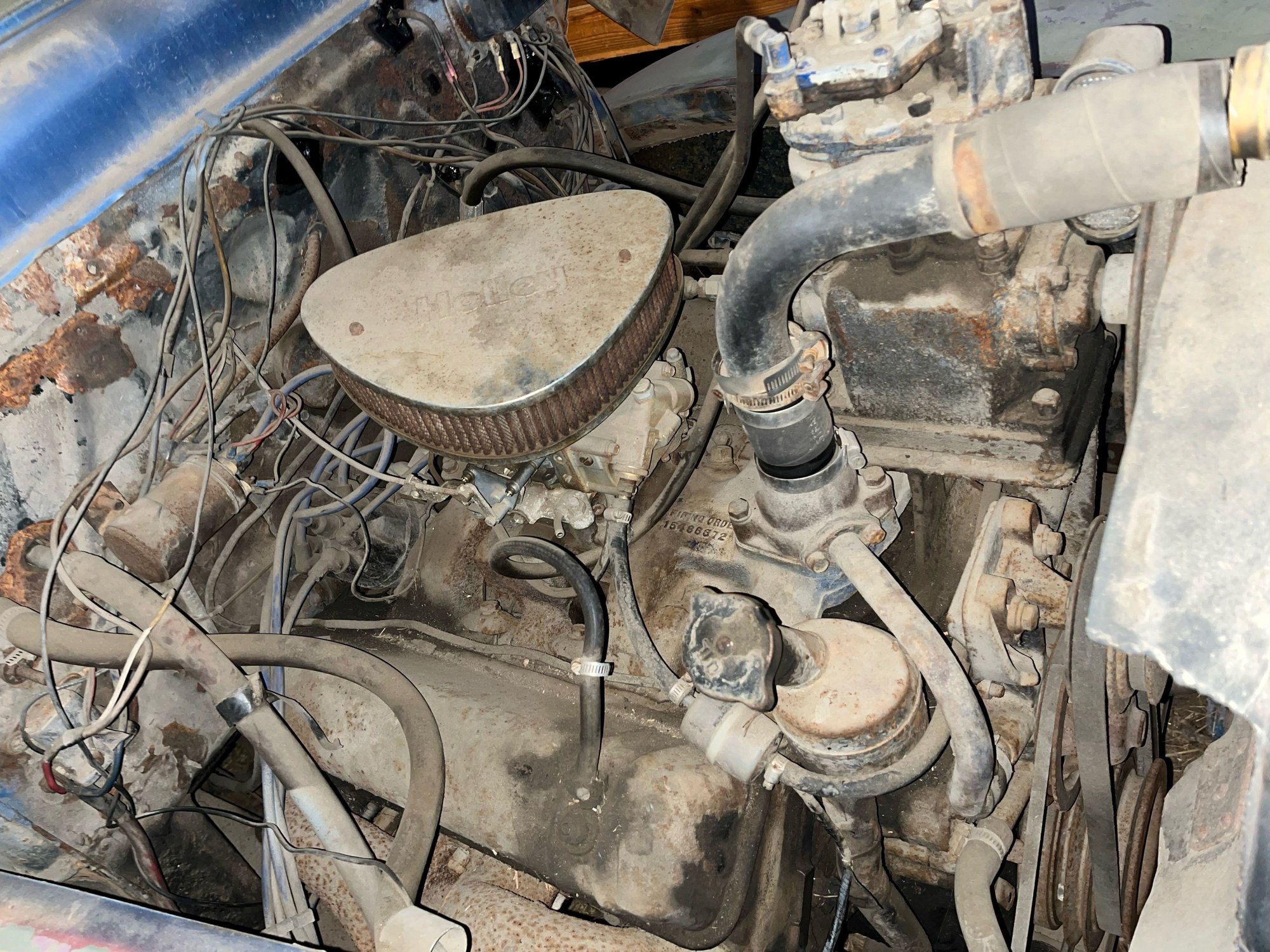

I have a '46 1.5 ton which at some point was converted in to now what I believe to be a 1972 FE engine, and am considering a diesel swap for either a 4BT or a 6BT.
Is that as silly as I worry?

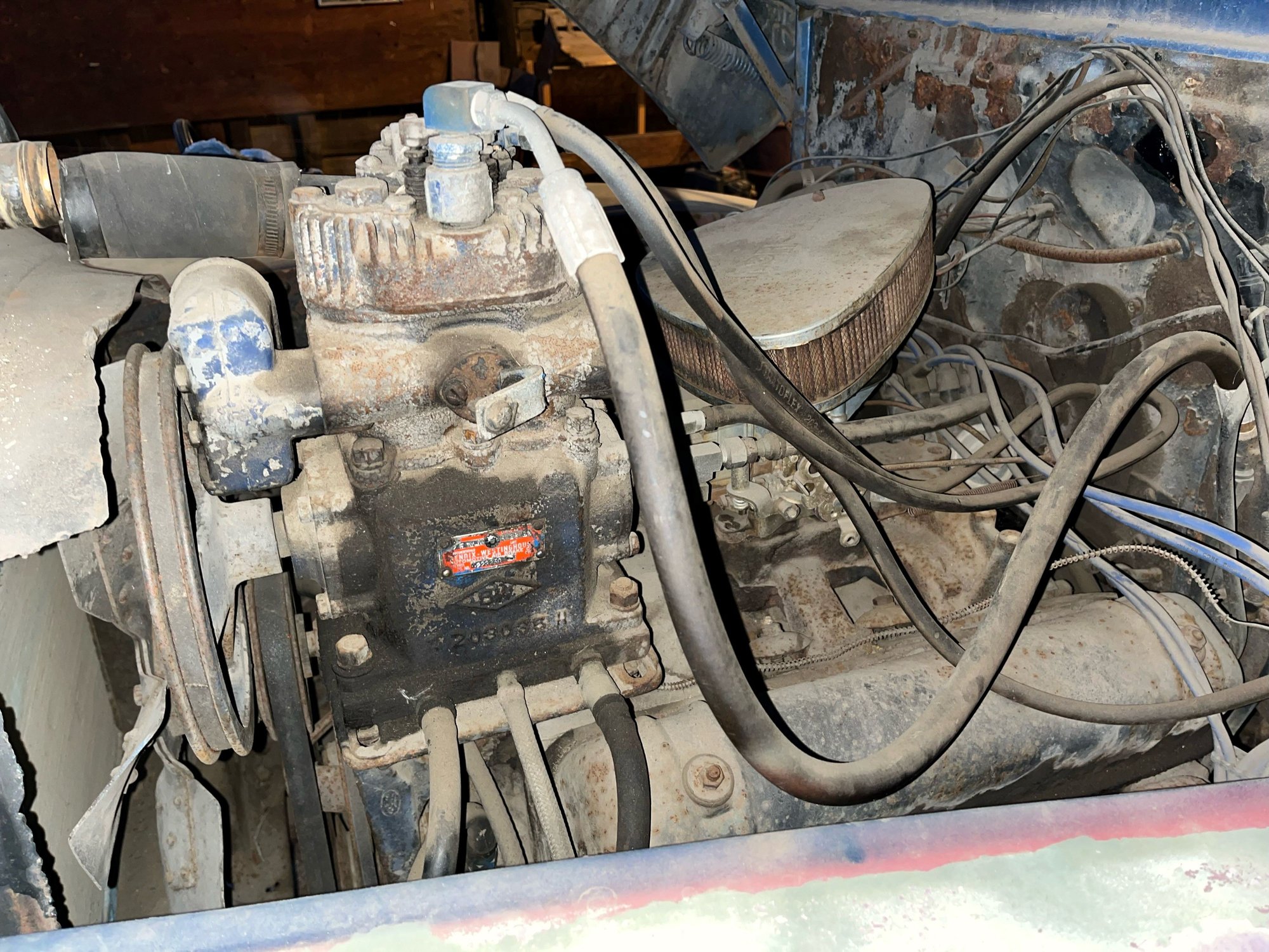

BUT! I want to make it shine. The air brake system afterfitted with the air horn on top is too tempting.

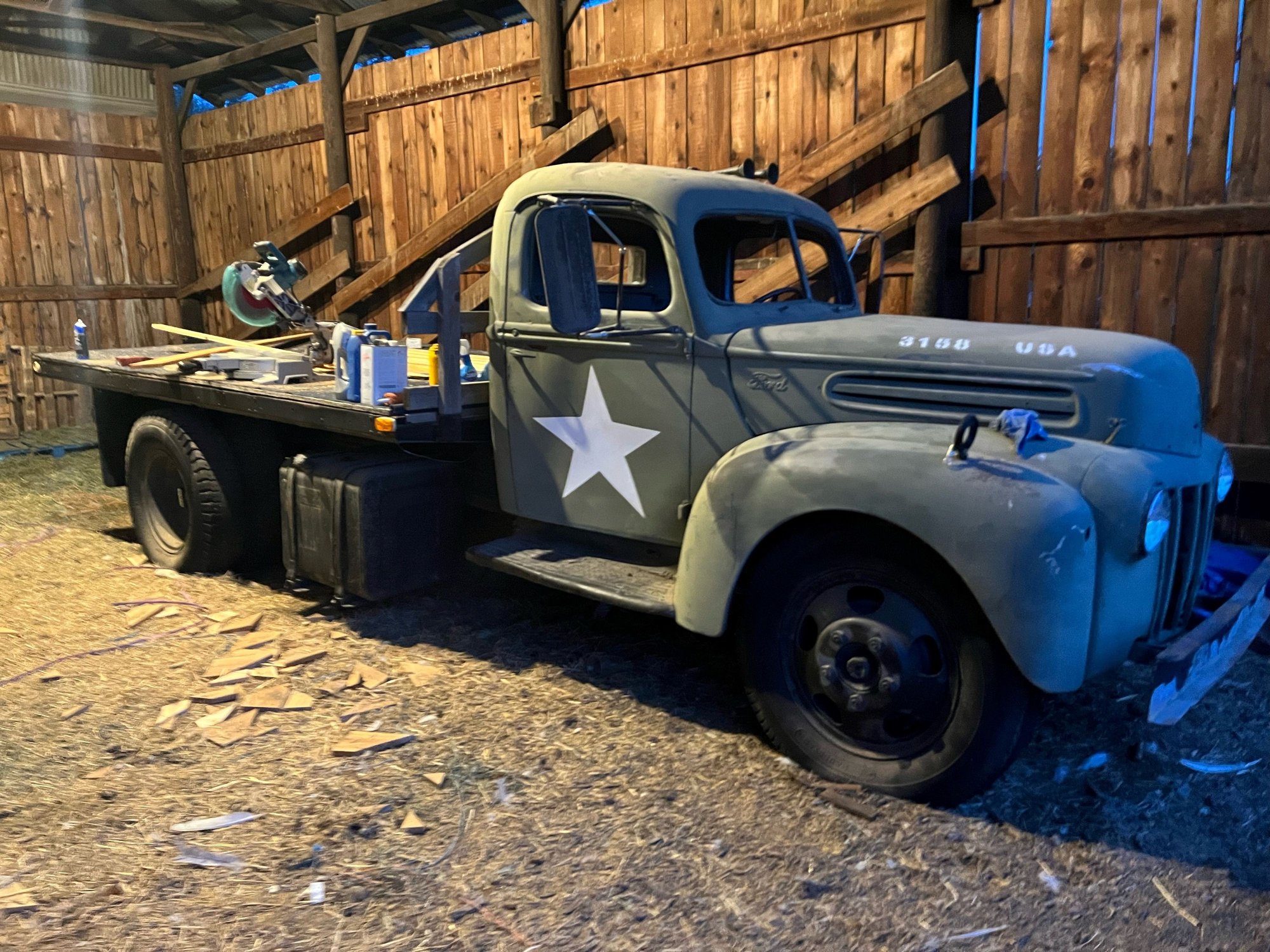

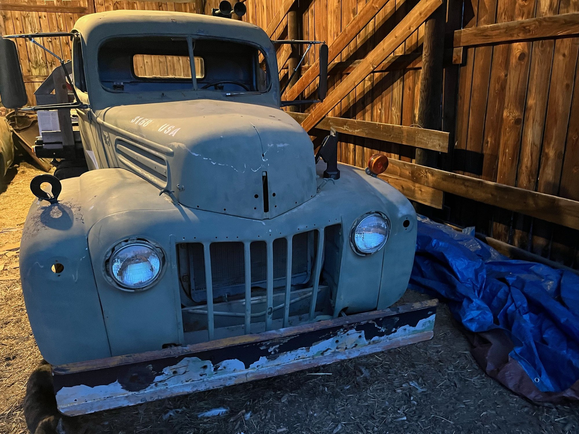

pictures
And here pictures.
I am unsure yet the original color - the inside of the cab is a sparkling blue, the frame is Mr. Ford's favorite, and the exterior has been repainted in OD green at somepoint in the last 20 years I think
if the gas tank says anything about its efficiency...

welcome looks straight !!!

I like big old ford engines. I had a 68 T-bird with a 429 in it, not an FE though. Since it's already in there I'd keep it. What cubic inch is it? What transmission is in there? Looks like a fun project.

Not an FE. Y block maybe.

Just noticed the valve covers.

The 2 nuts fastening the valve covers on identify the engine as a Y-block, predecessor to the FE. I believe in the 50s and 60s the Y-block was used to repower some of the original flathead trucks. My 53 F500 had a Y-block installed by the PO farmer back in the 60s. There are vintage and after market parts available to hotrod them and make them look shiny.

That appears to be the big truck version of the Lincoln Y block, not the Ford version. Note the side by side intake ports vs the stacked ports on the Ford. and the top facing thermostat housing with the pipe going to the water pump, unlike the Ford. The high mount fan suggests something from a big truck, F600 or larger. How they managed to shoehorn that in there is beyond me.
https://en.wikipedia.org/wiki/Lincoln_Y-block_V8_engine

I thought that thermostat looked strange. So maybe not a lot of aftermarket parts. Still a desirable engine, correct? A similar engine identification conversation was happening on the newer forum. Wonder what transmission is behind it.

Well, thank you all for the input! I can’t get down to the sides of the engine to see any of the casting numbers, so in the next few weeks, I plan to takeoff the fenders and the radiator better look. I will definitely let you know what I find! Thanks so much, and have a great week., Matt.
