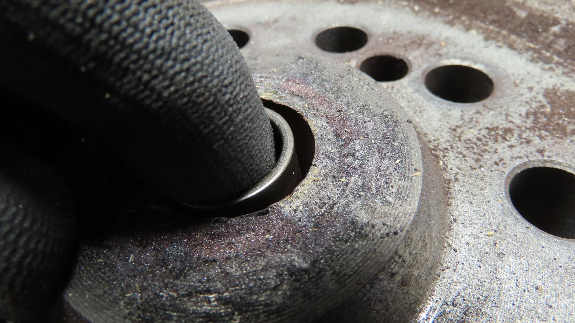

It may be a bronze bushing/repair sleeve pilot bushing that everyone seems to have good results with, but on this truck it's a Gold Medal failure. Didn't even make it 10,000 miles. Two different engines, two different transmissions, five different clutches, three different styles of pilot bearing/bushing. I'm thinking to just get another clutch because this new one now has a ruined hub. And then sell this POS. Pieces of spring laying in the bell housing and it wouldn't disengage from Montana to my home in S. Arizona. Had to start it in gear and shift without using the clutch to get home. I'm out of ideas.

Bell housing is the front half of the transmission body. Had the exact same problem with previous engine and transmission. And the clutch hub has enough give to be able to accomodate a lot of variance.

this time around it’s the second flywheel. Factory flywheel was ruined because I tried a ball bearing for a pilot bearing and it hogged out the part where the pilot bearing goes. Rendering it useless. Bought a new one. Contact surface still looks perfect and every bolt still nice and tight.

Last go round was a new flywheel and clutch assembly. Granted, purchased separately, but they were both brand new. I never put reman clutches in myself. Used to operate an auto repair shop for 40 years, bought everything from my supplier and they carried good brands. LUK, Valeo, Sachs, etc. Three different brands of clutch, three different design theories of pilot bearing from factory design, plastic bushing, back to factory design, now this "bulletproof" bronze bushing. All same result. Hogged out pilot bearing.
