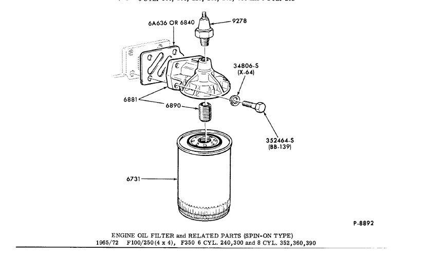

The engine since I bought the truck in '00 (it's a '65 dually F-350) is not the original 352, according to the seller. He told me he thought it was a car 360(? more likely 390). It has a front sump pan, and the oil filter is vertical.

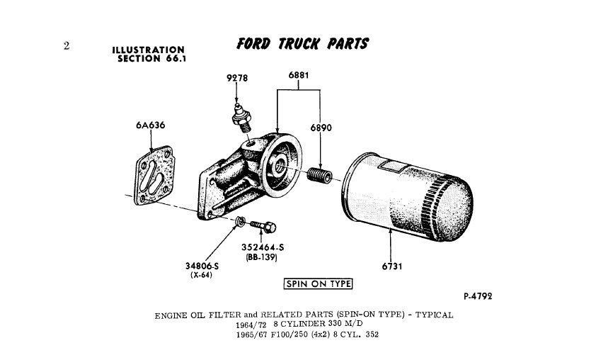

The front sump clears everything by a wide margin. The truck is 2WD, so the front axle is a straight beam (the 350 didn't get twin I-beam until '67 unlike the 100 and 250). The 90 deg. car oil filter adapter also clears the frame rail, whereas it's going to be close if not actually interfering with the horizontal "truck" adapter.

Let's start with the oil filter adapter.
The vertical adapters not only used on the cars but also the 4x4 trucks as well as the F350. Nothing underneath them so plenty of clearance.
C0AE-6881-A - Part originally released in 1960 (C0). The A meaning generic to both cars and trucks.
C5TZ-6881-A - Part originally released in 1965 (C5). The T indicating trucks. But only the 1965/67 F100 and F250 2 wheel drives with the twin I beam suspension (and the 330 M/D in the bigger trucks mostly). With the vertical adapter the filter can hit the large I-beam crossmember, especially if the left engine insulator fails.
