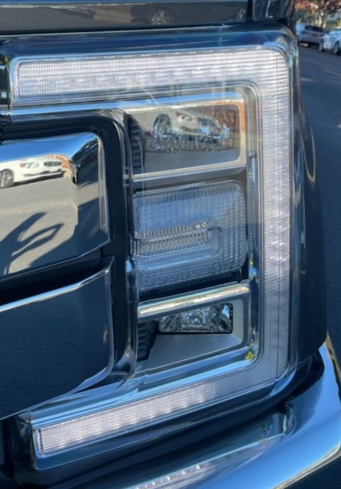

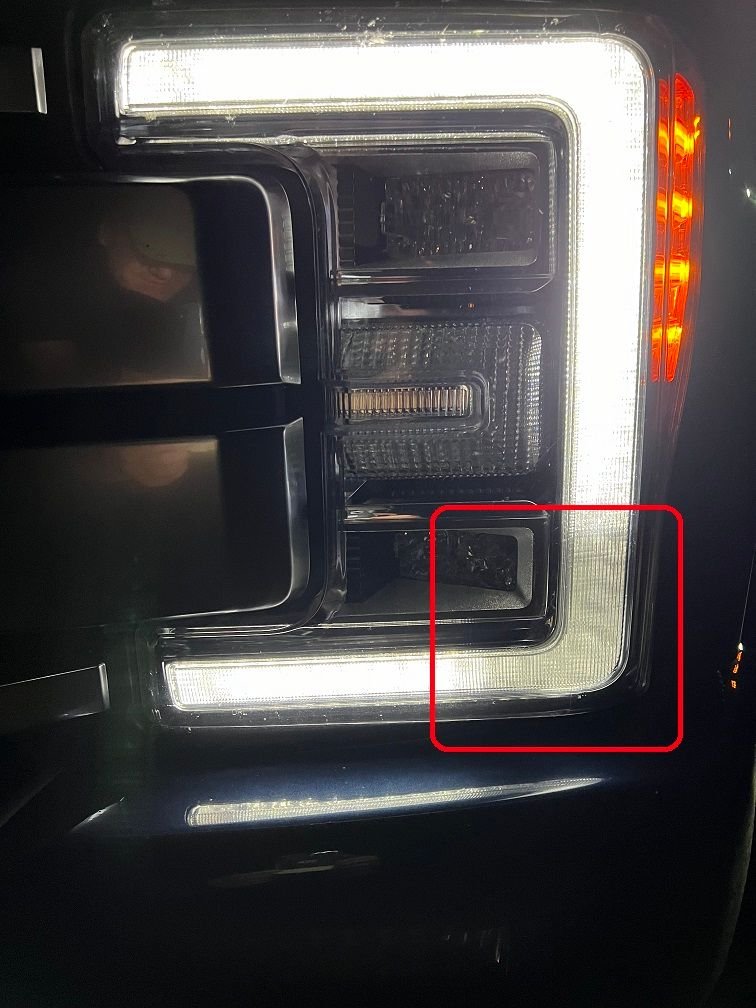

I have a 2019 F350 Platinum with OEM LED Headlamp Assemblies. Recently, I noticed my driver side DRL lamp is not lit in the lower right corner.
Without pulling both out and swapping ballasts, does anyone know if a bad ballast could possibly cause this?
Nearing 50K so I'm trying to determine if a replacement headlamp is definitely required?

I would think it's a single ballast that drives the entire DRL, so I would be more inclined to think it's a LED or a set of LED's that failed.
Probably non replaceable ether.

Pretty sure ballasts are only used on florescent lights, not LEDs, since when you modify florescent lights in your house to be LED you typically have to remove or bypass the ballast.
But yes, there's a few LEDs (light-emitting diodes) in your headlamp assembly that have failed. It happens, they're electrical components and they're not 100%. As to if they're fixable, that would be a question for someone else - I would likely have to just replace the housing myself.

That is the case. The exact same thing happened to my drivers side headlight on my 2019. I was still under warranty so the headlight was replaced.

The same section of lights goes on my driver side light as well. I also have a 2019 F350.. although mine will randomly be lit. I would say that corner will work about 20% of the time.
