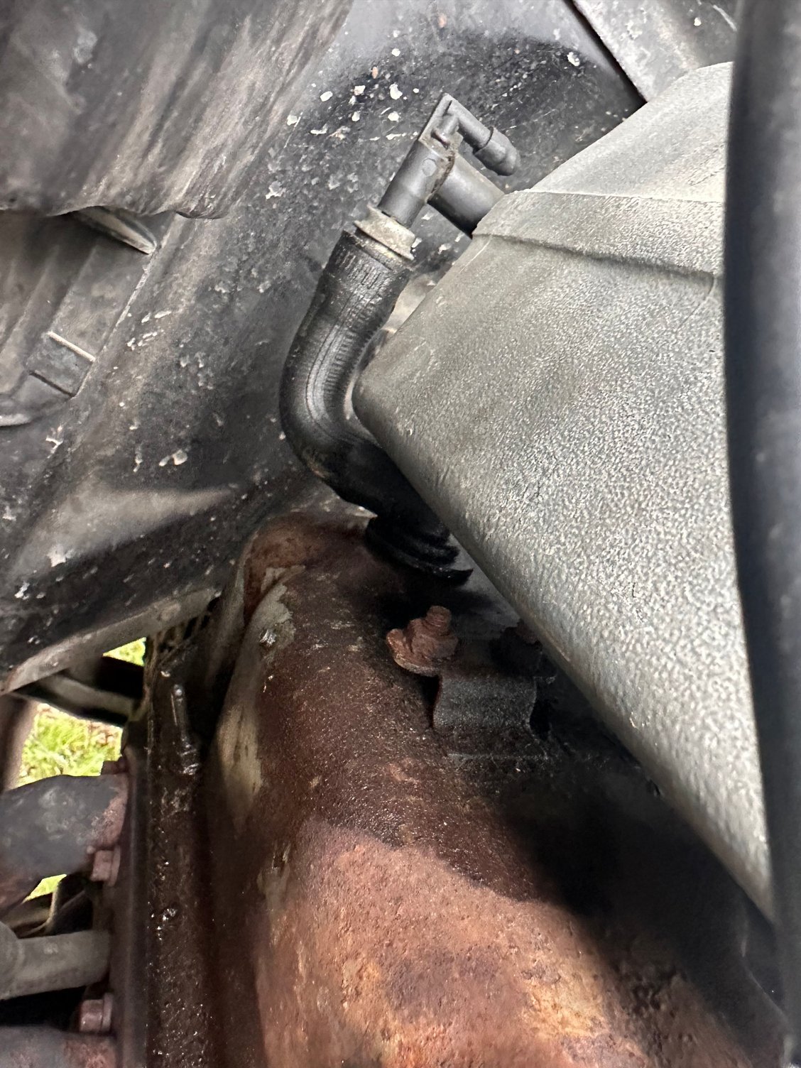

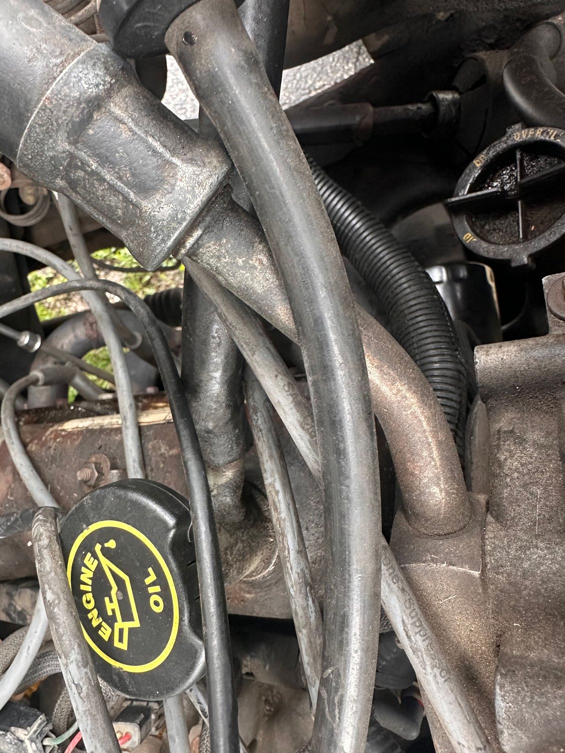

Oil fill cap with the (pcv?) hose that connects to the air box.
This is a PCV… right? (passenger side, connects to upper intake manifold, has a small filter/valve inside.
are you saying the crankcase pulls in air from these two systems, or the crankcase pushes fumes out through these systems?
