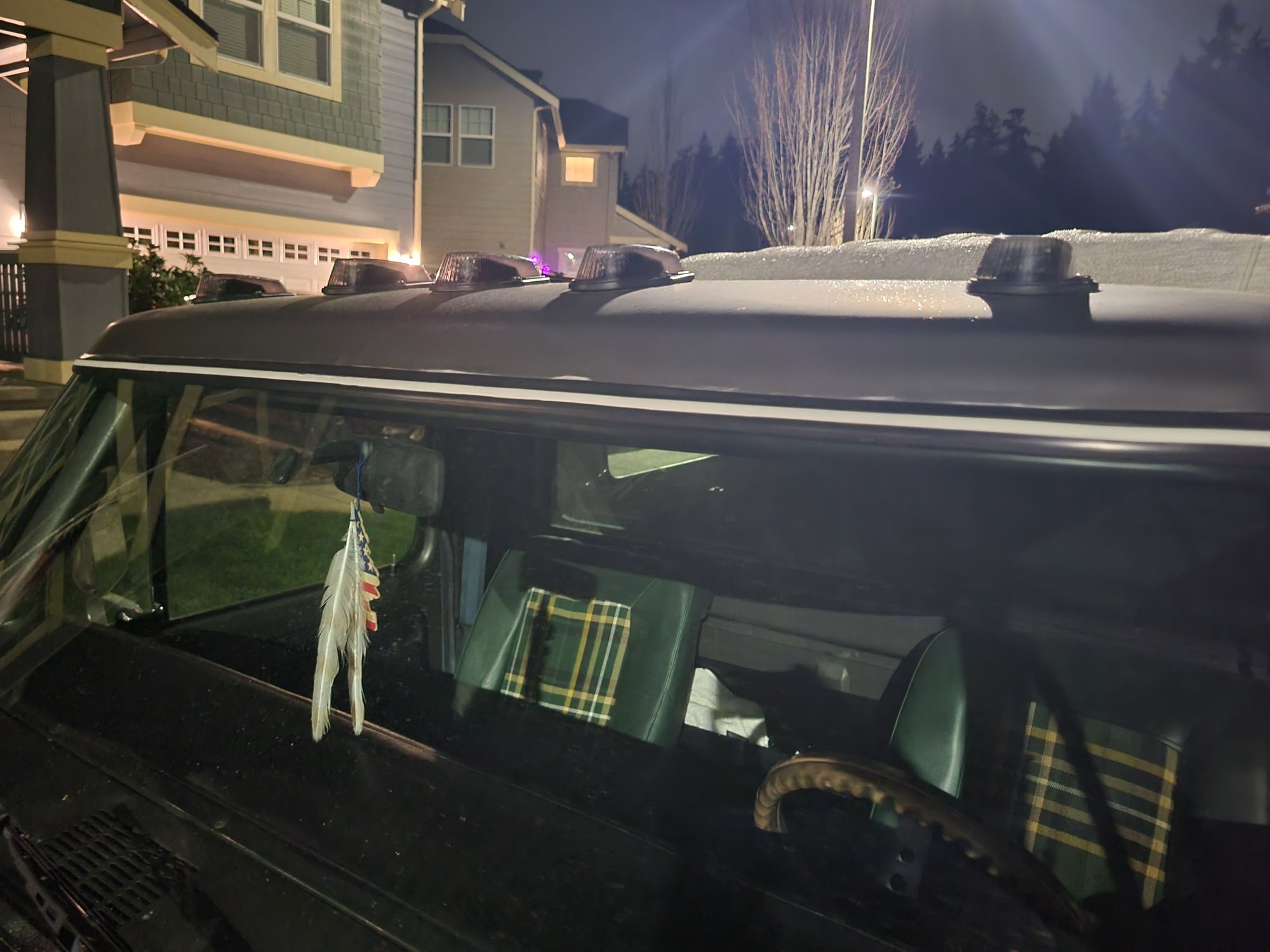

I have LED bulbs in these. They are replacement housings (Grote economy cab marker lights) of what I pulled off the truck.

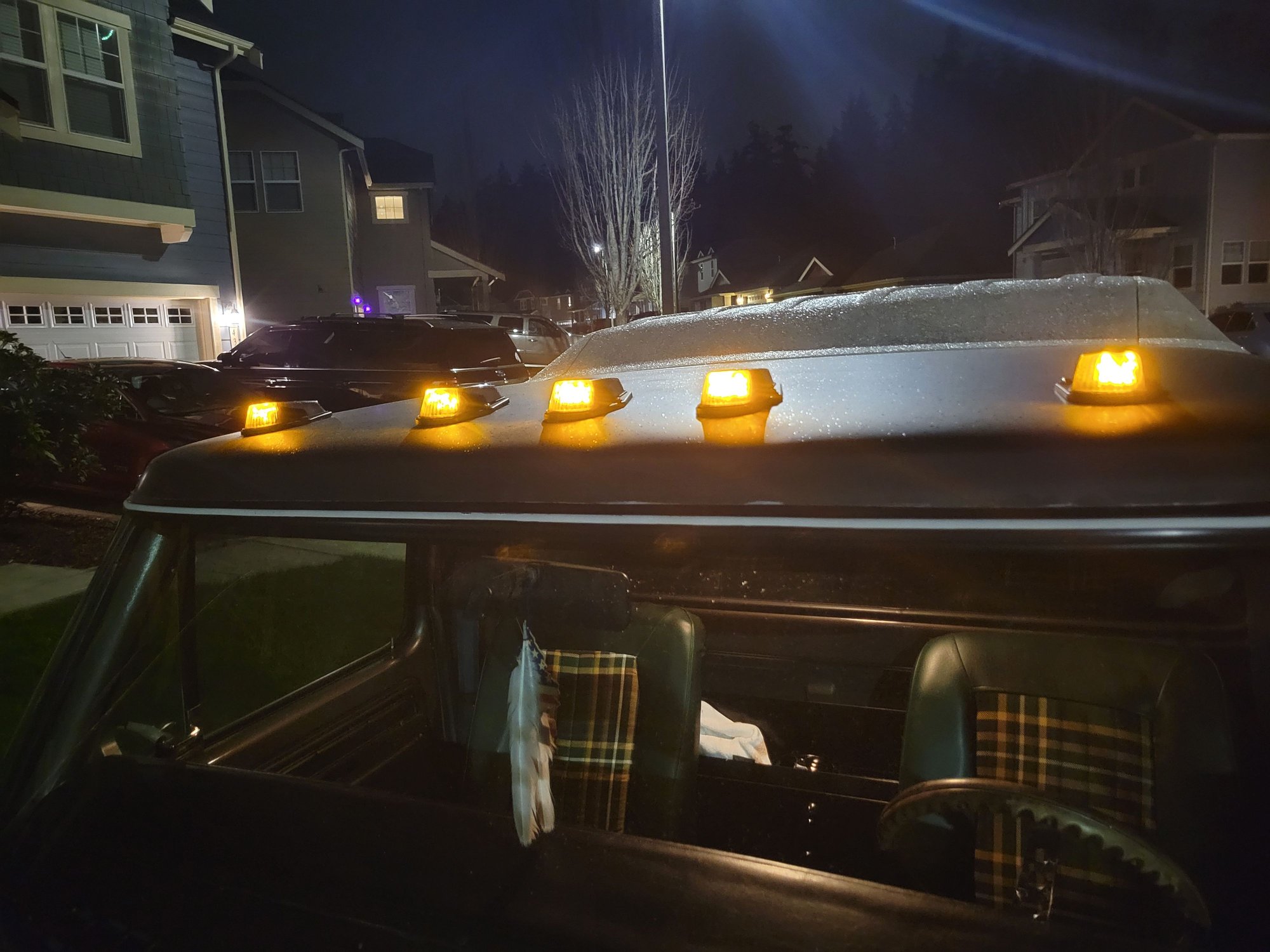

Old Apr 18, 2024 | 05:59 AM
Deadbuck's Avatar
Deadbuck
Joined: Apr 2018
Posts: 286
Likes: 40
the 2 lights on the right are led. Looks like crap and it’s a different yellow. You can see the led dots on the bulb. Hard to tell from the pics but it’s night and day
I will be switching the bulbs back to halogens.

FYI when you install LED's behind a colored lens the bulb needs to be the same color as the lens.
So yellow LED's in the cab roof lights, Red in the tail lights.
If you use white it washes out the color of the lens.
Dave ----
Old Apr 18, 2024 | 06:56 PM
Deadbuck's Avatar
Deadbuck
Joined: Apr 2018
Posts: 286
Likes: 40
Dave ----
yeah I thought about that, good point! I may see if I can get Amber ones Any idea on the bulb size? It doesn’t say on the bulbs
