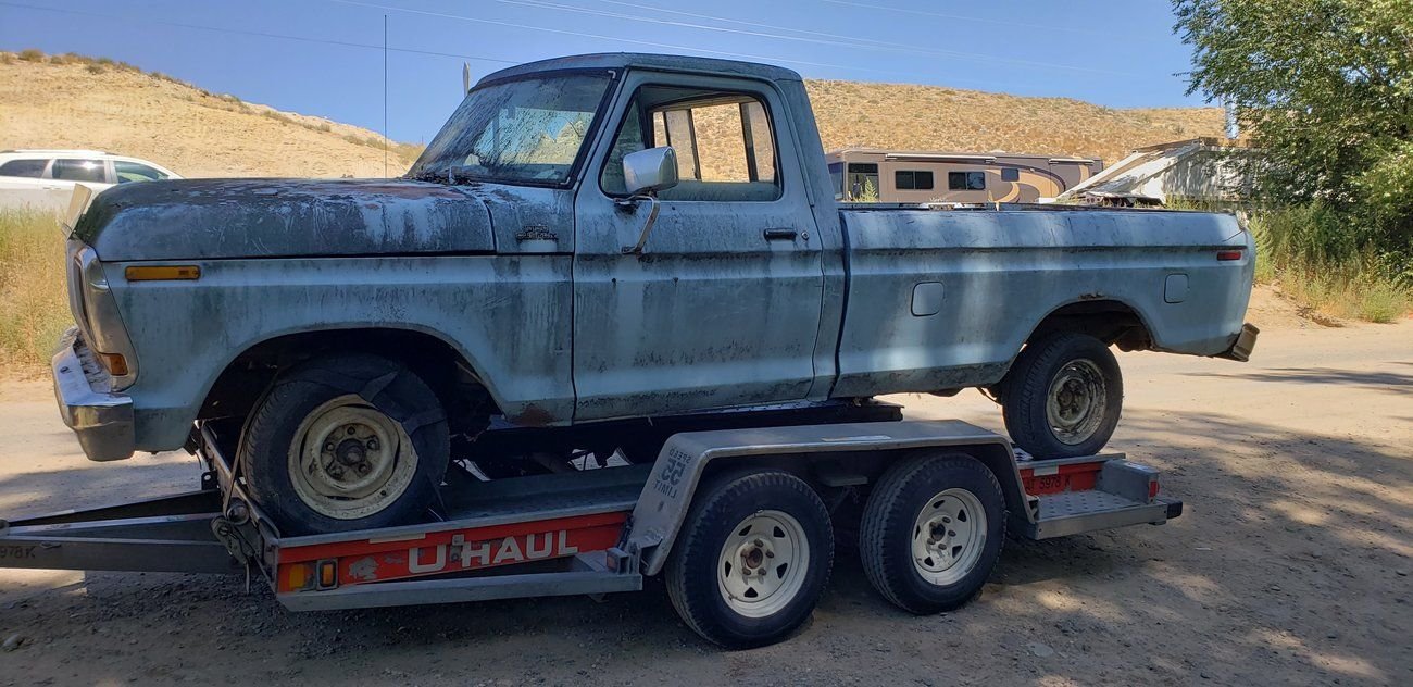

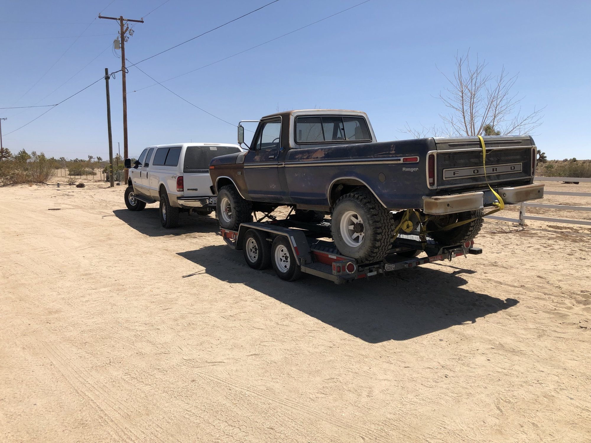

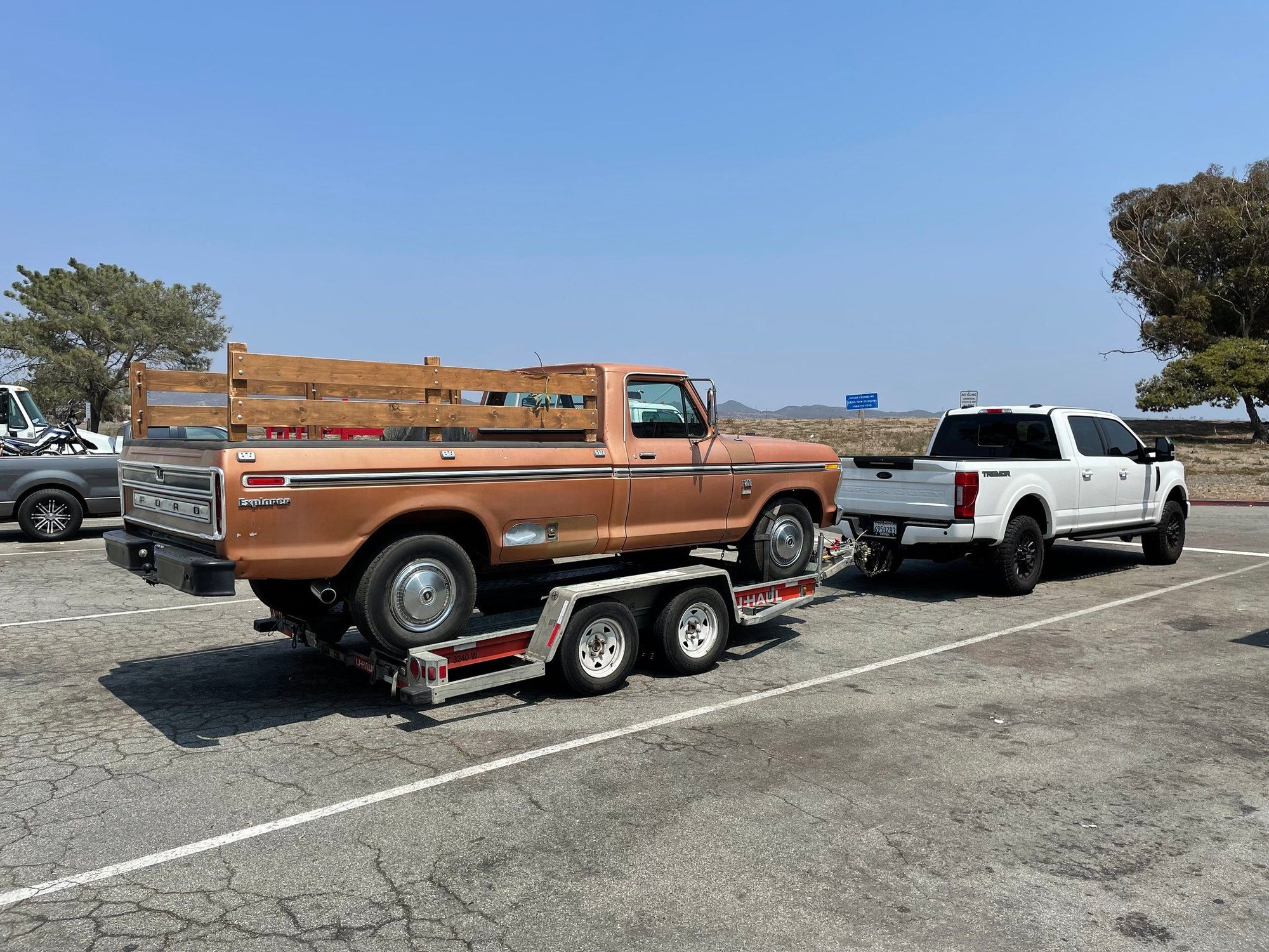

Reg cab F100, F150, F250, 2wd, 4wd fits, but you will want to have stock tires on it to get every inch of the trailer, you will need every inch of the trailer. Super Cab or Crew Cab no way. Strap the tires, the U haul trailer straps might not reach all the way around or it might be tight, so go prepared.
DO NOT STRAP THE FRAME, THE BUMPERS OR THE BODY. Strap the front tires and the rear axle only. Let the body bounce and do its thing.
Disclaimer: I am only posting these pics and did not tie down ANYTHING in these pics.
This truck maybe has 33x12.40x16.5's and it is tight to the end.
