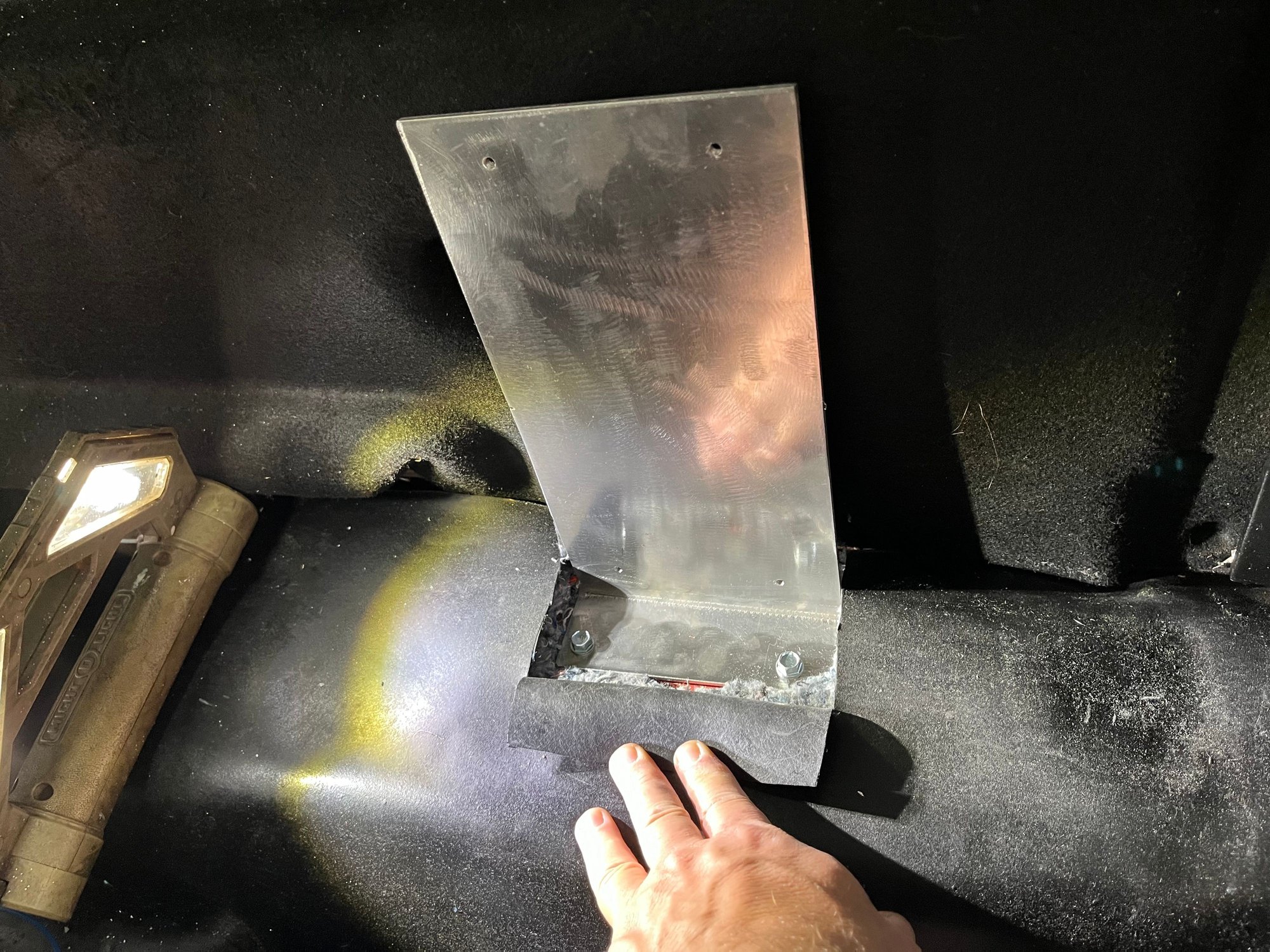

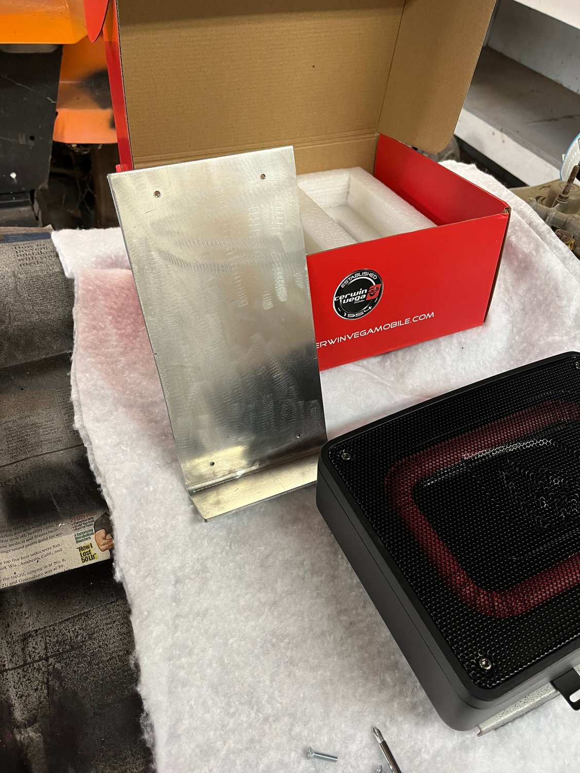

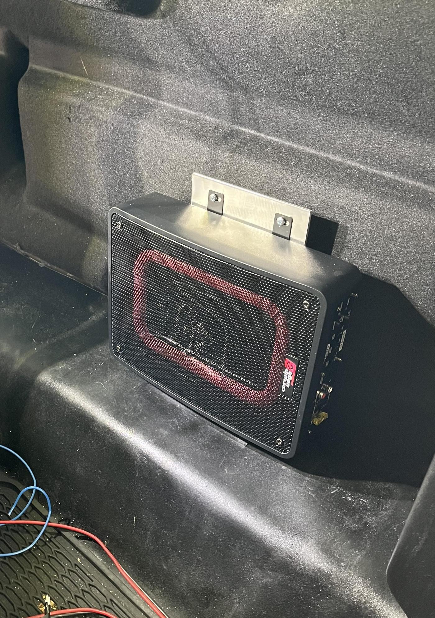

I did the 4th and final sound system upgrade yesterday; a powered subwoofer behind the seat. Nothing too big, just a 6x8 sub box made small enough to mount underseat in most cases - for me I thought a better fit was behind the seat.
Found some scrap 1/8 aluminum and cut a piece & bent a 90 degree angle on the end.
Cut a hole in the flooring & screwed it in place.
Tada! Ready to rock!

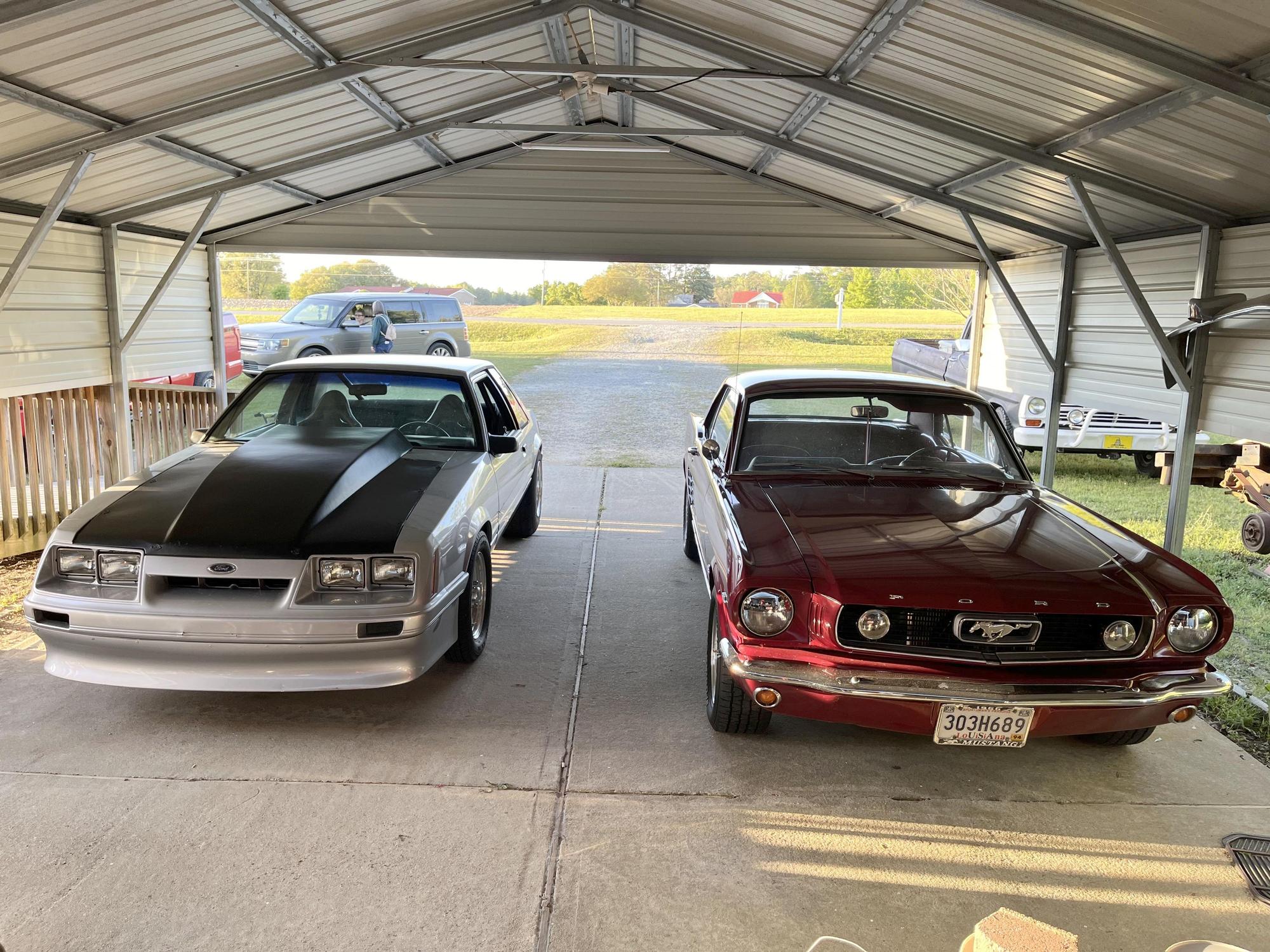

While I had both in the carport I grabbed my camera because I don't think I have any pics of them together.

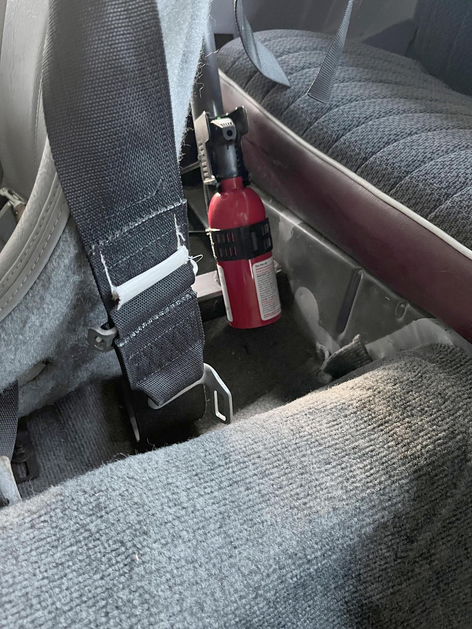

I had a fire extinguisher I have been wanting to put in, all my old vehicles have one except the drag car which is probably the one that needs it most. I just hadn't had the car out to work on it in a while so I took this chance to go ahead and install it. I put it on the roll-bar by the back seat where it is a really easy reach for someone in the drivers seat.

Ob the fire extinguisher is that one of them small size but has a normal charge in it?
Think it was Gary on the other Ford truck site posted a small fire extinguisher that had the same size charge of the larger ones that I was thinking of buying but were not cheap. Then again fire is never cheap either.
I do have one in the pickup behind the seat. Not as easy to get to as I would like but better than nothing.

As for the fire extinguisher, I don't know the answer to any of those questions! I will look at the box because I haven't tossed it yet. I just knew I wanted to put one in the 85 so when I was at Lowes I looked through and found one that said "automotive use" and chose it. Was not expensive, they were all around $30 (automotive, general purpose, and kitchen) except for the larger ones which were around $100.

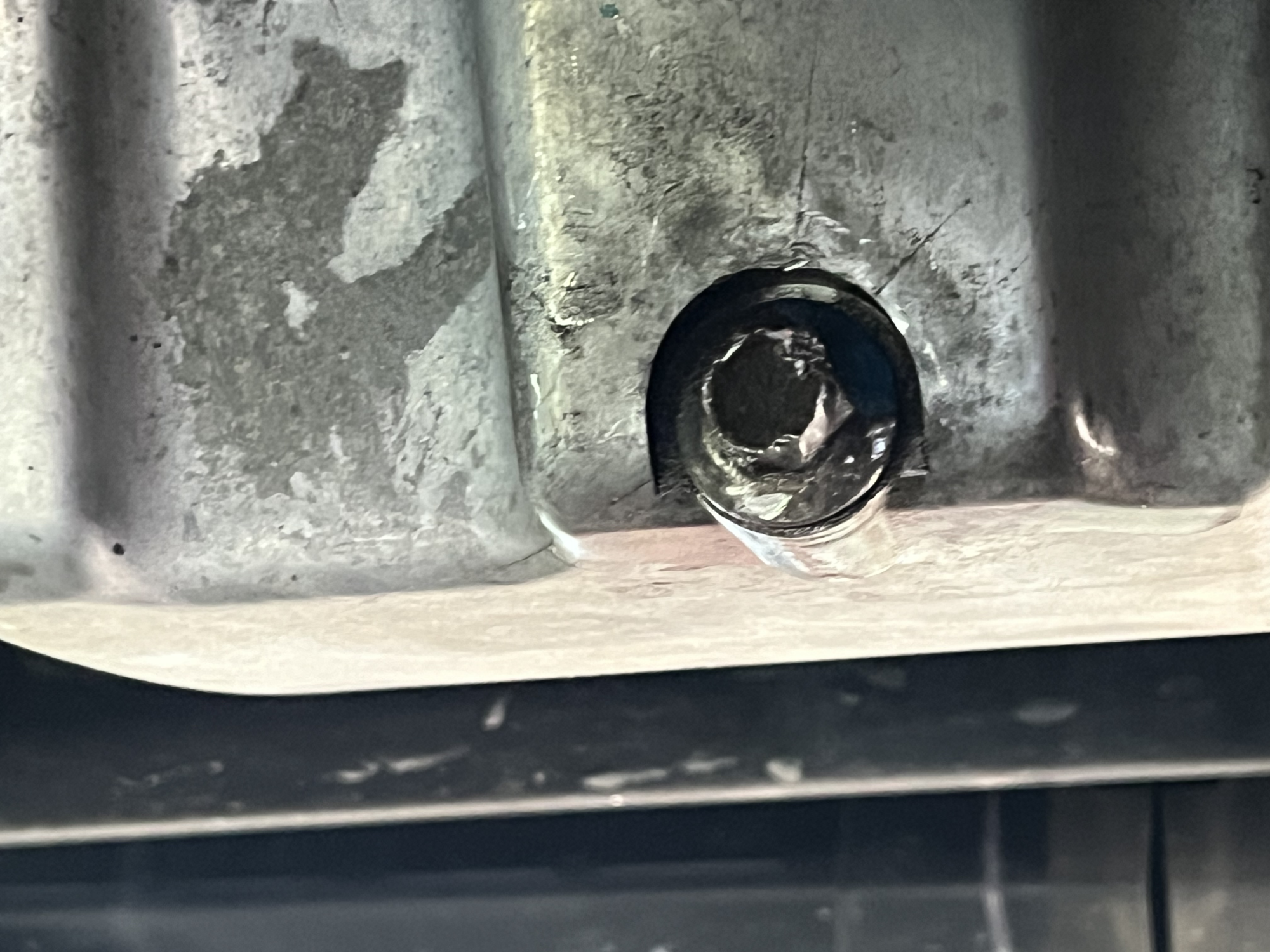

My son in law called me on the way home from the car show yesterday, he was at my house changing oil in my daughters vehicle. He said "how do you remove a stripped oil pan bolt?". Turned out he mean the head was rounded off. It was really in there tight, I said whoever changed oil last time but have put the bolt on using an ooga dooga! He rounded it off trying vice grips, so I escalated a notch and used a pipe wrench, and that still slipped off and made it worse. I toyed with the idea of welding a socket onto it, but I was really worried if I did that would it cause the oil inside the pan to catch fire. I asked for suggestions and Tony said he had an extractor set that he felt like would do the trick. That reminded me that I had a set out in the shop, I think this was the first time I ever used it. Hammered it on and used a cheater bar, and it gripped hard and the bolt finally moved. That was a huge relief!
Gnarly bolt head there. Autozone had a replacement that only cost 3 bucks.

Good to hear you got the drain plug out.
Dose the plug use a Allen wrench? If so I bet someone used a SAE and not Metric.
Welding a nut I dont think would cause a fire but that looks like and ALUM oil pan?
That pan is what I would worry about and welding.

Yes steel drain plug bolt in an aluminum pan. I was worried the threads might be seized or galled but it was just tight, once we got it to turn it came right out. It's a regular hex head, yes maybe someone (like my son-in-law?) used a SAE socket on it initially and started it rounding off. I was not there to make sure he got a 14mm instead of 9/16
