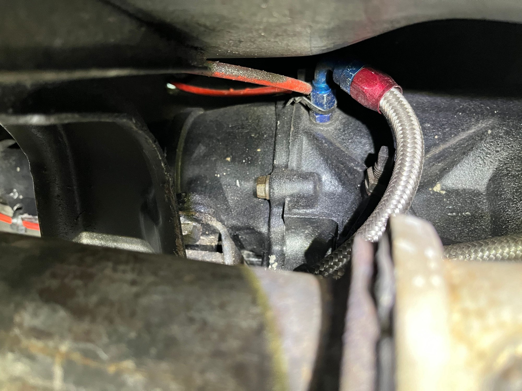

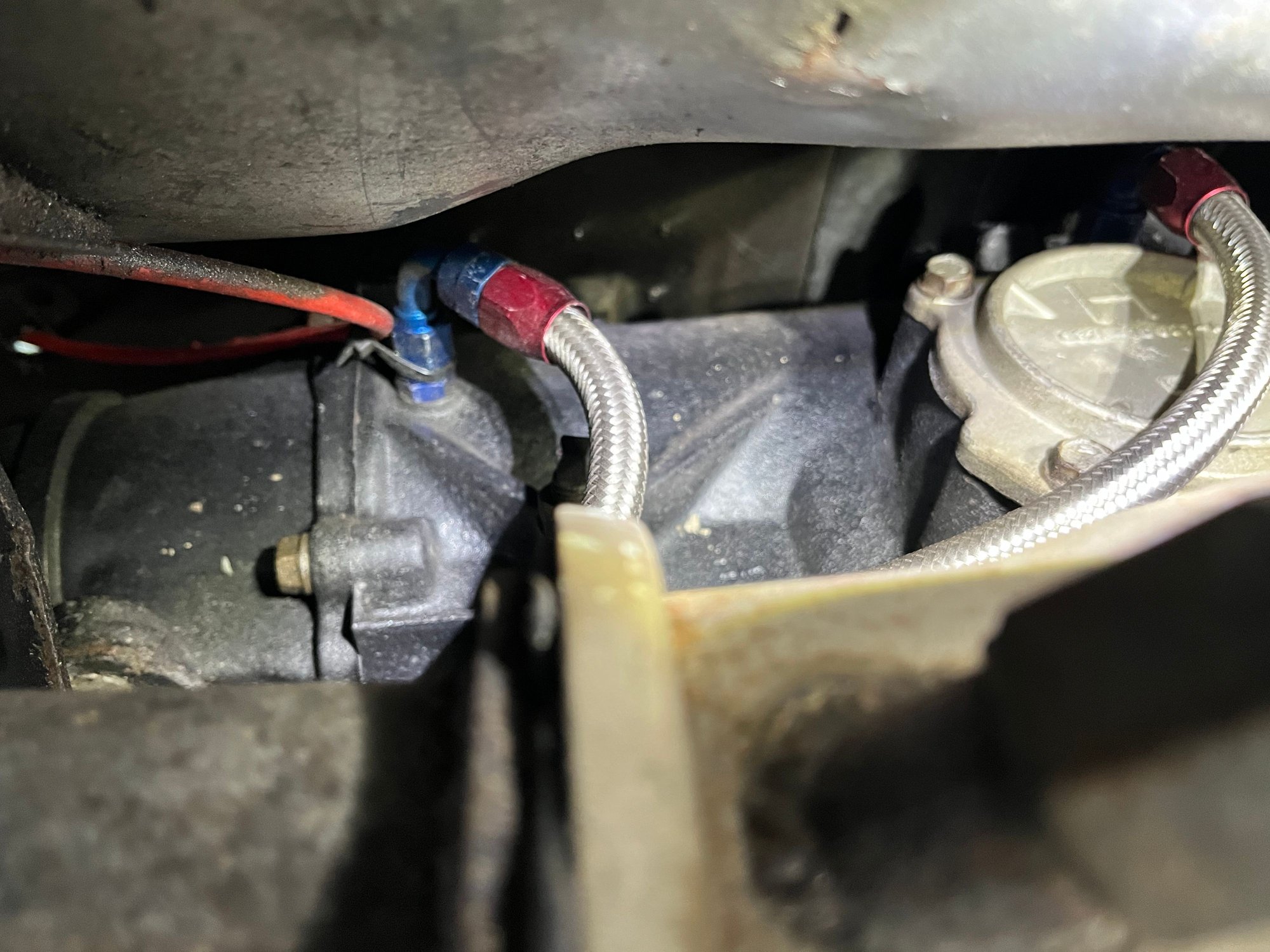

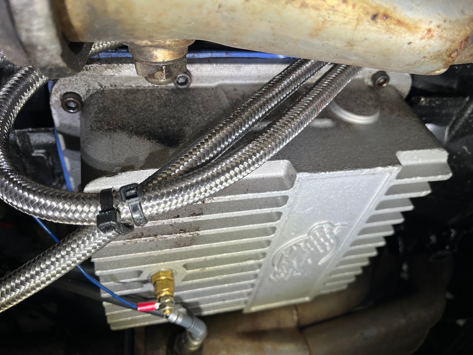

I jacked the 85 coupe up to see if I can find the trans leak, and kind of befuddled. The tranny lines are both 100% clean at the top where they connect to the transmission. They were coated in the tranny fluid lower where they curve to go towards the cooler, but the trans pan had some fluid on it too along the bottom. So it gives me the impression that it's leaking from somewhere above and getting onto the lines, but I could not see anywhere near there that showed signs of a leak.
I thought I'd check that the pan bolts are all snug, so I went around and gave them each a little crank. The only one that was more than 1/4 turn was all the way on the other side of the pan so I don't think that could be my problem. I hit it with a pressure washer after figuring the cleaner it is the easier it will be to see where it's coming from next time.
I can see my spray wand missed a few spots.
Trans lines are clean.
Hard to see much, but it's all clean and dry

Oil leaks can be a bear to find.
On my pick up it took me a long time to find the timing cover leaking at the top and spraying all over but only when the RPM was up then add the fan blowing it all over
Wonder how old that trany hoses are and what the inside is made of?
I had a fuel line leak as the hose inside broke down over time.
Did you recheck for a leak after you did the ALT fix and had the motor running?
Also haw bad dose it leak?

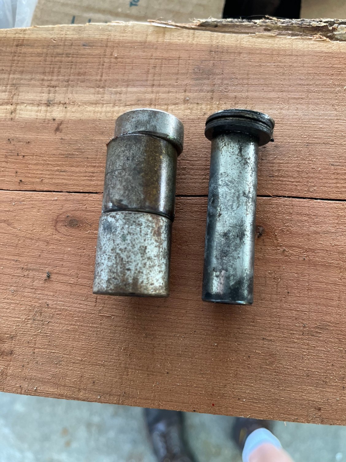

The things you find when you climb under the truck and look around!
The bendix in my starter was going bad, I think I think I was at your house once & you noticed I would only get 1/2 second of cranking before ZZZzzzzzzz. It might take 10 tries to get enough crank to actually fire up, so I decided to go ahead and get a new one.

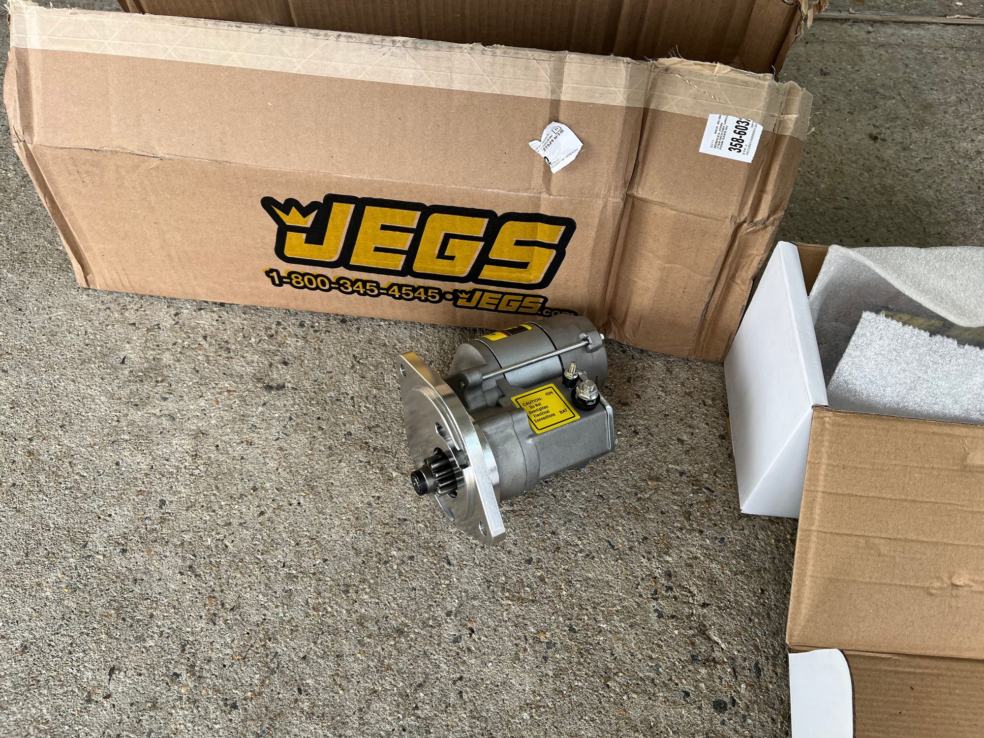

Hi-torque mini-starter from JEGS.
Looks great and works great, except now that gear reduction makes my F100 sounds like a Chrysler when I hit the key.
I put off doing this job for months because I thought it was gonna be a bear, but you know what. Access was easy and I got the whole job done in 15 minutes!

I see you did not wire it the way I would have done it.
I dont like using the little red jumper wire because the starter can back feed and keep it engauged.
Leave the large cable on the large stud and remove that red wire.
Up at the factory solenoid move the cable that goes to the starter over to the same stud that battery cable is on.Yes that cable to the starter is not hot all the time but so are the cables on GM cars & trucks.
Now run a 10 ga wire from the solenoid large stud the cable came off of and run it down to the small stud the red wire was on and you are done.
The factory solenoid now only has a light load to send power to the starter solenoid and will not weld its self closed.
My drag car also had a gear reduction starter with a solenoid and the people I bought it from that is how they wanted it wired.
Yes the AMC has the same starter wiring set up like the Ford.

What you described is how they said I should wire up a later model Ford starter if I had gotten one (I forget which, but some are factory version of gear reduction that can be used on an older motor like mine), but when I got this one from JEGS, the wiring instructions inside the box said to wire it this way just jumpered over.

You can wire it the way I said also and "I" would have done it if it was mine but if it works as is then leave it.
