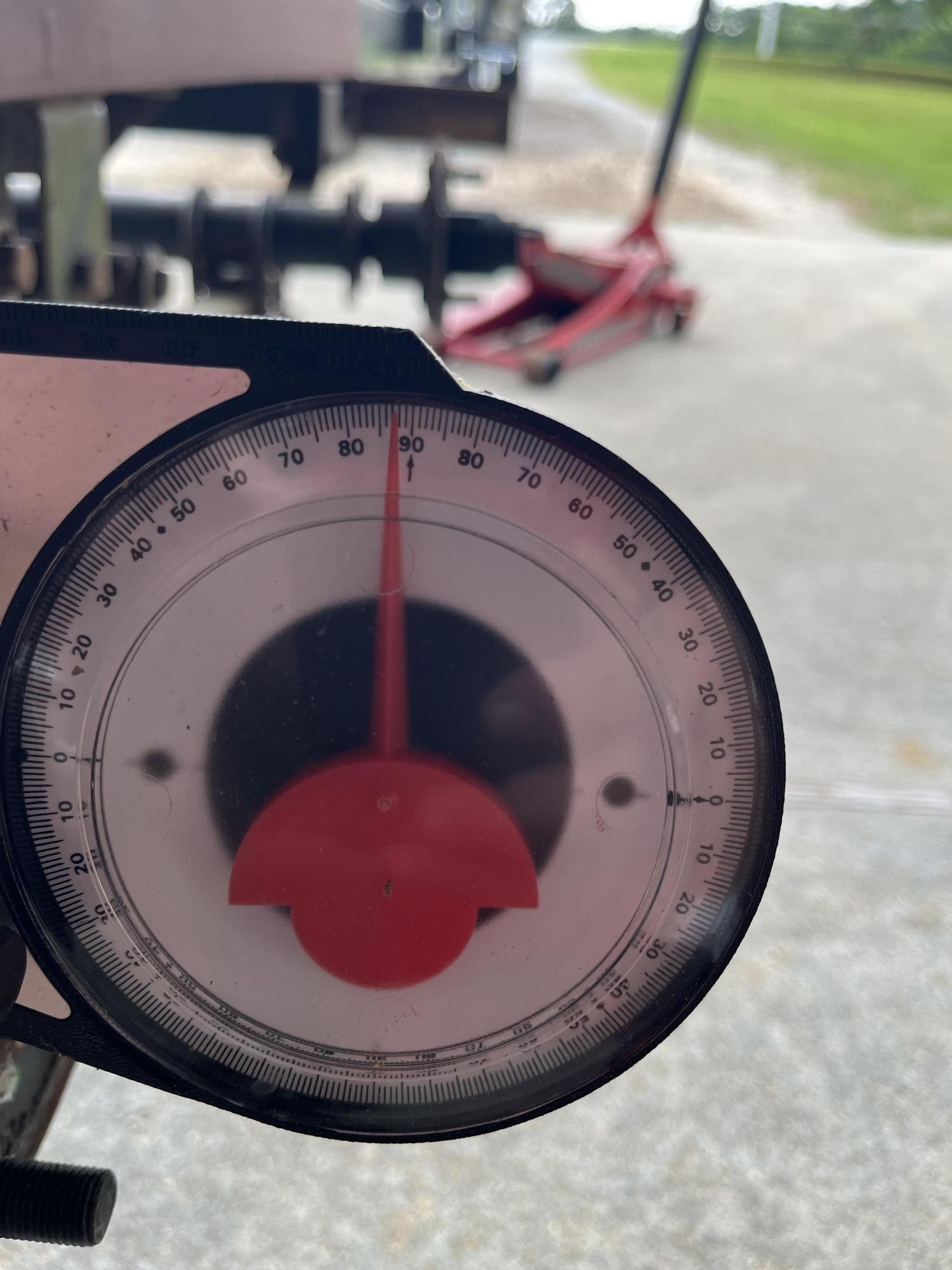

The negative camber from that front tire has always annoyed me. It came from being overloaded, you can see the slight upwards bend in the second pic.
I had my trusty old dial gauge handy, so I put it on the hub face of both wheels to see what I was dealing with.
Front shows 2 degrees negative camber. That is leaned in 5 degrees more than the rear tire.
The rear tire shows 3 degrees positive camber, which is what you would expect from a trailer axle. It should go to 0 when it's loaded.
I read lots of internet suggestions about home DIY fixes and this one seemed like the best option for me. Cut the axle shaft halfway through, use a BFH to pound on it and bend it where it needs to be, then weld up the cut.
One more pass to get any spots I missed and it will be ready to go.
Afterwards, I have 0 degrees. I probably should have gone a little more, but it's better than it was.

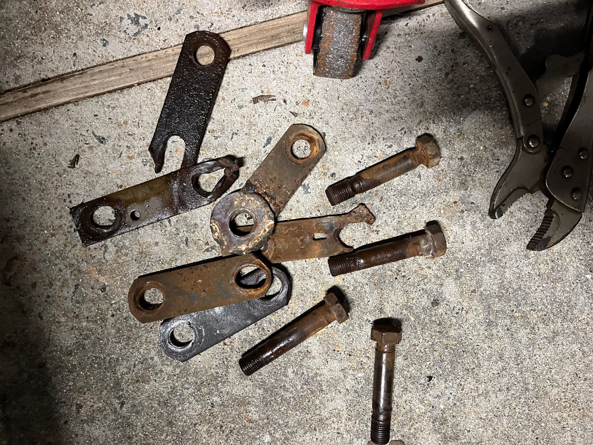

I figured this might be a good time to tackle some of the suspension as well. I had previously bought a box of 9/16 grade 8 bolts & lock nuts for this, as well as new shackle brackets, so it was just a matter of spending about 15 minutes per bolt getting them off. Propane torch, WD40, breaker bar, lots of sweating and achy back.
The old stuff was badly worn and damaged.
Looks a lot better and safer. But I only got one side done and needed to clear out the carport so my wife could park inside, due to the storm that was scheduled to come through.
I didn't think about earlier, but I needed new bushing as well. I have ordered a set and when they come in I'll do the suspension on the other side, then I will also redo this side, but I'm sure it will be a lot easier since the bolts are new and not seized.

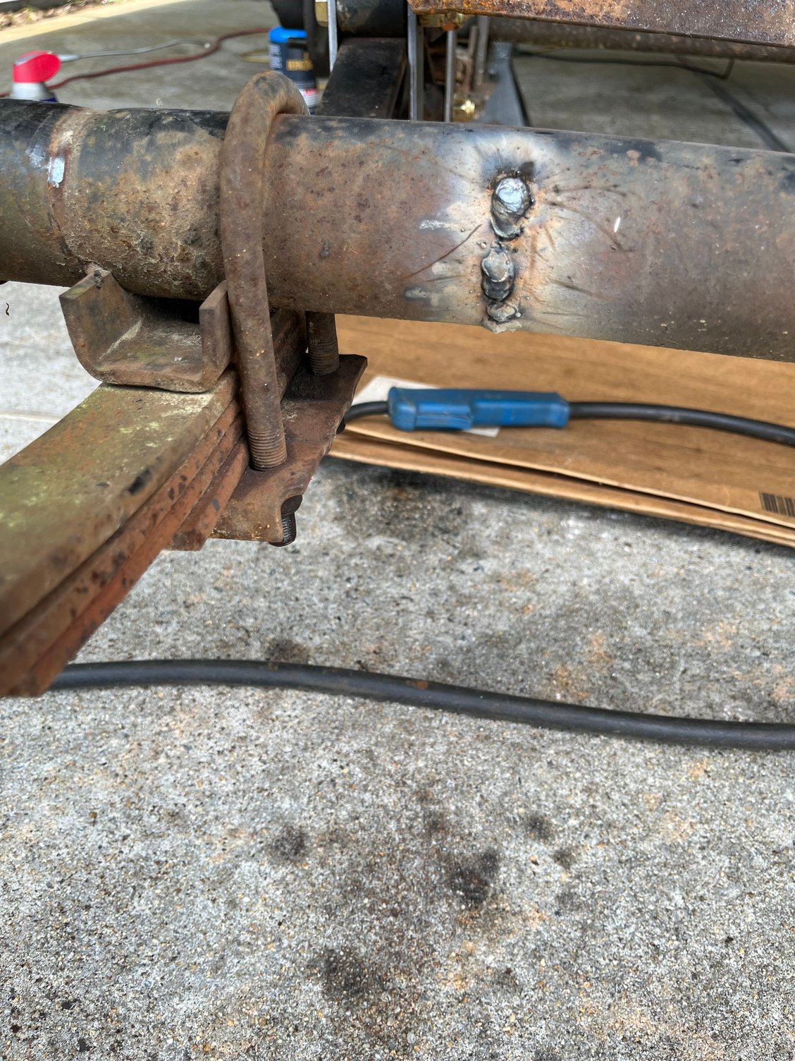

I didn't think of using the bottle jack to bend the axle, in my head I'm trying to think how I would position it and hold it place and I am not sure if it would have worked for this. But since the gears in your head are spinning, do you have any ideas or suggestions for how to raise the frame UP here at this point, it's been bent down around 3/4 of an inch.
I can fit my entire finger underneath.
I did the new bolts, nuts, and shackle brackets on the left side today. Same as the other, badly worn and cracks and in one case, 2 thin axle brackets sandwiched together instead of one good size thick one. But it's all replaced now! And of course has to come apart again when the bushings get here, but I think it will only take 15 minutes per side instead of 15 minutes per bolt.

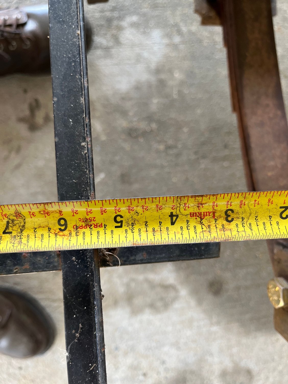

The only wheel with noticeable toe issues was the left side rear, it has a definite "toe in". It was really obvious when I had the wider tire on it because it would rub the frame in the front but have 1/2 inch of clearance in the back. I made my own high tech toe measuring device. A piece of small angle iron clamped onto the hub surface.
Front measurement 5-1/4
Rear measurement almost 5-1/2
I followed the same process as I had used on the other side. I cut halfway through the axle tube on the back half. This part is a little sketch. I put a come-along from the tongue to the axle and cranked it until I couldn't move it anymore. Then I got my BFH and pounded it until it moved a little. Took a lot of effort!
Afterwards, front measurement is almost 5-3/8
And the rear measurement is between 5-1/4 and 5-3/8
