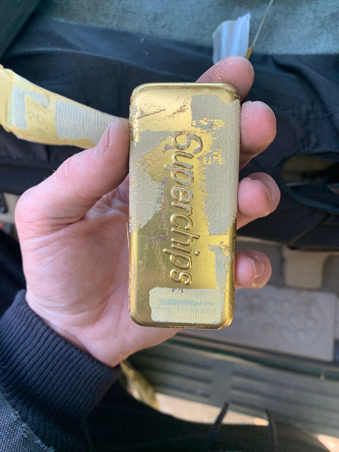

I need some help before I go to a shop, I’ve got a 2000 f350 SD 7.3 with 169,000 on her. She runs great, lately I started having issues acting like she’s starving for fuel. Replaced the fuel pump, filter, etc. no fix so I’m running it on my auxiliary tank and no issues (separate system) but when I cut the truck off when it’s hot my lift pump won’t turn on which causes a no start. (Either fuel system) I replaced my CPS, fuel pump relay, removed my chip from the ECU and today she died while I was driving. Still having issues with no start. I need help, I don’t think it’s the HPOP cause I don’t see any leaks. My IPR isn’t full of oil. Anyone know of anything? Using all motor craft parts and filters
This is the chip I removed (60 HP, 110 ft. Lb)

Have you checked your fuel pressure? Or just loaded up the old parts canon and started firing away?
Factory- you only have one fuel pump, there is no lift pump and HP pump or like.
Just a good old frame mounted Bosch fuel pump.
I would suspect you have plugged screens in the tank as you said the truck ran fine when you switched to your "aux" fuel system. No idea what that is so hard to help there.
I think you are confusing your IPR with your ICP sensor.
