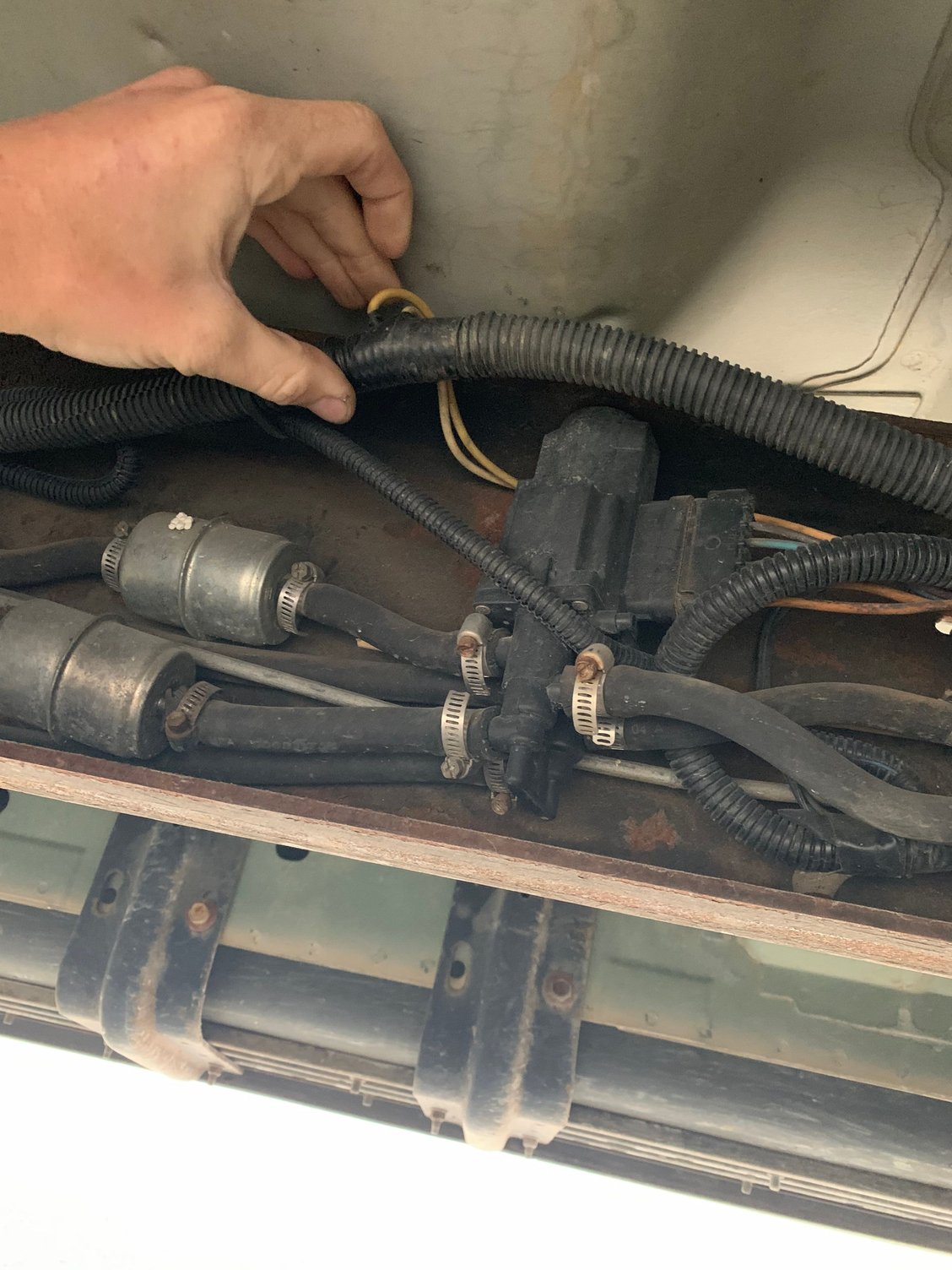

does this look stock?
That looks like a fuel tank switch? Do you have dual tanks?
Old Apr 9, 2024 | 09:41 AM
Gaugepro's Avatar
Gaugepro
Joined: Aug 2014
Posts: 521
Likes: 16
And to be clear, no, that is not factory.

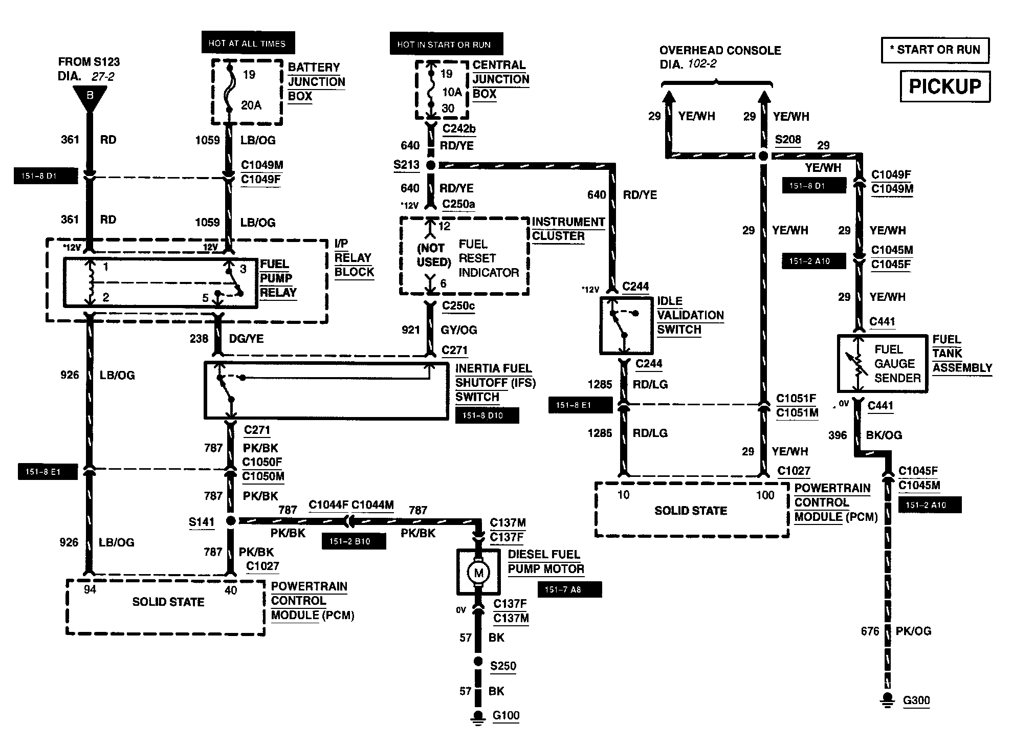

Does anyone have a wiring diagram for this?

You said the aux tank has its on fuel pump and you can switch between them? Is that just a small pump that transfers fuel to the factory tank or is there actually 2 stock style fuel pumps and the power changes between them? It's honestly just a guessing game until somebody knows exactly how the system is that is on the truck and how it works.

I was wrong, they both use the same fuel pump
Old Apr 9, 2024 | 12:46 PM
  #29
jcorley30's Avatar
jcorley30
Trailering
Joined: Apr 2024
Posts: 21
It’s 2 separate tanks with a switch on my dash, but I’m guessing the switch just controls which tank to pull from by this tank selector

Ok so then it definitely sounds like a electrical issue on the truck side since the pump is losing power. I posted diagrams so you can get it to where there is no power at the pump and then trace it back and try to find out where it's losing power at along the way.
