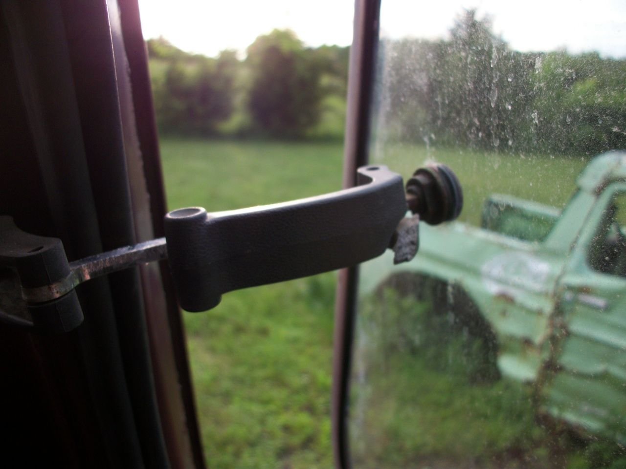

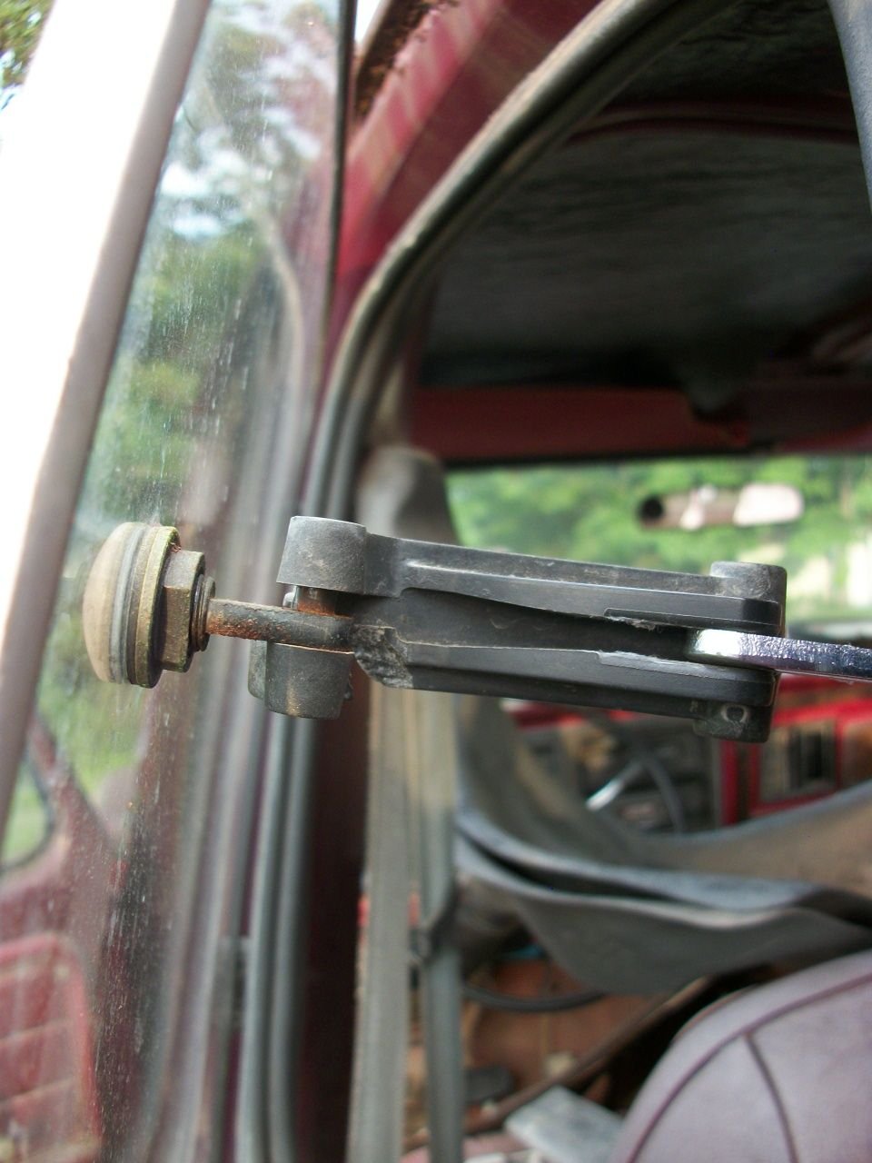

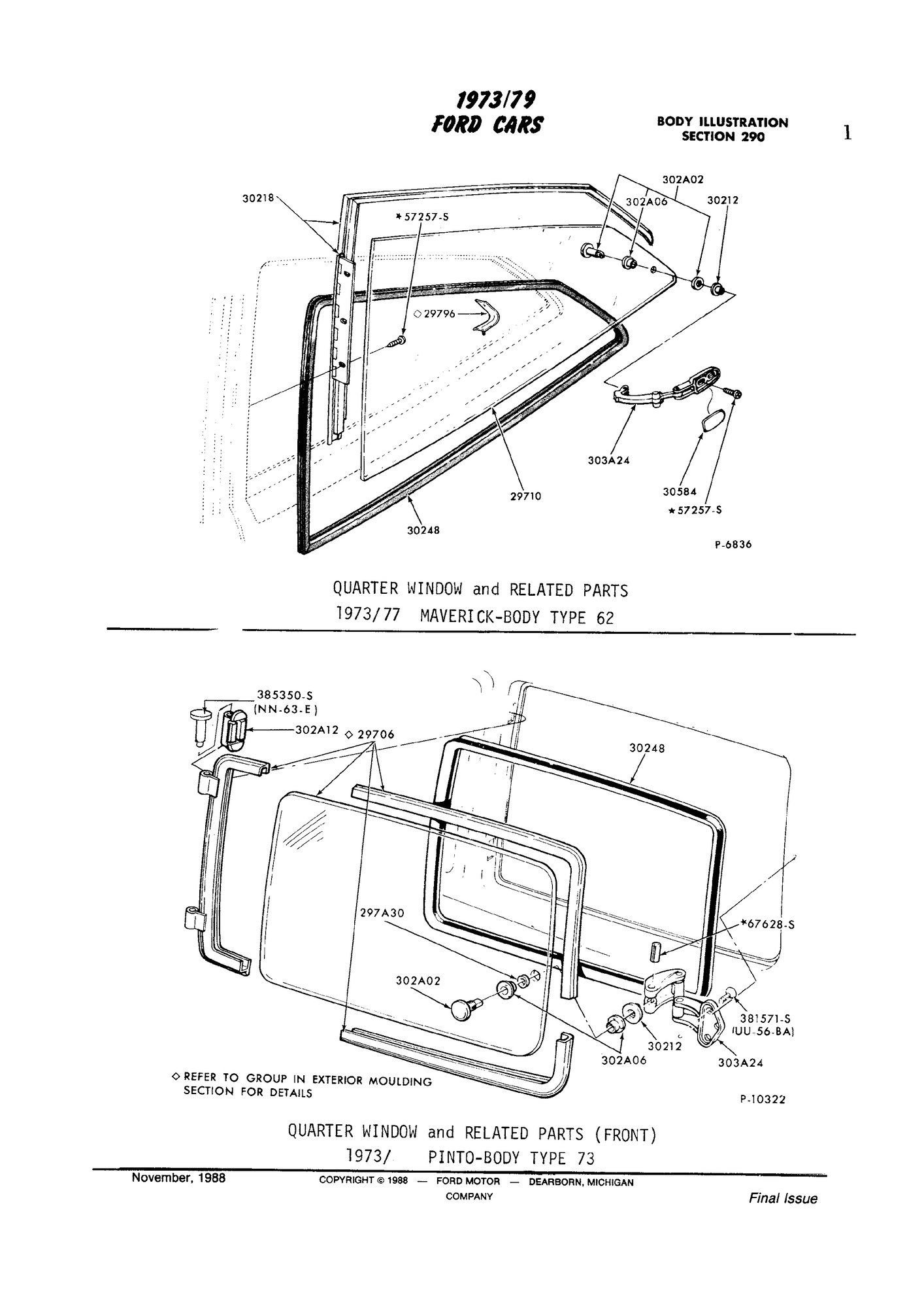

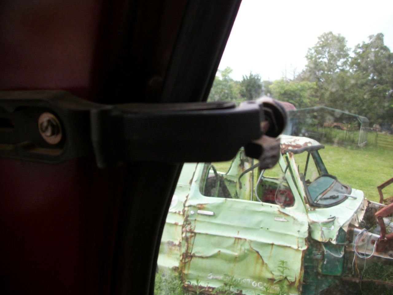

When we talked earlier, I said I had an alternate source for the latches...73-77 Maverick and here is a SC glass diagram also.
You know I also said that latch can be brittle. And this sort of shows how the outer latch anchor comes apart. And out of the body.
