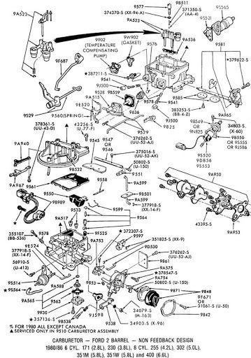

The 2100 is probably one of the easiest to do, don't cut yourself short... I've done a few, and I still put a white towel on my workbench, as I take it apart I lay it out, once all apart, I clean, then reverse the process...
I literally just did one off a 66 F250/352 a week or so ago, and I got interrupted in the process which usually screws me up. Had to look at the parts blowup just to confirm I was right.
Try getting a rebuild kit, lay out a white towel, do it all in one setting without interruptions and I'll bet you'll get it right! On the idle mixture screws, when I take them out and jot down how many turns, once clean and putting back together, I seat them and back out 1 and 1/2 turns as a base setting and that is usually very close to when you tune with a vac gauge.
