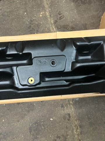

Bought running boards off ebay for my 2024 f-250. Most of the metal inserts (female threads) are missing. The guy I bought them from said he sells a lot this way and no complaints. The description said no hardware which i took to mean the bolts. Any ideas on how to get my hands on some inserts and how to make them stick?

Thread certs is what you need. Also called rivet nuts..
https://www.harborfreight.com/45-pie...7&gad_source=1
