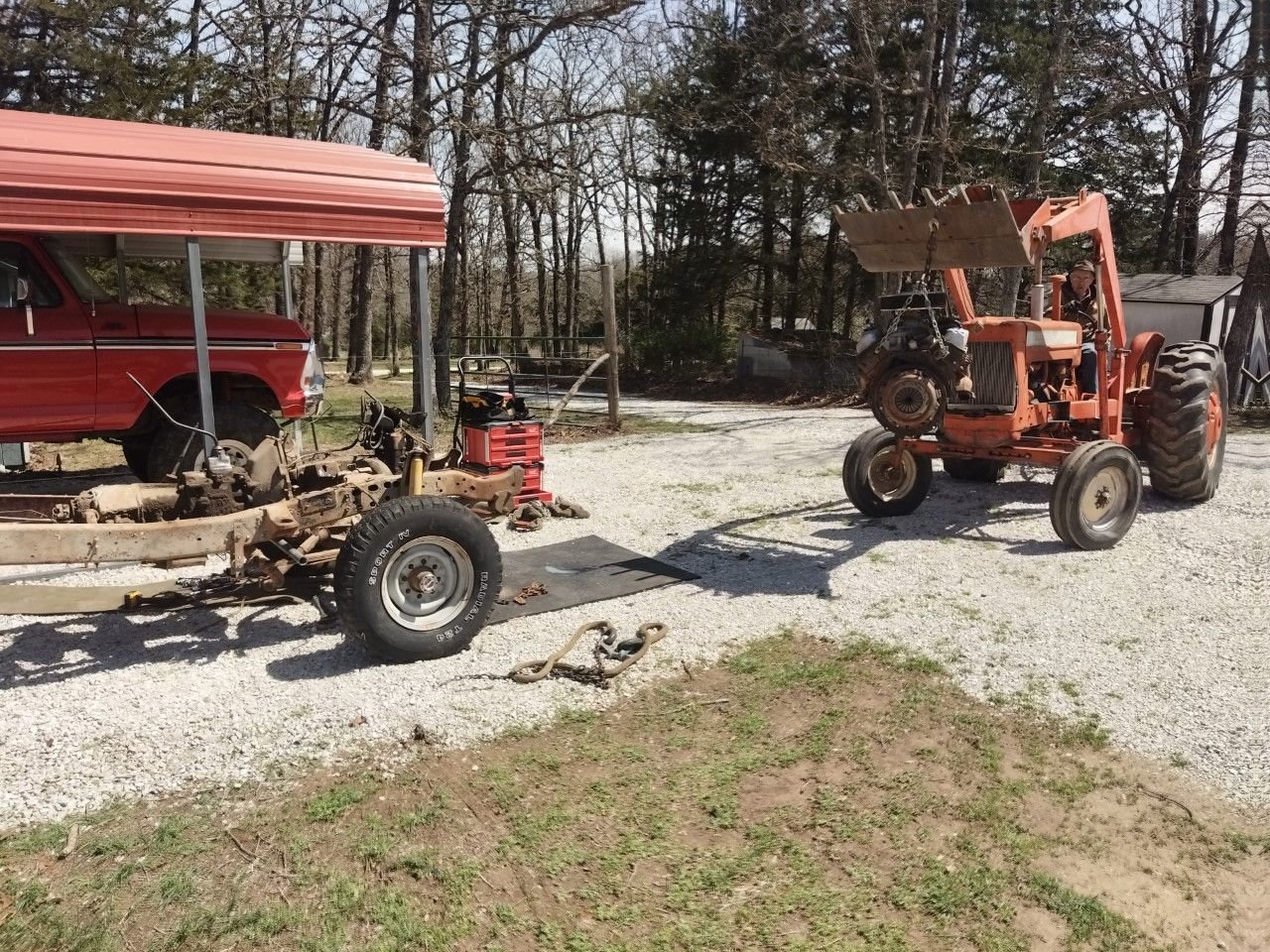

In the mid west I can buy a 78/79 F250 complete useable Dana 44 axle for three to five hundred bucks. I can buy a complete 4wd F250 parts truck for eight hundred to 1K. Yes the body is probably rusty, it probably does not run, but I am really only buying it for the 4wd running gear and parts.

My last 4wd F250 parts truck that was cheap enough that the frame/running gear (Dana 44/60), 4spd/NP-205 xfer all case went to Tx for a 2wd to 4wd swap.
